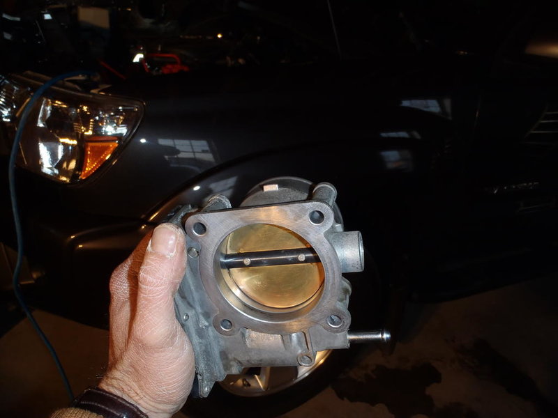

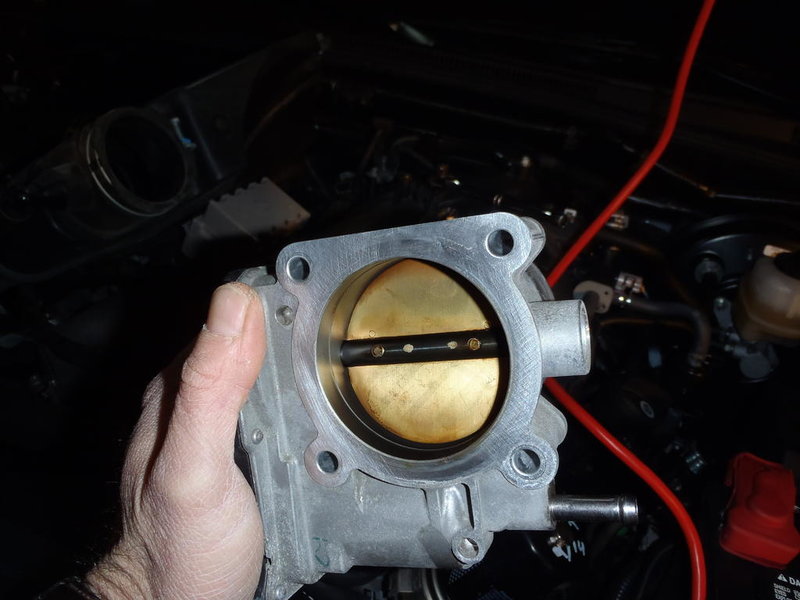

    I just did mine tonight. I completely took out the MAF and T-Body for it's douching.
    I took it for a 10 minute ride and I can see a small improvement in power. My average MPG before cleaning is 19.8 to 20.1 on the UltraGauge.
    I'm curious to see the improvement. BTW, the T-Body wasn't very diry.
    Before and after pics.....

    How many miles on that TB ? Thanks.

    35K

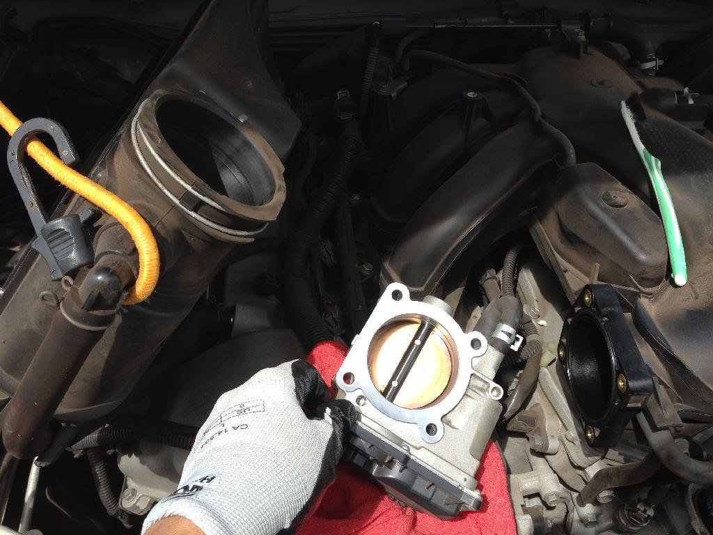

    Did mine today, at 51.9K miles on the ODO. Thanks for this write up, made it easy.
