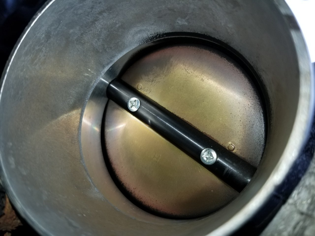

    Huh, 100k and decided to clean this for the first time.. guess im not gonna bother scrubbing it.. ill just spray it a bit since im in here. MAF sensor was spotless too.20180603_134822.jpg

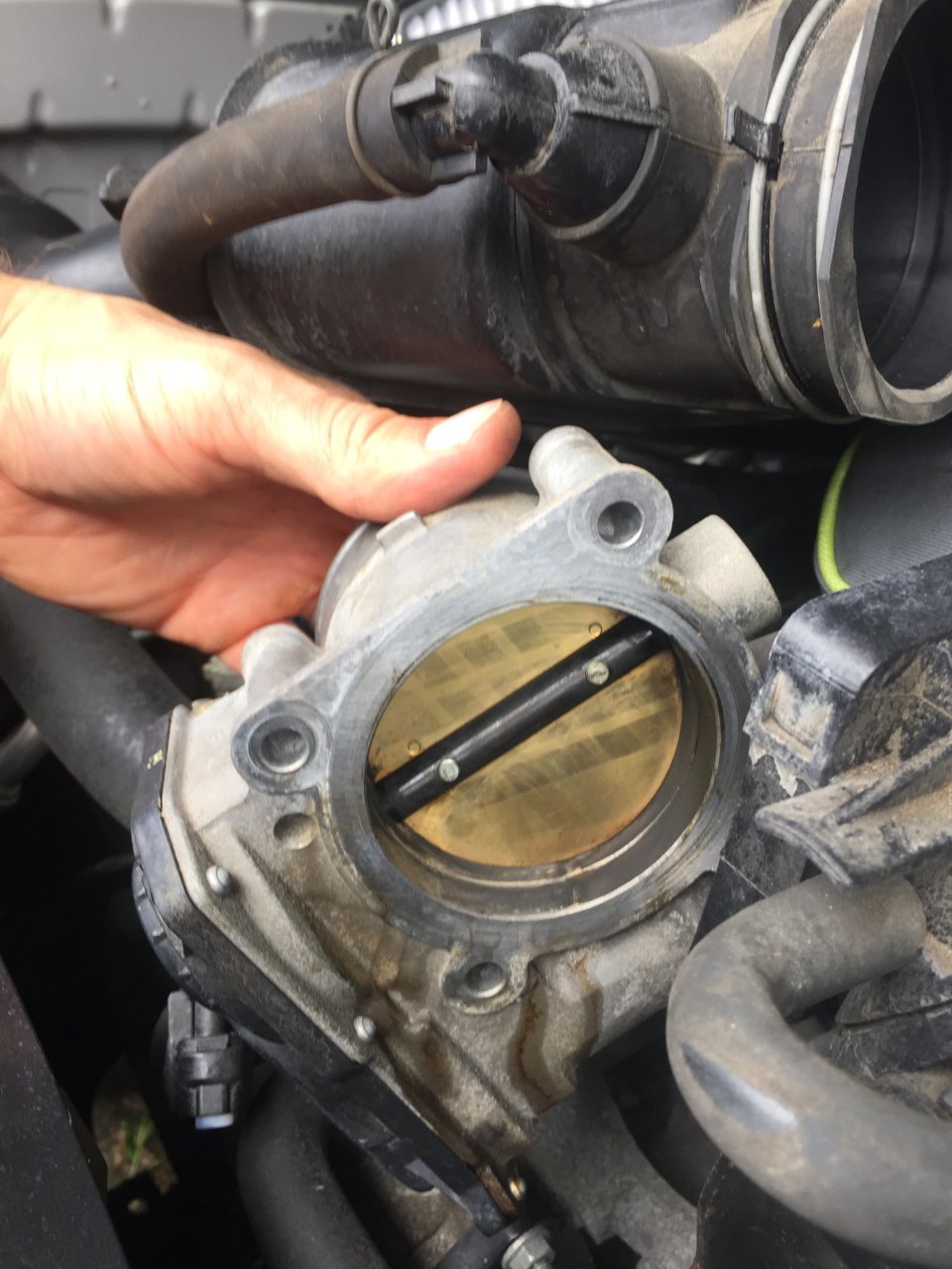

    So I just did both today bc why not. Truck has 41k. My throttle body looked as good if not better than this one. I decided why not scrub it with a toothbrush anyway. Holy crap I couldn’t believe the black gunk that I took off! Black gunk dripped a little and toothbrush turned totally black. Glad I did it and will prob do it at 15k intervals since it’s so fast and easy (and cheap) great thread OP

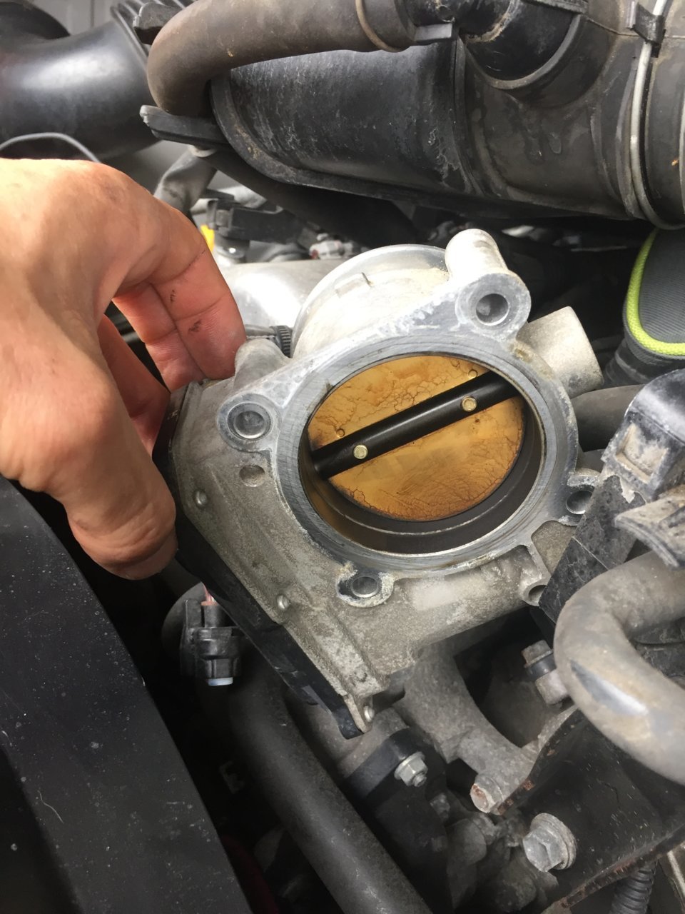

    Thanks, OP! Before and after cleaning after 127k miles.
