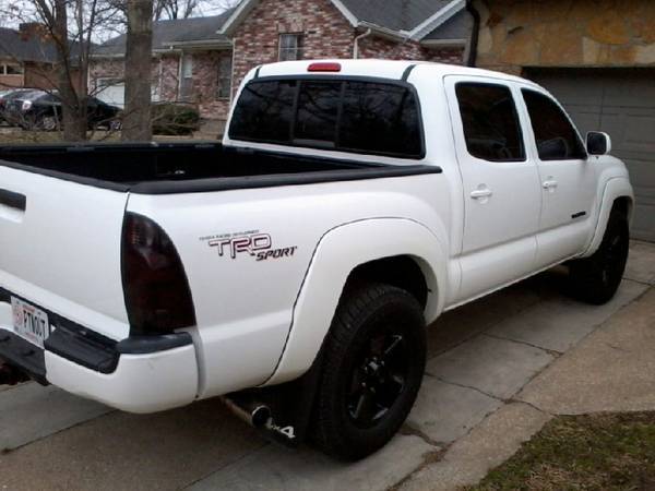

    Did this mod today. Love it!

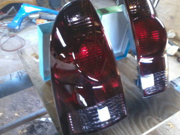

    I done mine the other day.. It needs more clear but im gonna get a buddy to do it with his paint gun.

    They came out great guys

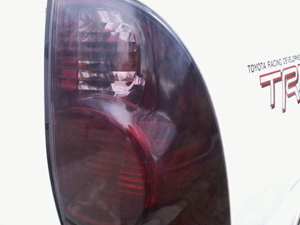

    I tried this mod today and I'm not totally satisfied with the results.
    The VHT came out all speckled. I held the nozzle ~6-8 inches from the surface. Maybe I went to fast?
    I thought it might look better when finished, but it doesn't. I'm going to sand it down tomorrow and start over.

    Happened to me also. I held the can closer for a more uniform coverage.

    It seems like it will then get much too dark.
    I'll give it a try this evening. Thanks.

    It will so just to less coats. I think i did 3.

    The night shades will look speckeled. Thats normal. After several coats of clear, it will level out some. The key, is wet sanding the clear with 2000 grit and then buffing it with a good automobile buffer. Then it should look smooth as glass.

    I think youre talking about the orange peel effect, but Im sure he is talking about actual specs of nite shades being dark little dots.

    Yes. I am talking about the nightshade being speckled.
    I'm getting ready to spray it right now.
    Removing 10 layers of clearcoat + nightshade proved tiring. :eek:
