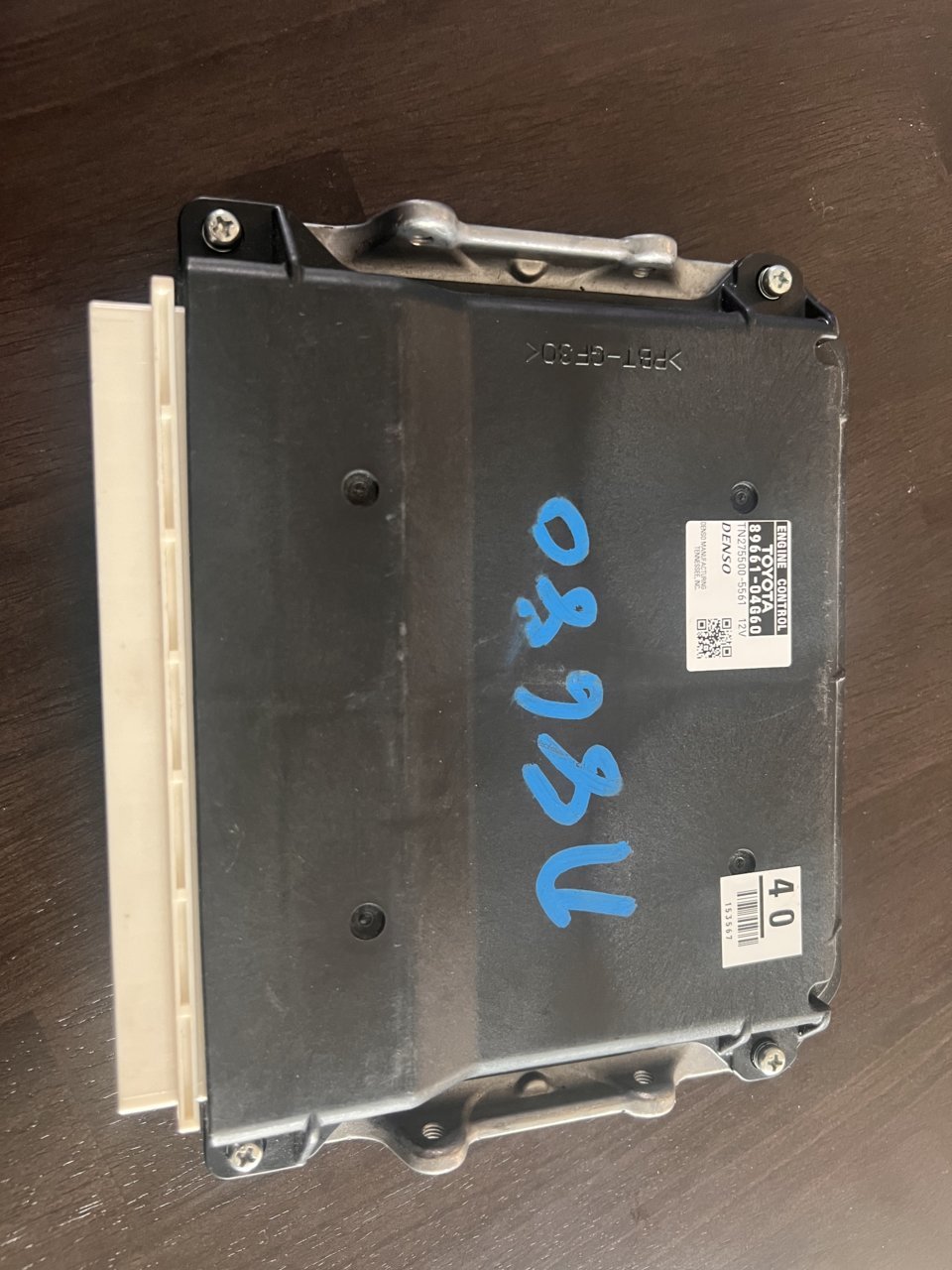

    Hi all, garage clean out time.
    I have an ECU from my 2014 sport that is already tuned, all you need is to hit up @JustDSM to put your VIN on it and it is ready to go, or you can have him tweak the tune for your own specific preference.
    This makes upgrading easy since you don’t have any downtime while you wait for him to program it, all you have to do is switch ECUs when you get it back.
    $300
