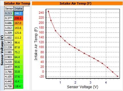

    Are you looking for resistance or voltage for the IAT?

    I need to know the Voltage/Temperature correlation. There's a table that isn't currently defined in the Tacoma ECU. I have the data for the Tundra (as it's defined in their cal).

    Do you think it's linear and do you think it's 1:1 with measured values at the sensor? We could bench test one rather quickly and establish a few data points?

    Generally they're not quite 1:1. Though we could define the curve with some simple measurements at various data points. Here's one from a Mazda (off the cuff google search) to give you an idea of what we're looking at.

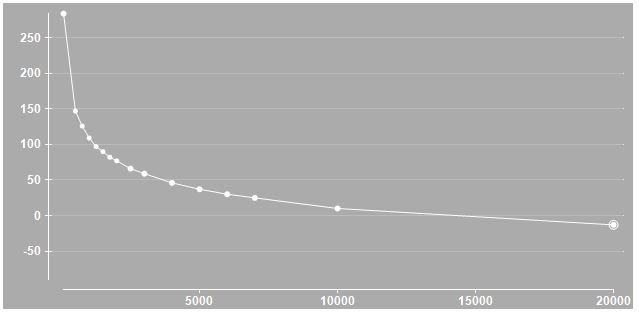

    Ok, I was able to make a Resistance/Temp calibration by putting a variable resistance box on the wires and seeing what temp Techstream was reporting per resistance for my tune, was going to contribute
    Could have been smoother at the ends but was virtually no change between -10 and -50 degrees and who drives in anything north of 150 degrees lol

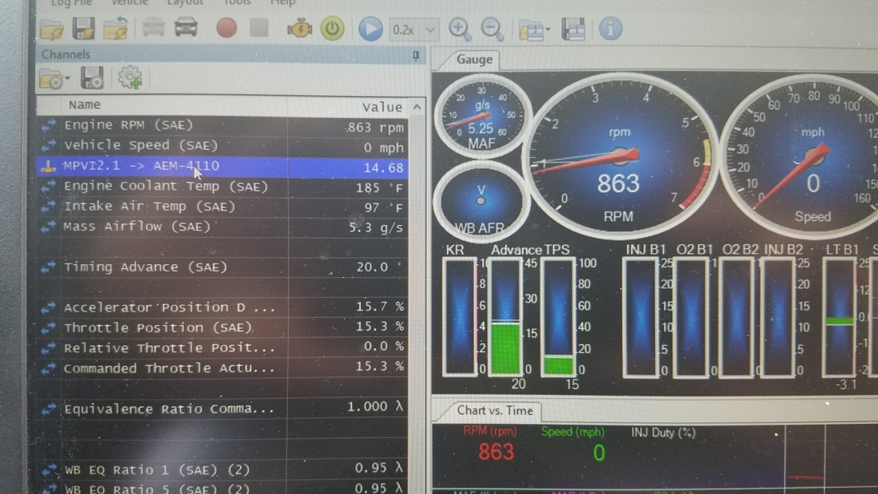

    Who can point out how to get my wideband gauge to display? I got it as a number on the left but after an hour of screwing with it, I can't get any numbers to come up on the actual gauge :confused::bananadead:
