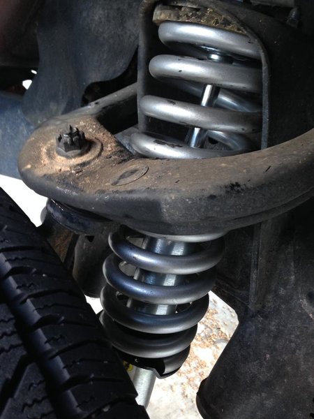

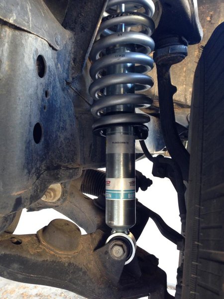

    I guess he's kinda correct. It's not the shock itself that's giving the lift. But that C clip adjusts the coil seat, which on the highest setting it compresses the super stiff coil even more, and provides even more lift, hence the extra 2.5" of lift.

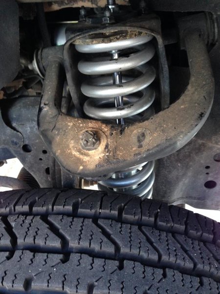

    Mainmoe02 yeah Ill be quite honest and say I don't really understand the whole "lift from shocks AND coils combined" type of thing.. all I know is that everyone says run it on the 1st clip which they did not. I have faith in this other place because the manager actually has the same exact truck as me and has a lift on it as well.

    Didn't read it all but read enough, to the OP, don't let anyone (tech or not) move the clip from stock position when running any aftermarket coil that is longer than stock, this is where your lift comes from, longer,stiffer coils don't need anymore preload other than what it takes to get a nut on the strut...

    gman2530 You asked me in an earlier post to measure when it was done. Just to give you an idea of where I am at now I'm right at 40'' give or take a tiny bit. Im sure I was nowhere near that before this lift.
    4WD Yeah dude just figured that out too bad it was a little late. She's going to sit until tomorrow and the shop will put them back to the stock height.

    Got the truck back from the shop already and this thing fucking drives 10000000000000% better than before. I couldn't be happier. Nice and smooth and has a monster stance. Here's the final result.. final.jpg

    So now your clip is on the lowest setting? Im only asking because I just installed the 5100s with the 883 on the lowest clip and my truck still leans forward is there any way to get around another 1 inch of lift outta my set up

    I'm sure one of these dudes will be able to help you out but yes my clip is on the lowest setting. I have the Eibach coils up front though. My front looks like it sits just barely above the back I am going to measure tomorrow.. Im sure itll probably drop down to even or so after some time goes by.
    Edit: I will tell you something though dude.. before when my clip was set higher the ride was SHIT and when I mean shit I didn't even drive it home last night so just be careful.
