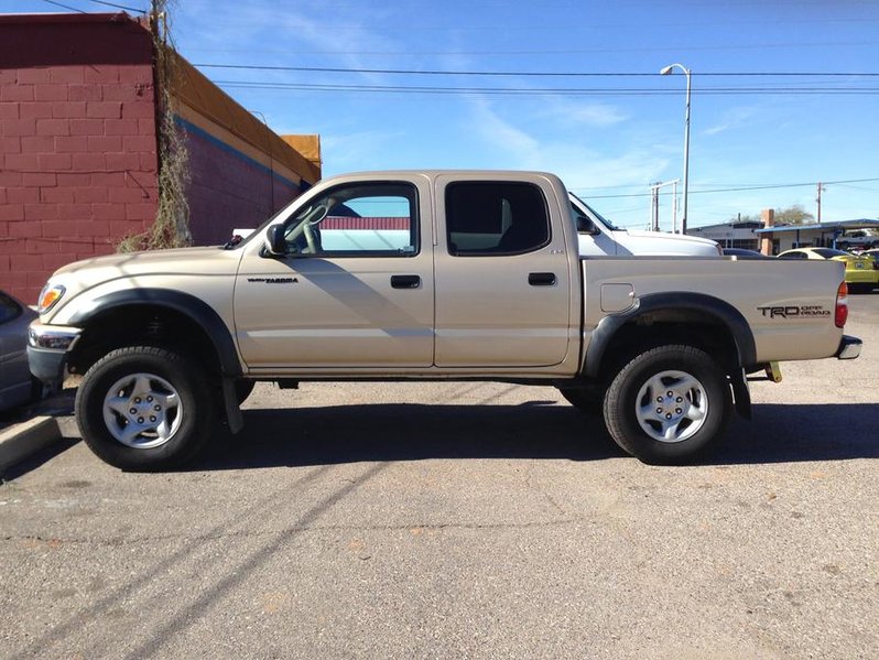

    So I finally got my 5100s and Eibach coils in the mail yesterday. Not to beat a dead horse but I want to make sure I put them on correctly. Do I keep the c clip on the zero or .85 (the second clip) setting to get a 3" lift? I looked around the forum but keep getting different answers.

    Yeah first gens don't have the .85" setting, that's only for 2nd gens because they get 4 lift height options. Anyway for us 1st gens the lowest clip is stock (zero lift) rise height and the 2nd clip is 1.75" lift. But with the Eibachs you need to put them on the stock ride height setting (zero lift). Reasons behind it are the Eibachs are stiff and shouldn't be preloaded on 1st gen trucks.

    Theres only one right answer, as mentioned DO NOT raise the clip from the bottom position with aftermarket coils, especially with the Eibachs, they'll give you 3" of lift

    Looks great dude!
    Where'd you order from? And how much was the shipping?
    How long'd it take to install the fronts and did you have trouble?

    Hey guys sorry I haven't been on in a while.. I stopped getting emails regarding this thread so I figured it was buried already (which it seems to be now). I browsed through a few questions so I will try to answer the few there were. I ordered my set up from the Toytec website, I cant remember exactly how much shipping was. I live in Arizona and I am pretty sure it was under $100. If you are going to run the same setup as me DO NOT MOVE THE CLIP ON THE BILSTEINS. The first shop that installed mine did this thinking it didn't matter and because of that I have some popping up front which I think is coming from damage to my ball joints. The ride is very nice I would say it feels almost like stock just a little more stiff. I was originally going for a little bro lean but it seems like my truck sits almost perfectly level which hasn't bothered me much. Overall besides the popping I experience when hitting large pumps (ex. speed bumps) I am very pleased with it! I would definitely recommend!
