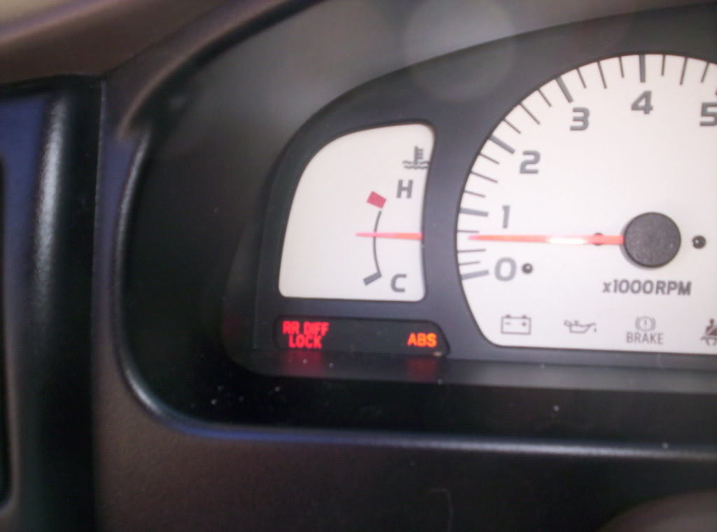

    cool thanks....one other question im looking at this pic (above) of #8 (permalink) [​IMG] vbrep_register("40554") [​IMG]
    [​IMG] 12-09-2007, 04:25 PM
    2003greenbean
    and his engine temp. is the same as mine ..that looks a lil hi as it is above half...i come from driving hondas where it is alot lower (below) = temp. gauge needle ...please advise. thanks

    That engine temp is normal.
