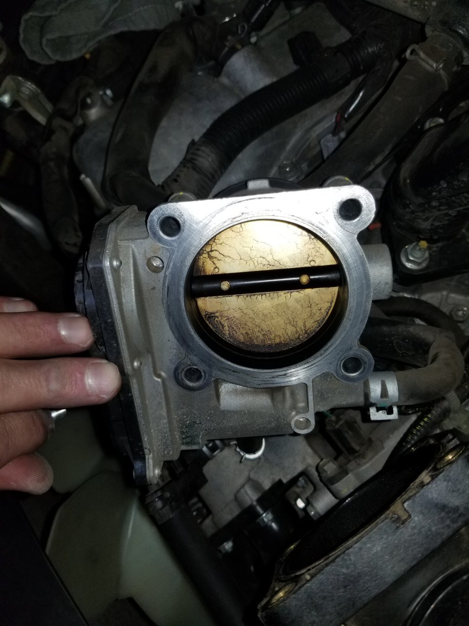

    Had high idle. Reset battery 3x. Third time was charm.
    Look how dirty throttle body was at 88k20181221_175546.jpg 20181221_175546.jpg
