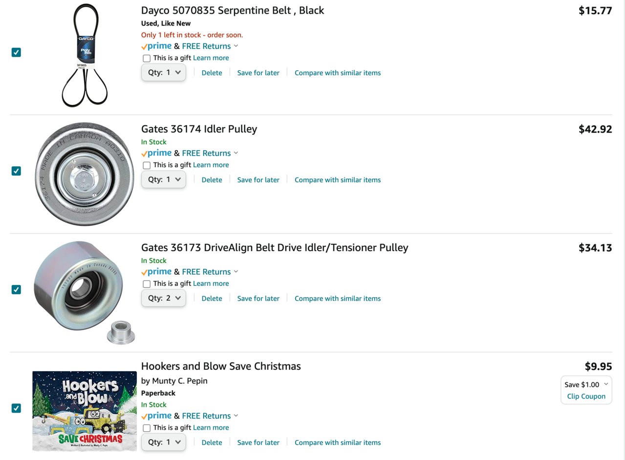

    I just opened up a rabbit hole in searching through all these threads to decide what route I want to take, lol. Ended up ordering from Amazon, was cheaper than RockAuto and I get it delivered tomorrow. I have an OEM belt but I don't want to risk shredding it if something else is wrong so I bought a cheap belt and once I confirm everything is good, I'll swap my new OEM belt and keep the cheapie in the truck. My tensioner pulley actually seemed good (I should have included it in my video) so I'm leaving that for now. Thought you guys would get a laugh at my Amazon suggested book, LOL!

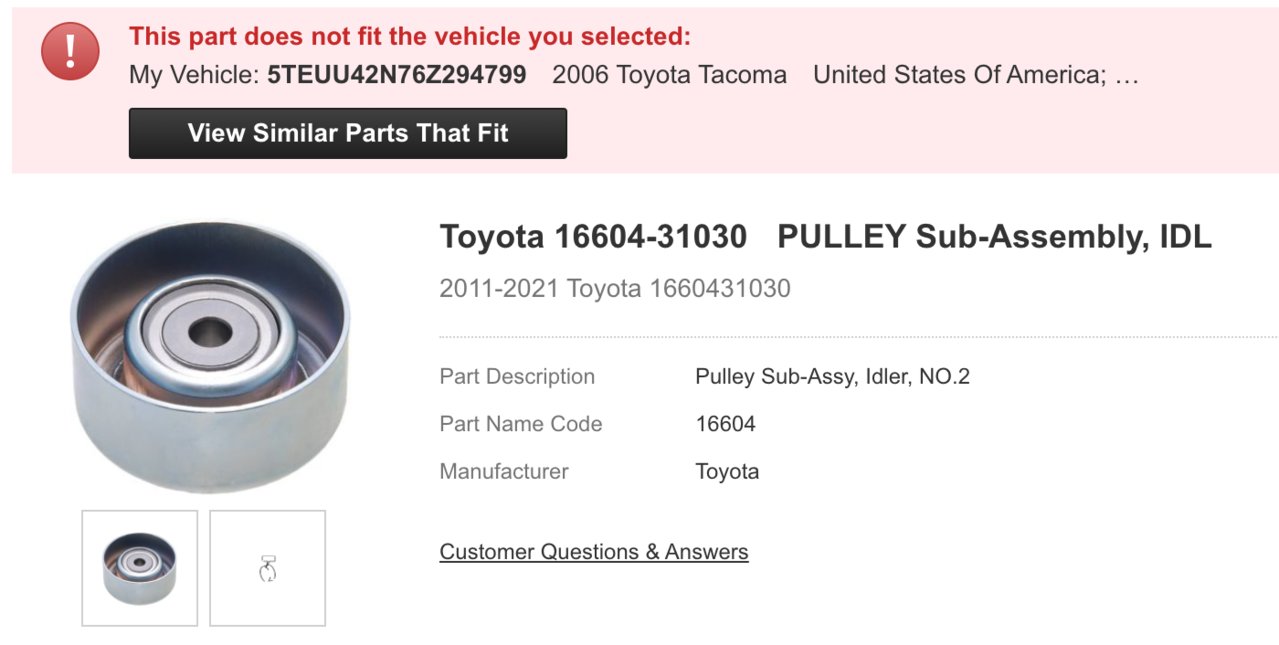

    I did check and all the other part numbers superseded were also listed as unavailable. I searched for the same pulley for a 2016 Gates on Rock Auto and it listed the same part number. I ended up cancelling the Amazon order and I ordered the pulley for a 2016, part number 16604-31030. Website says it will not fit my '06, but I guess I'll find out. I'll update here when my order comes in. 25% off, I ordered $500 worth of stuff and have another $500 in my cart right now in FJ40 parts. I figured I should buy just about whatever I can use that is left in stock. Sale is good until 3/23 with free shipping.

    I was able to find it in toyotapartsdeal.
    Here is the link.
    https://www.toyotapartsdeal.com/oem/toyota~pulley~sub~assy~idl~16604-31030.html
    If that doesn't work for you then you can use this site which is an international site where you can order Toyota parts.
    https://www.amayama.com/en/catalogs.../engine-fuel-system-and-tools-1/water-pump-20
    Scroll down till you see the 16604 pulleys. There are two models numbers that are available that should work for your truck.

    Here is what that website has for that pulley for my truck.

    Try 16604-31010 or 16604-31020
