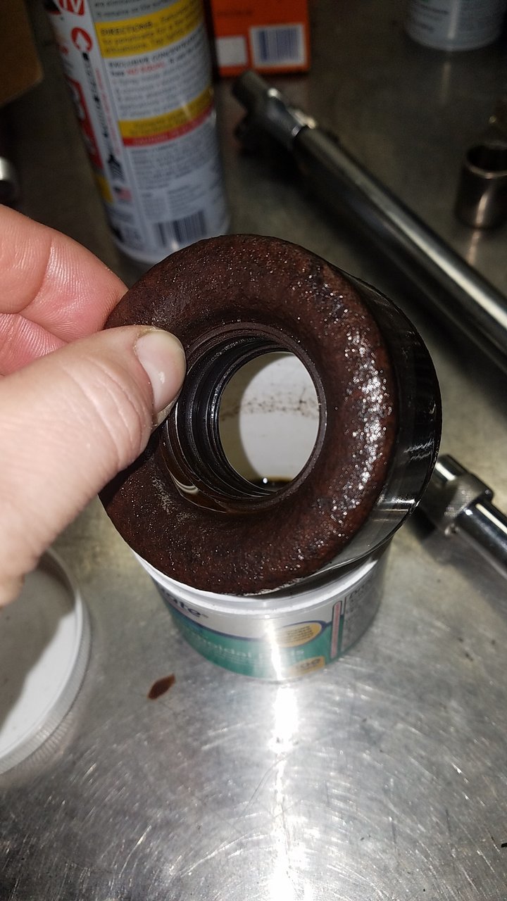

    Heres whats left of mine. Hopefully its reusable.

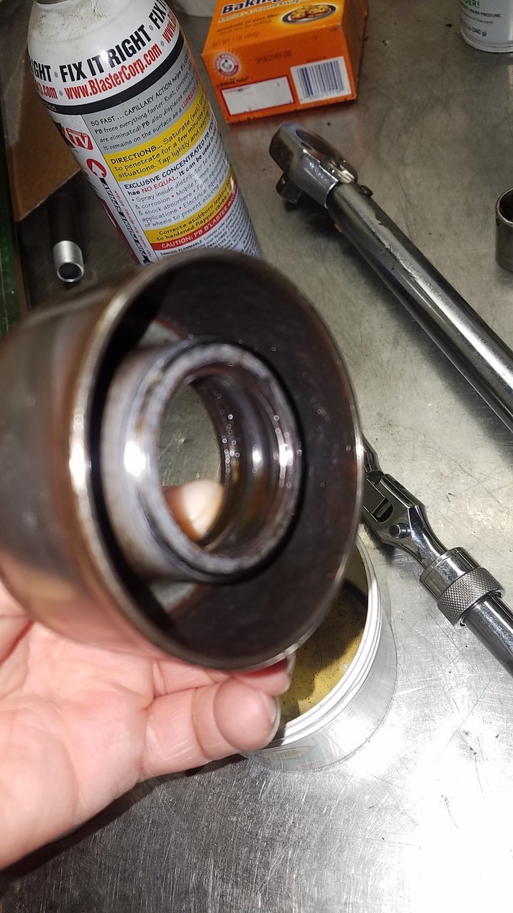

    Heres the inside of the bearing

    @g350h Yuck! I would use a dremel or small cutting wheel to make a groove on the race, wide enough to try and punch it out with a chisel or old screwdriver. Some heat on the race may help break it free. You may also consider grinding the lip away from the rear; it's only purpose is to prevent the bearing from being pressed in too far. Once the bearing is in place, it's not going anywhere. I've seen many a bearing with no lip on the rear. Matter of fact, I believe most aftermarket pulleys come with no lip in the rear. Do measure how far down the bearing is pressed on the OEM pulley so the belt doesn't sit too far in or out on the pulley.
    One other thought: a wrecking yard. Take the old one with you; it may match pulley from other Toyota engines.
    The face of the pulley looks excessively rusty - you take your truck skinny dipping? If you can get that race out, wire-clean it well and spray some paint on that face; I've had too experience with the rust converter spay.

    Got the old one out easy, couple hits with the hammer and chisel. Cleaned and painted it, pressed in new bearing. Installed with new belt, nice and quiet now. Thanks for the ideas.
