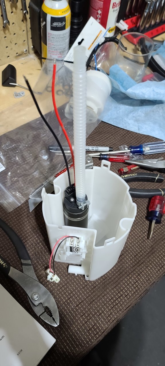

    Quick tip for the fuel bowl and making the holes for the strap that holds the pump in place. Instead of using a dremel, heat the end of a flat head screw driver up with some Map gas and just push it through. Way easier to control than a dremel and much quicker

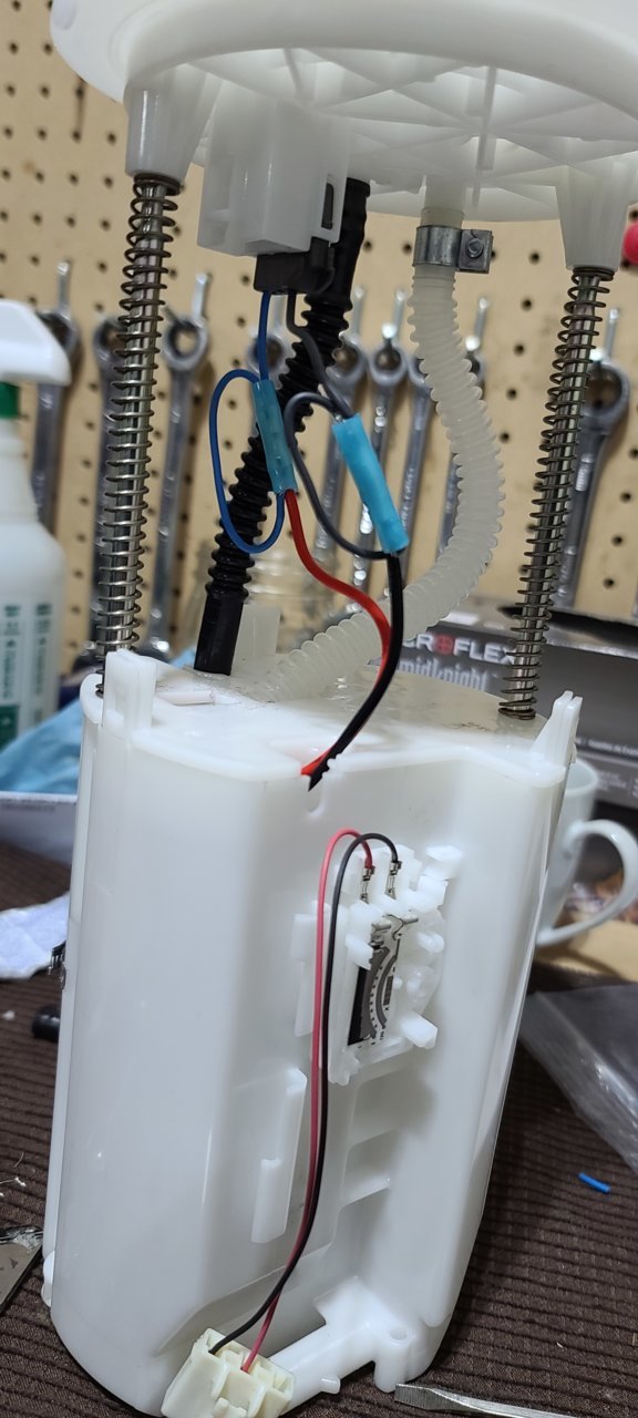

    So I don't know how I feel about crimpers so I also soldered the left over wiring from the fuel pump. I'd feel a lot better about this kit if it came with a solid wire with insulation from the aftermarket pump to the toyota plug.
    Kolter45 and Torspd like this.

    1,692
    '09 Pyrite DCLB TRD Supercharged
    You have to make sure those melt on connectors are fuel resistant. I used only the stuff in the urd kit because it was rated to resist corrosion from fuel. You don't need any of those boys eroding away into your fuel system. Def double check on those connectors.

    2005 DCSB soon to be with V8 1UR-FE
    Those are the URD kit crimpers. I also soldered in the wire that comes out of crimp, goes around and back into the crimp for a redundancy. I just don't trust the crimper method. I'd like to find a solid wire harness.

    Boosted Money Pit....
    I picked up an aftermarket drop-in to get mine prepped. I have not installed it the cable from the top portion to my AEM pump was plug and play. I don't think I will need to cut and solder. i can look up the drop in but if that works one less thing to deal with. Do we need to create that loop in the cable that's the only difference i have noticed.

    You do not need to create the loop.
    Yeah on my current build, the AEM pump was plug and play with my 2016 Gx460 fuel pump housing. I don't think I tried last time to see if it was plug and play. Although if you do have to cut and solder, I found that you can use PTFE Teflon heat shrink tubing. It is highly resistant to gasoline and works great in gasoline submersion.
