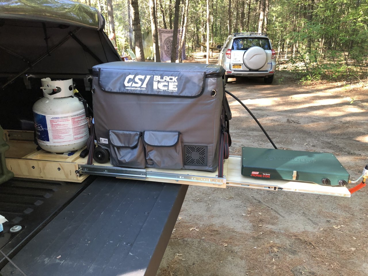

    I got ideas from the thread linked and then built this:

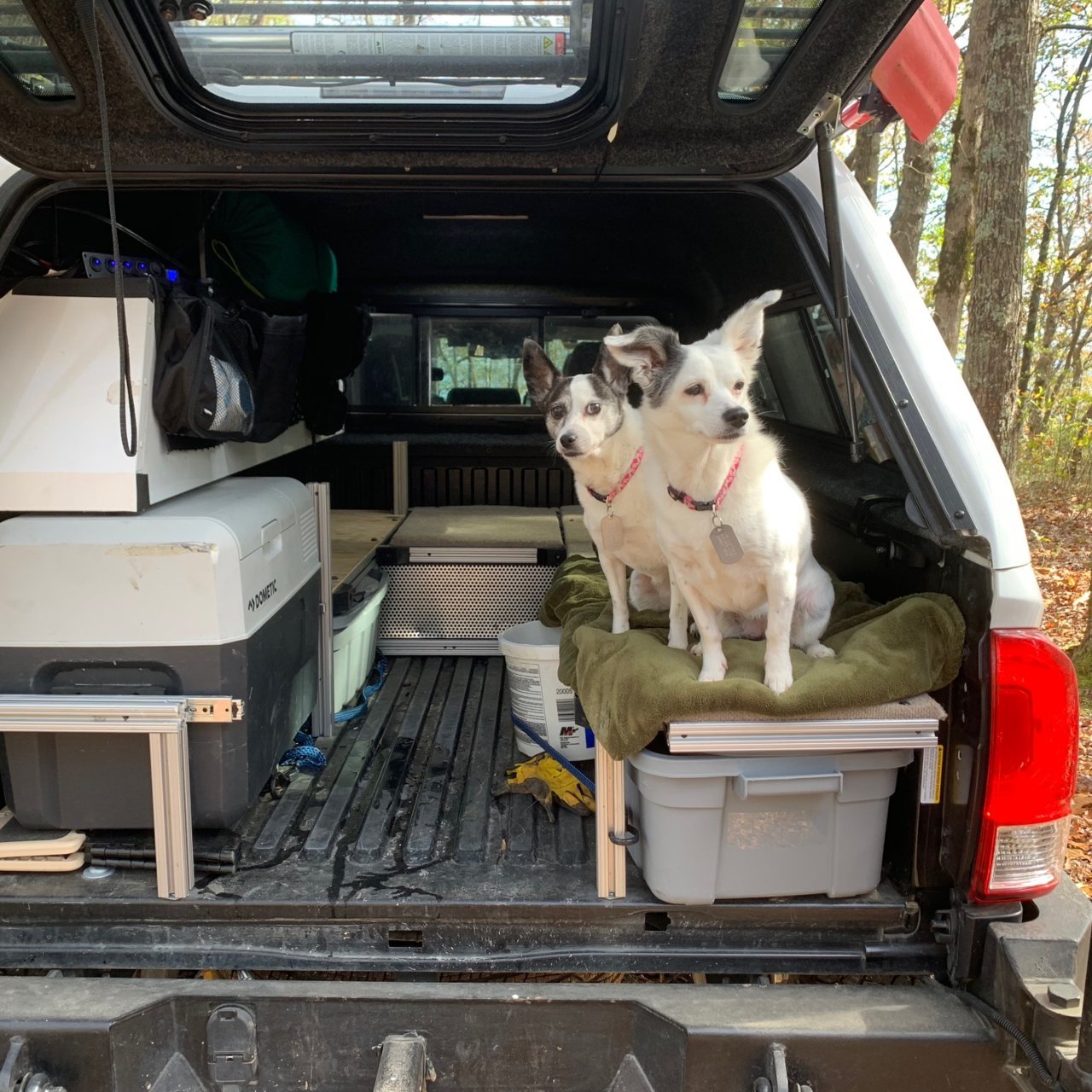

    I used tslot for mine. It's aluminum extrusion. All was salvaged from work or bought 2ndhand from a local robotics company as extras / cutoffs.
    The pic is a bit of a mess and the build is still in progress, but you get the idea. The middle is open for storage or whatever else, I sleep on the right, and there's tons of storage underneath in bins. The front area flips up and stuff stows underneath. It's ridiculously stout because Tslot is ridiculously stout.
    There's more pics and a quick drawing of the system I made on my build thread in this post - scroll down to 27 Feb after it all loads (warning, link has TONS of pics): https://www.tacomaworld.com/threads/hammerhead-the-4x4-dclb-tow-and-trail-rig.671016/#post-23557721
    I'll see if I can get a few more pics too, the thread needs updated with my last 2 rides and some more work I've done on the platform since.
