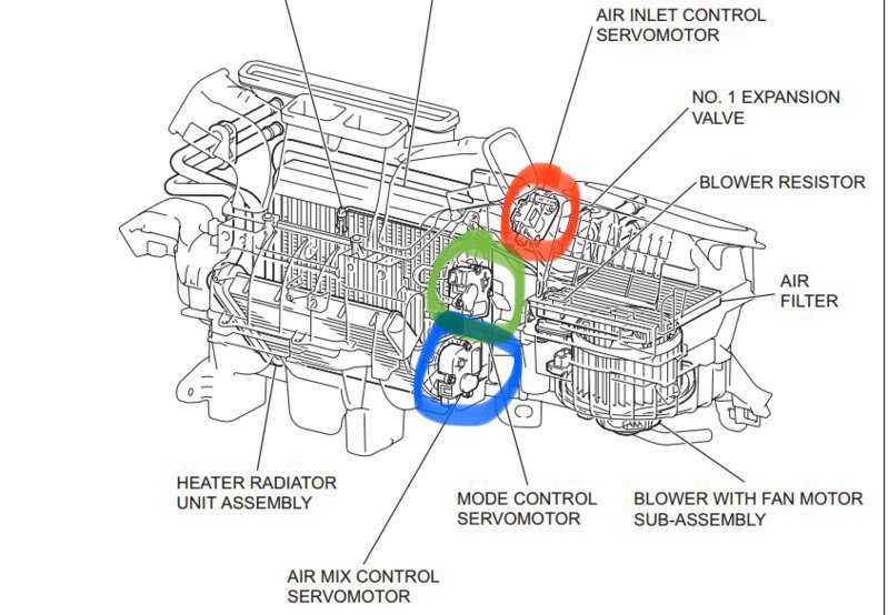

    Actuator servo locations below (thanks to @Jimmyh for the picture), all 3 are on the passenger side. If you wanted to rule them out you could just leave them unplugged one at a time when it's working so they can't move and see if your problem still occurs.

    I will check the three actuators if I can get to them. From the schematic above it looks like they’re not very accessible, but maybe I’m wrong?

    The mode and temp are right under the glove box and the recirculation is behind, they are really easy to unplug, I did the wiring mods on mine so I can have recirc anytime and A/C not on with defrost.

    Decided I'm going to replace the two lower servo motors. After more research I'm confident one of the two is the problem. I'll replace both and (hopefully) be done with it. Yes, I know that I probably don't need to replace both and I'm just spending more unnecessary money, but I'm fed up. I can justify it by knowing that a shop would have charged me more than I've spent total on all parts just to replace one of these parts (right? :D)
    I want to make sure I've located the correct part numbers. I'm finding a lot of different part numbers that say they'll fit and photos of the parts aren't consistent. From what I've gathered I think that BLUE temp servo is 87106-04050 and GREEN mode servo is 87106-04060. Confirmation is appreciated. Thank you all for your help thus far.

    Just documenting for future wonderers. I confirmed the correct part numbers with my local dealer.
    87106-04040 (air inlet/recirc/air mix 2) - circled in red
    87106-04050 (mode) - circled in green
    87106-04060 (air mix/temp) - circled in blue
    Parts are on order and I'll report back on whether the issue is resolved.
