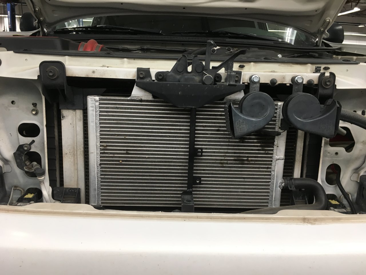

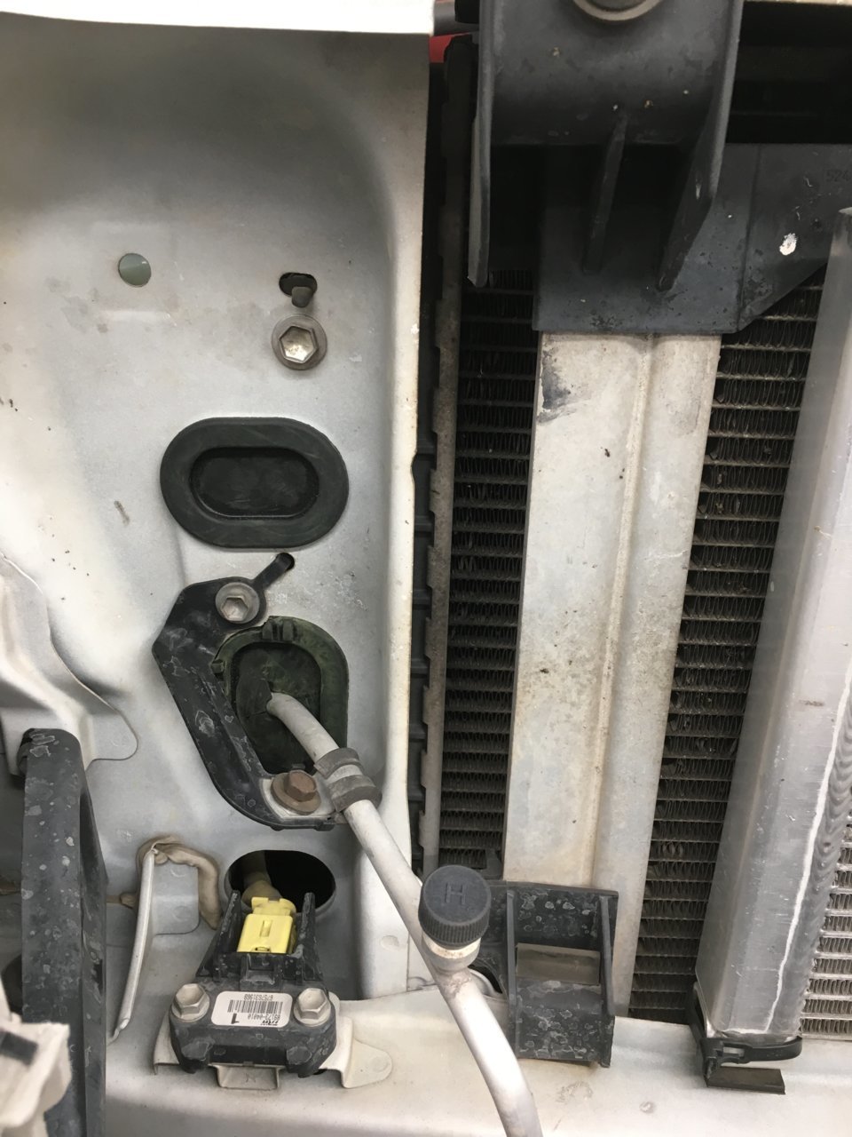

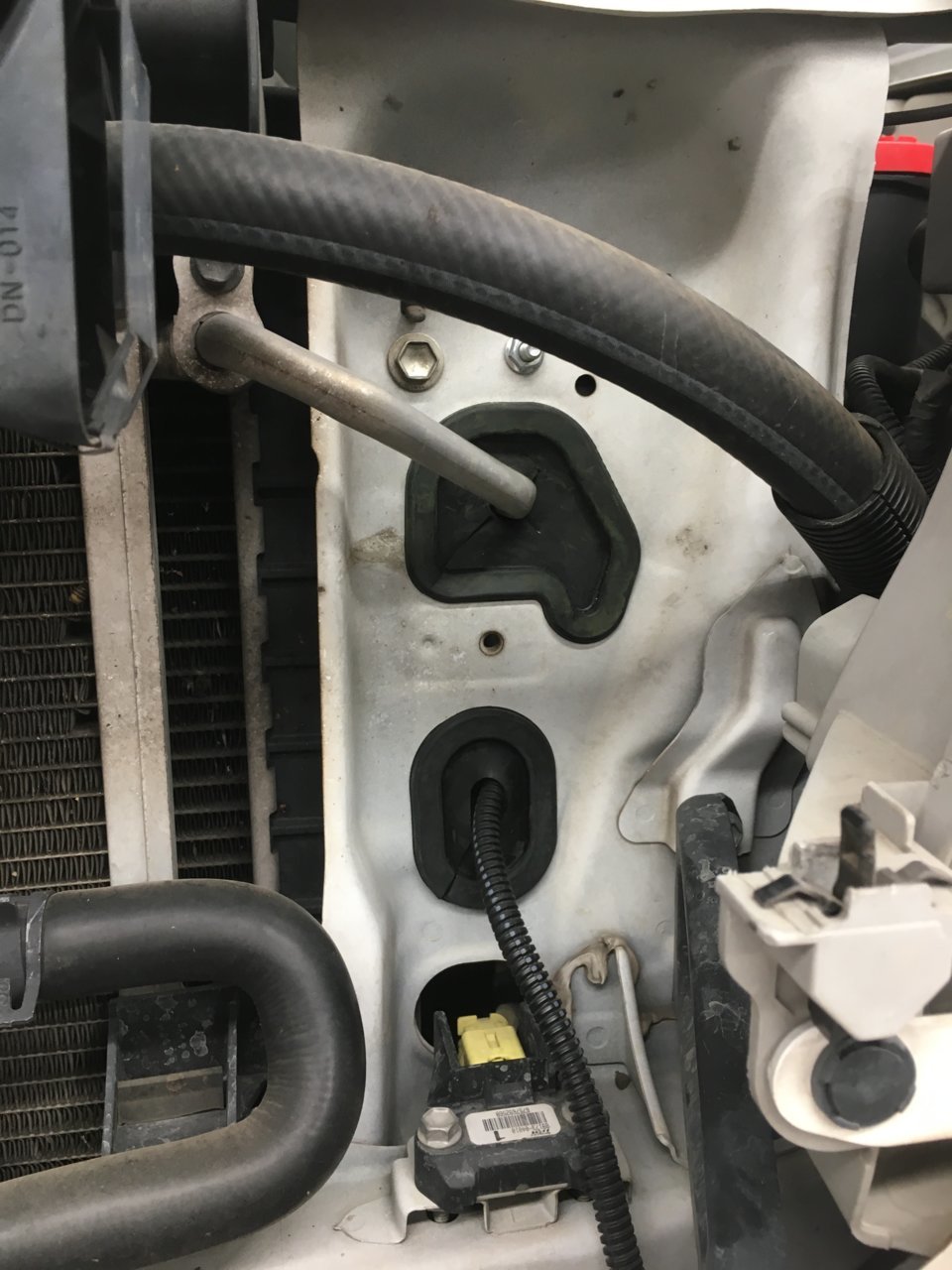

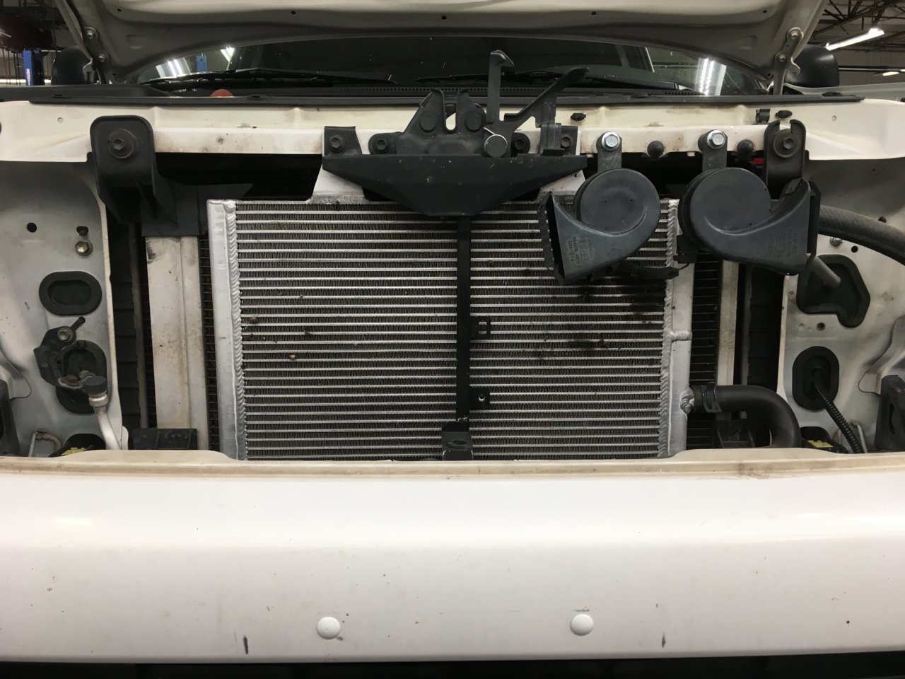

    I Installed those four seals this evening. Was a piece of cake. I don't really expect to see any noticeable change yet obviously. Need to seal up the sides and bottom still. Those areas are far greater hot air "leaks" than these four holes are.

    After staring at things in there for a bit. I'm thinking that a condenser fan is not very practical for my particular truck. The blower radiator would make it a PITA.
    I think I'm better off focusing on maximizing the efficiency of the fan behind the radiator and/or going to a dependable electric fan setup. I'll then go about sealing up the areas around the condenser so that air pulled through the radiator must pass through the condenser instead of sneaking in from the sides.
