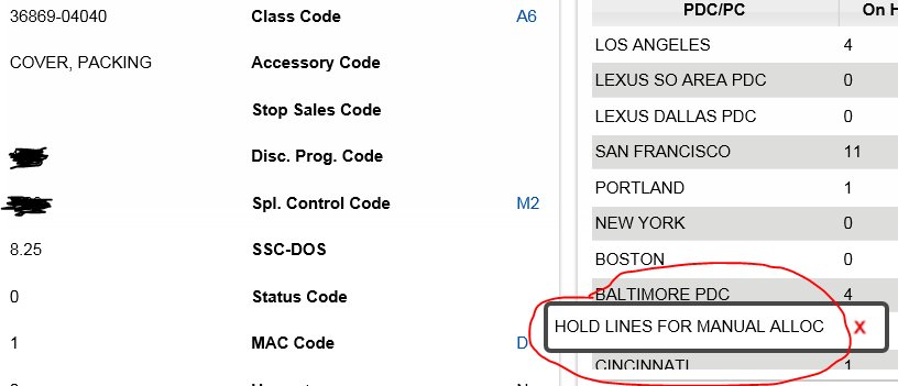

    I found a valid VIN and ordered from a local dealer. Has to be a truck originally produced for retail sale in Mexico.

    They are sub parts to a kit that toyota sells to increase ac performance while sitting still. Supercharged trucks don't need the whole kit because they can't use the fan. So, this is the workaround.
    the TSB is in the post I quoted earlier.

    At least order the radiator side seals. They're readily available. Stick em to your new rad when you install it
    53285-04010
    53286-04010
  10. Jul 27, 2019 at 9:24 AM

    Strange, I just placed an online order for all 8 seals with my local dealer, it's processing now we'll see if they kick it back. I did not provide a VIN. I wonder if Toyota Corporate logs which VINs have purchased these items or if they just check to see if it was produced for retail sale in Mexico (i.e. one VIN can buy these parts many times)

    We're gonna find out.
    I don't know for sure if the PRA's are keeping track on these. I don't even really understand why they put them on manual ctl.
    Kind of weird that they did. I know on some parts, they're watching like hawks tho.
