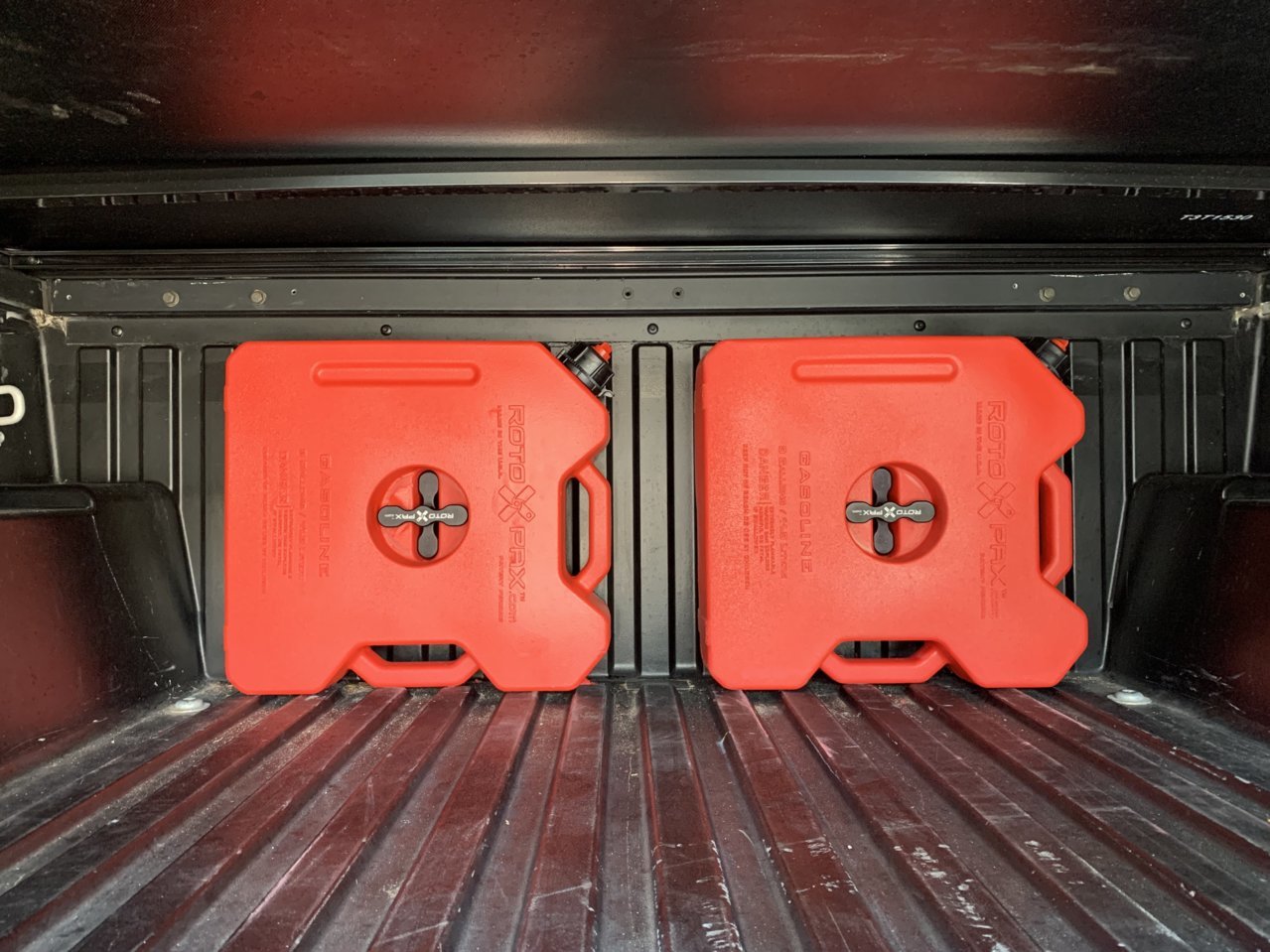

    Phich
    Phich Porkchop Express
    Feb 17, 2017
    #210855
    954
    San Antonio
    2017 TRD Off Road tuned to KDMax perfection
    Six Demon Bag
    Mounted to the front wall of the inside of the bed:
    Two each of these for 10 more gallons of fuel.
    https://wavianusa.com
    https://wavianusa.com/collections/a...-duty-20-liter-jerry-can-holder-front-loading
    Weight full would be right around 110 lbs
    You lose very little cargo space.
    I have a similar setup but with 3 gallon plastic Rotopax tanks.
    Half a can of seafoam for fuel stabilization in each and it's good for at least a year if they're sealed gudentight.
    In retrospect I wish I would have spent the extra few bucks on the Wavian's or similar in quality metal can.
    Possibly the xmas gift to myself.
    My current auxiliary fuel.
    EDIT: for those with Rotopax that bulge out on the bottom (they all do over time) try storing in a sideways manner as I have and they tend not to do that.

  15. Oct 4, 2020 at 8:38 AM
    Phich
    Feb 17, 2017
    #210855
    954
    San Antonio
    Six Demon Bag
    Water weighs 8.3 lbs per gallon, fuel (and diesel) weigh 6.8.
    Not that its a big deal though :thumbsup:
    EDIT: I had to double check just in case I had for some reason forgot.
    So diesel is 7.1 lbs
    Gasoline is just a hair over 6 lbs.
    Malvolio and tonered like this.

  20. Oct 4, 2020 at 8:58 AM
    #20
    Phich
    Feb 17, 2017
    #210855
    954
    San Antonio
    Six Demon Bag
    Ugh, I know. And the quality is decent but not killer. I've had a leaker that wasn't a year old before. Those are the last Rotopax I will buy.
    Yeah another EDIT: If you look at the color of my tanks in the pic I posted above you will see that they are a lighter color than the normal rotopax tank because I gave them two solid coats of red raptor liner for a little more durability. Where the handle secures the tank it is rubbing off, but the rest of the tank parts are holding up nicely.
