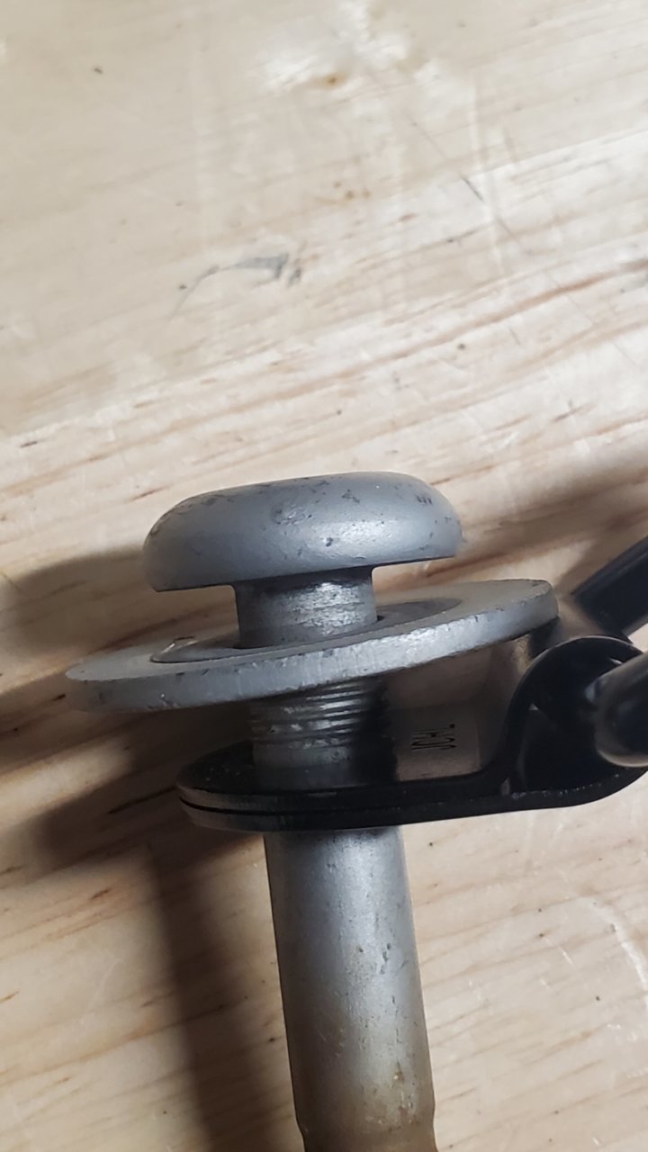

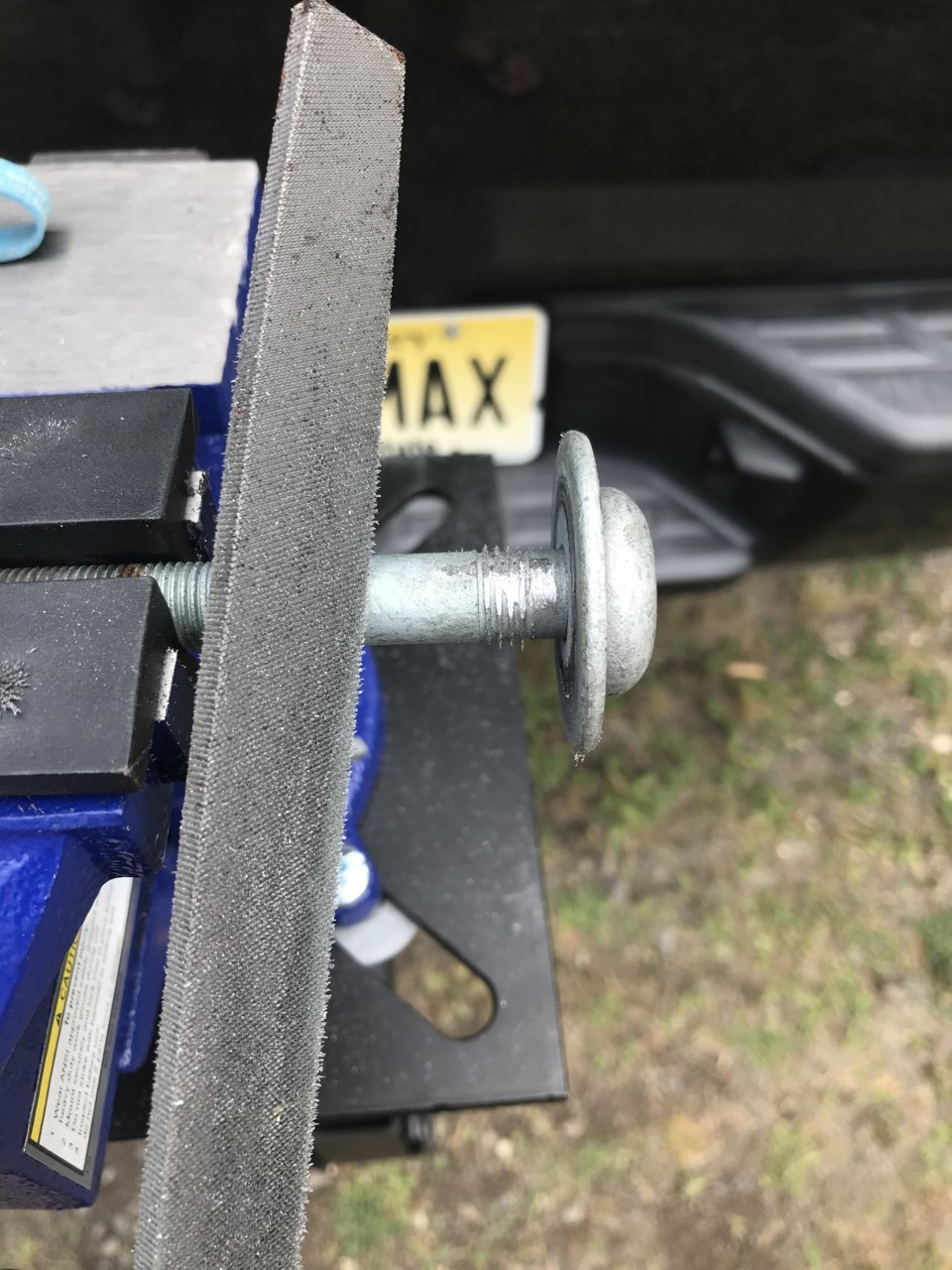

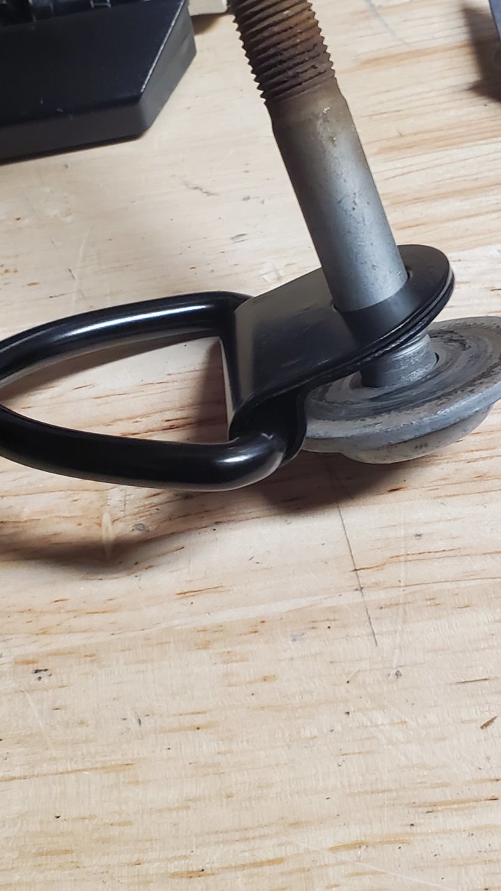

    You have to grind the rings on the bolt, take the washer off, and put the washer under the D ring.

    Great thread, I took out the bed bolts, PB Blast, couple of wacks with a ball-peen to the face of the bolt and a breaker bar no issues. I used a bastard file (Yup, File Sr was never part of the family...heartbreaking) to file down the rings on the bolt to release the washer, I have a Dremel but for some reason I didn’t want to ground down a dremel head. Very easy with the bastard!
