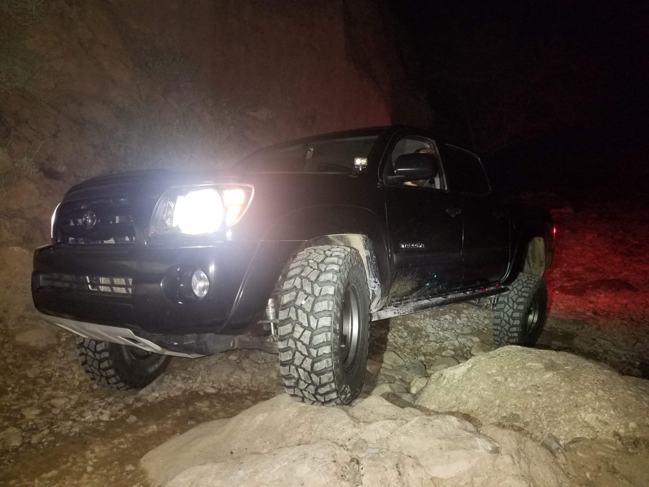

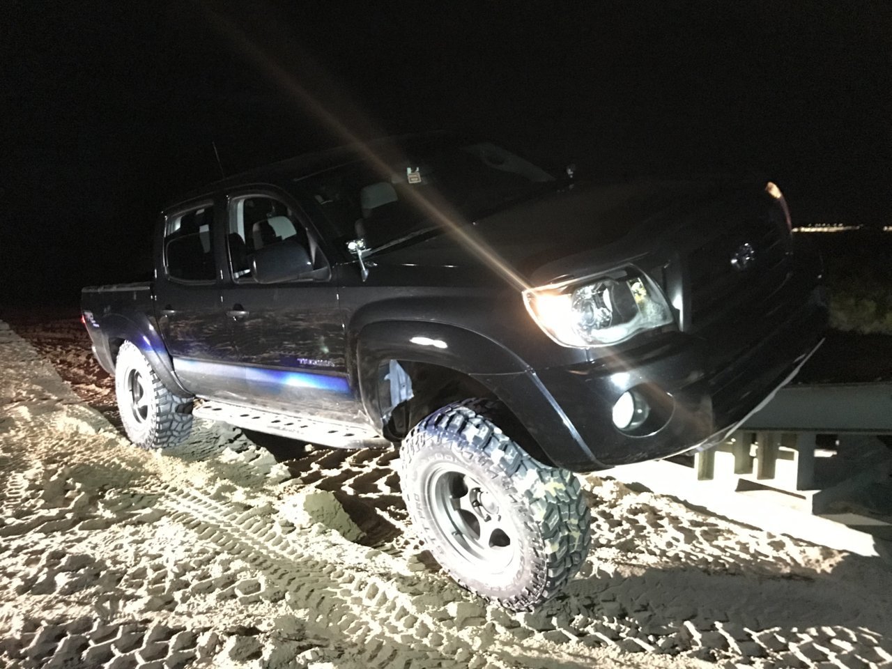

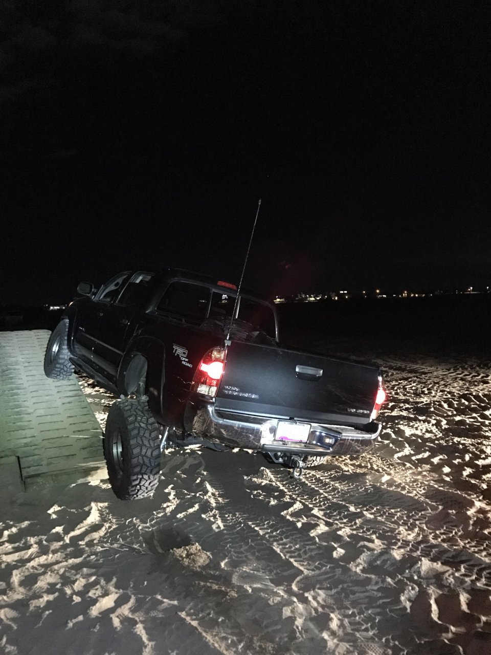

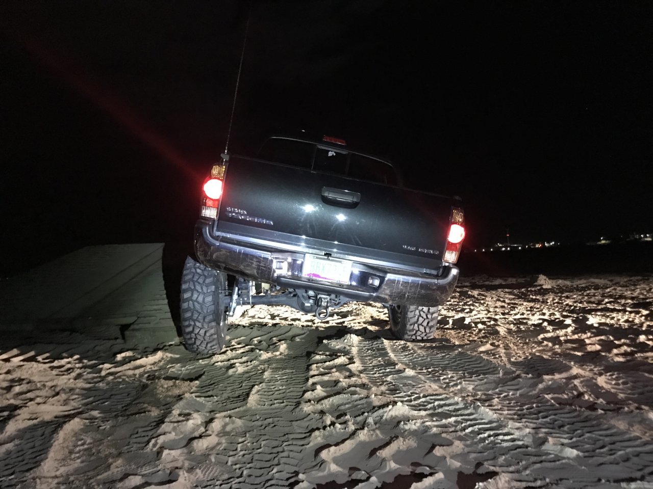

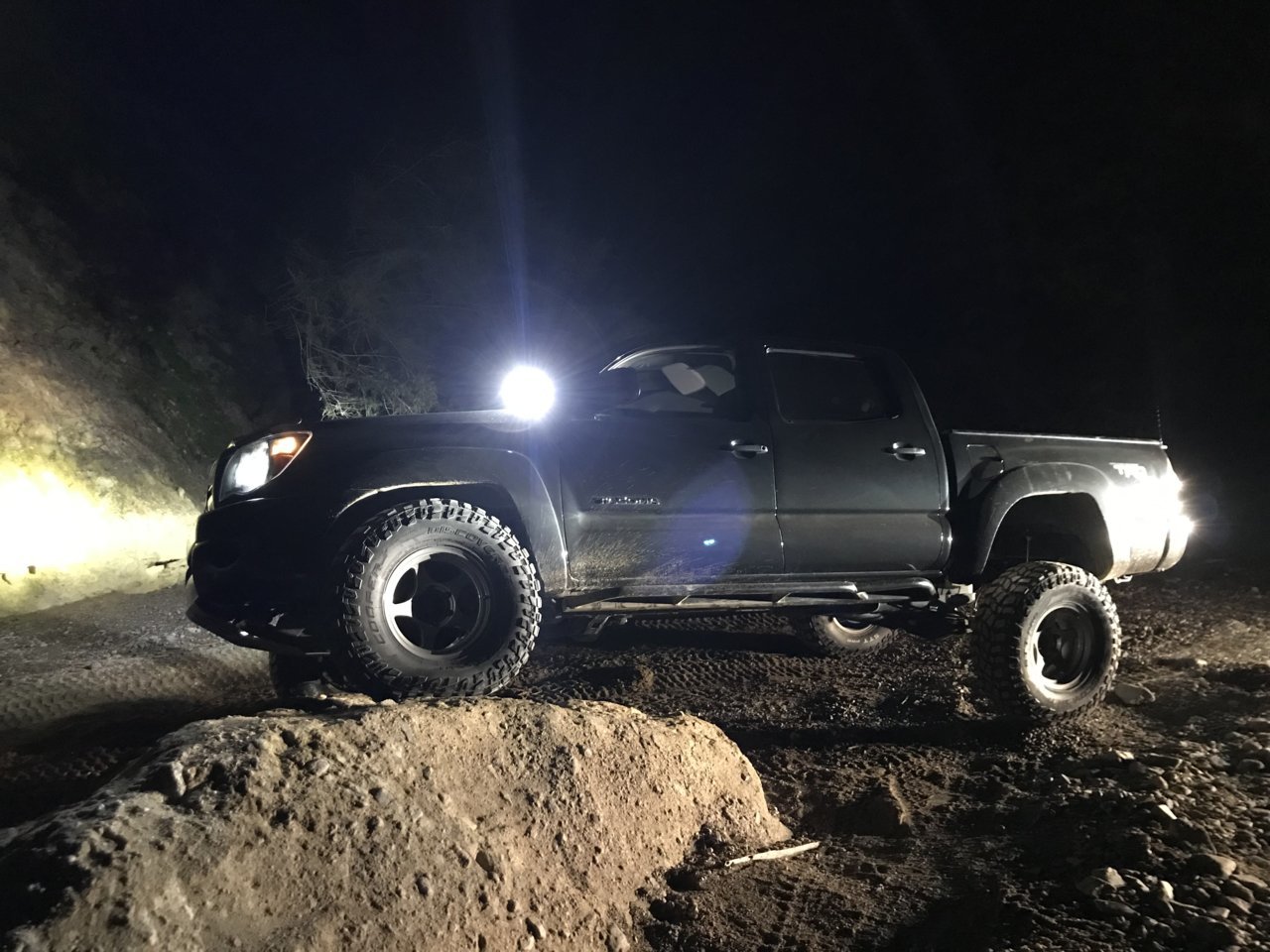

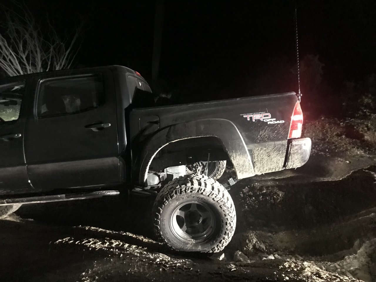

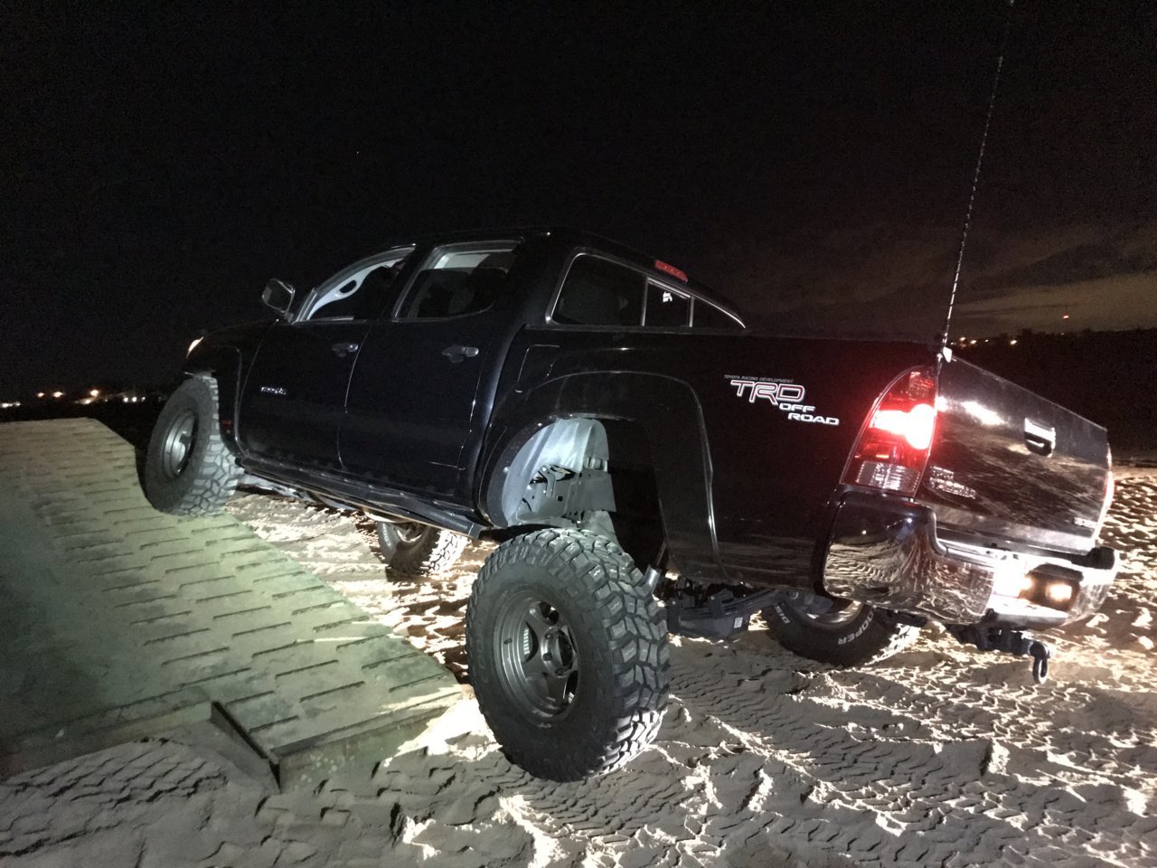

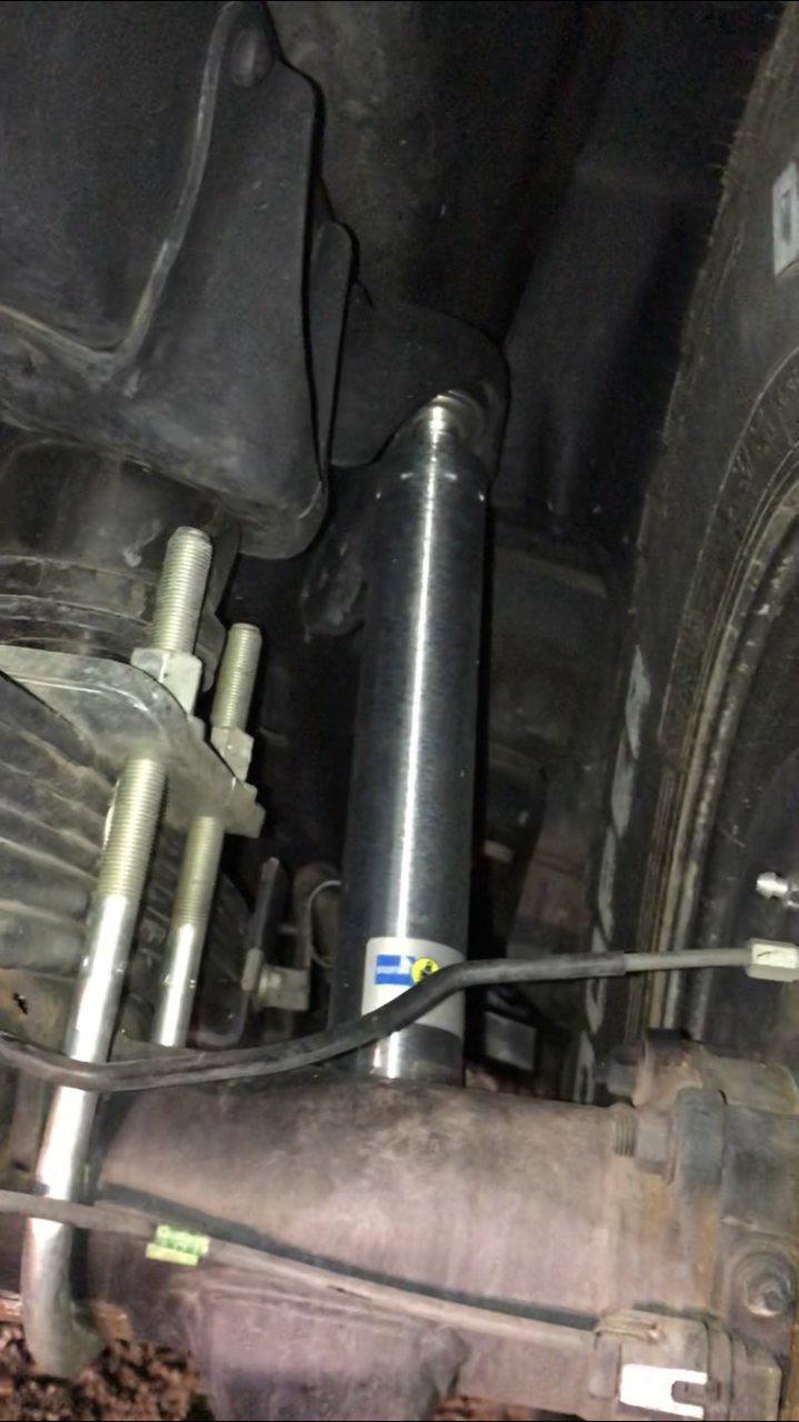

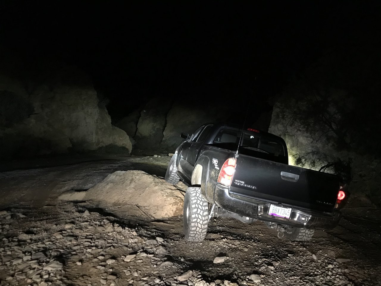

    Guys. These shocks are the REAL DEAL! Got to stretch mine out this week and MAN OH MAN this travel is literally unbeatable. They are the longest shocks on the market for factory bolt in replacement I believe.
    B110
    Dakar standard duty
    Wheelers superbumps with ubolt flip kit
    Wheelers extended brake lines
    4WDTrout, IronPeak and Taco-Obsessed like this.

    #276756
    7,448
    Nice shots man. I have been considering this and your photos (plus having the same rear lift as me) has led to me pulling the trigger.
    I saw you didnt get the bump stop spacers. Are you hitting the bump stop before bottoming out your shocks? Have you hit them hard and fast yet? Meaning the bump stop would have been really compressed and still didnt bottom out the shock?
    Did you get the +2 or +4 extensions? If +2, at full droop they were good?
  16. Jan 19, 2019 at 8:41 PM
    #76
    singletrack_ftw
    singletrack_ftw “I chopped the wrong leaf!”
    Aug 27, 2017
    #228223
    3,685
    Tyler
    AZ
    ‘08 TRD OR 4wd
    https://www.tacomaworld.com/threads/singletrack’s-‘dad-shred-build-thread’-i’m-just-doing-it-for-the-kids.619250/ Sos offroad sliders (kickout + filler) Sos offroad full belly skids (steel) Sos offroad front recovery point Sos offroad concepts HC rear bumper with bedside kickout tubes Marlin Crawler LCA frame brace kit Trail Gear rear diff cover Bilstein 5100 + OME 885 Total Chaos UCA BILSTEIN b110 OME Dakar standard pack Wheelers Ubolt flip kit Wheelers Superbump f/r Wheelers SS extended brake lines FN five star 16x8 -25 Milestar Patagonia MT 315/75r16 Custom projector retrofit (acme super h1 + morimoto 4300k) Baja Designs S2 sport ditch pods on CBI ditch pod mounts Amazon AMAK rock lights CMC CB radio hardmount
    Thank you!
    -I did get 5/8 bump extension spacers from wheelers but I haven’t installed them yet & based on my flex ramp findings, I will not be installing them but they are handy if I end up blowing a shock (great warranty on b110’s).
    -I have a video showing what my superbumps look like when the b110 shock is literally completely fully compressed and the superbump is squished down maybe half an inch.
    -considering above^ I SHOULD put the spacers on the bumps but I never wheel fast enough to full bump compression of the axle. If I’m doing that I’m breaking sh_\. I go slow and steady when I wheel and even at 50mph on dirt fire roads I don’t believe the rear actually fully stuffs at all.
    -I got the longest wheelers extended lines they sell. I believe they are +4 & those and even my rear diff breather tube we’re not naut at full droop on the drivers side when I drooped it

    This is a pic from the flex ramp where you can clearly see the shock has no more compression left in it. Again, I realize it would be prudent to install the spacers I have for them but I haven’t yet.
  18. Jan 19, 2019 at 9:11 PM
    #78
    Taco-Obsessed
    Dec 23, 2018
    #276756
    7,448
    Thanks @singletrack_ftw
    That picture is what I needed.
    Do you think +2 are long enough? I worry about catching the +4 going over sticks, rocks, etc.
    Appreciate ya bro.
