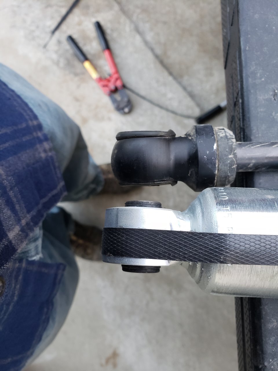

    Where did you order from? That’s very weird and interesting. FWIW when I installed my 5125’s I had to bend the factory lower shock mounts a little bit open in order to fit the bushing in there. And I also had to grind down a little of the bushing on the 5125. The b110’s didn’t give me any trouble. Call whomever you ordered them from and show them the pic

    Thanks. I am going to bend them open more and try again tomorrow. I thought about grinding down the bushing. how did you do it and keep it even?

    I wasn’t too worried about it being perfect. I remember using a dremel on each side of the 5125 bushing. Again, my b110’s went in easily but I pre-bent the lower shock mounts with the last time I put the shocks in so you probably just need to coax them a little bit

    My B110s slipped in perfectly - no bending or grinding was needed.

    I know the 2015 shock mounts changed a bit and others have to grind down the mounts for OME to fit.
    I ended up bending the shock mounts out using nut/bolt technique. It helped but still wouldn't fit. Moved onto a die grinder to take a few millimeters of the protruding bushings. Got the passenger side in. Same with driverside got it in but the body of the shock was touching one side of the mount. Angle grinded that down like other 2015 folks do to fit OME .. touched it up with paint. Letting it dry so got on TW. In a bit I will remount it and be done.

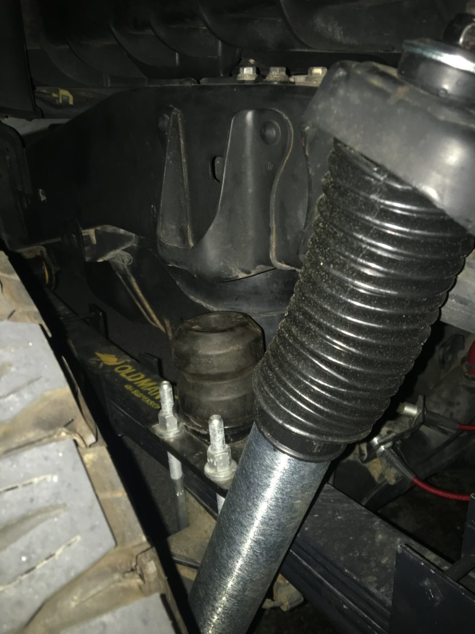

    Don’t mind the surface rust. The standard load Dakar’s are plush and flex great with the b110s (I do run a topper 75% of the time). Running timbren bumps with right at 3” of up travel before they make contact with the seat. Running +2 lines with some washers stacked for the bracket spacer mod as you can see. Lines are lose even at full droop. Everything will be put to the test on the Red Clay Rally at the end of the month!
