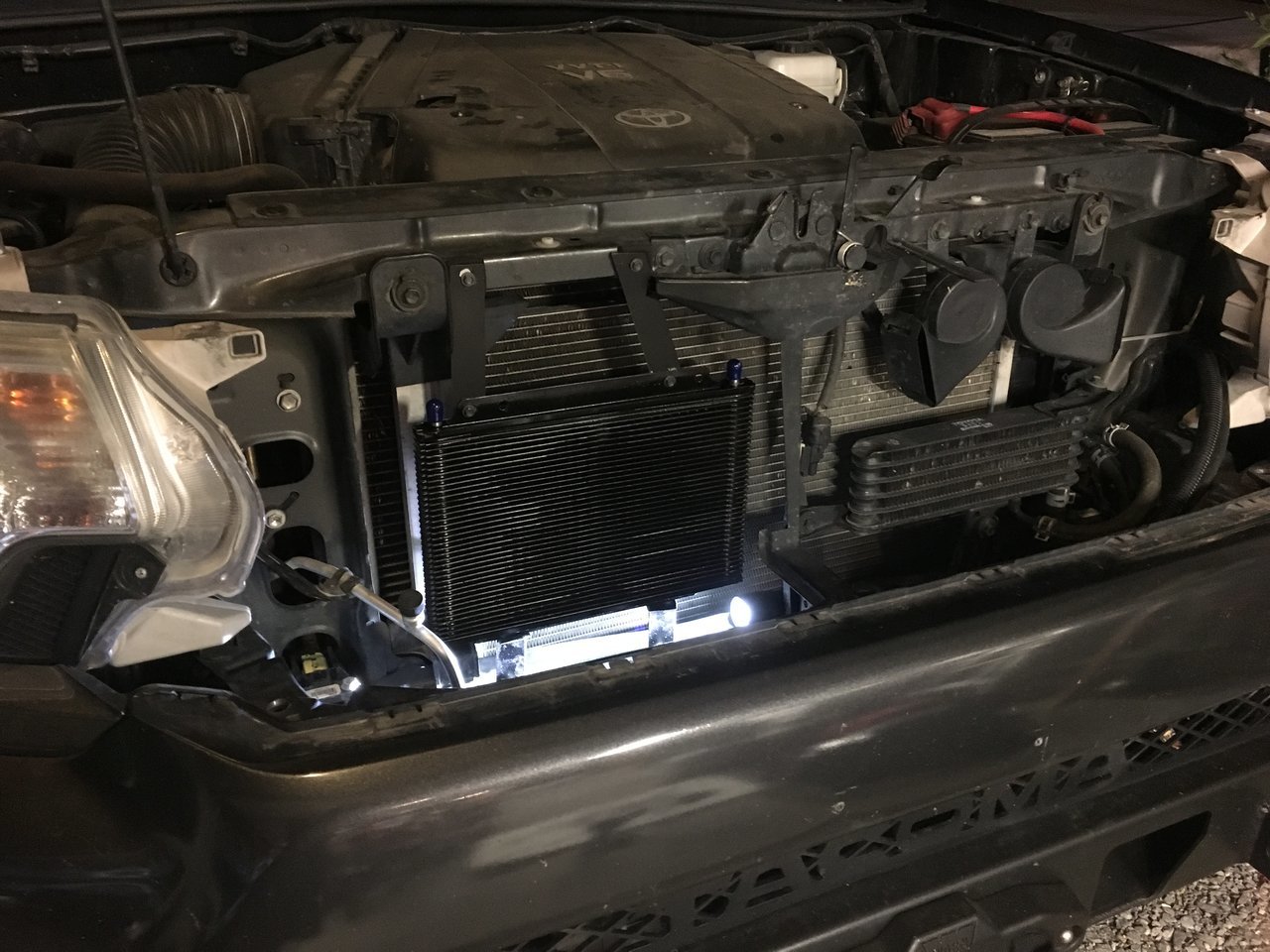

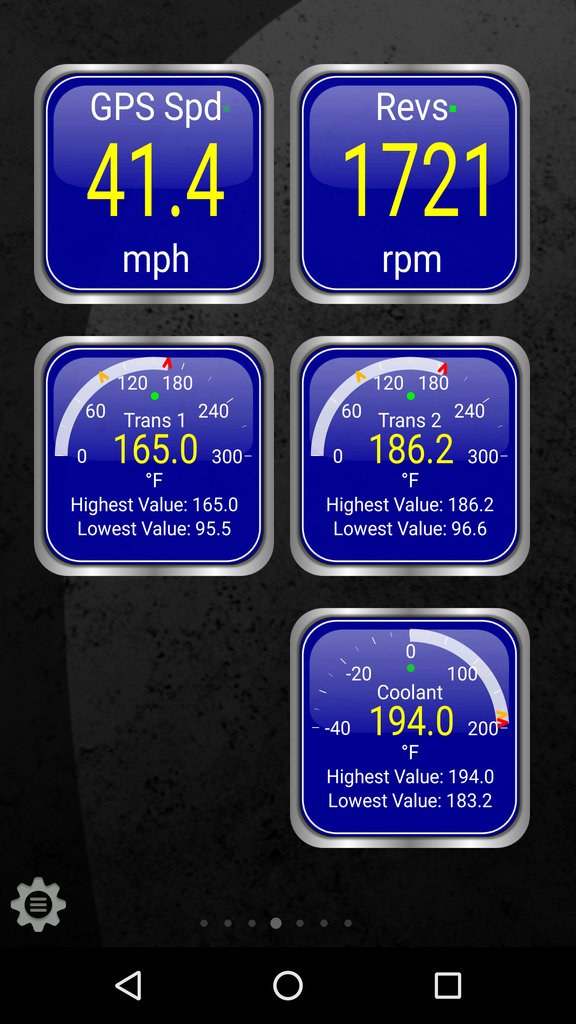

    I added one last month (write up not done yet), and kept the OEM for the time being. I decided to go big or go home and put in a HUGE Long Tru Cool #4590 which made an amazing difference when towing my Travel Trailer in the ADK's - a full 30-40 degree drop. I maxed out at 201 in the mountains where last year I maxed out at 240 or so. Generally there was a 20 degree max difference between my TC and pan temps under heavy load, otherwise it was a 2-3 degree difference. I have to find the screenshots on my other device for standard temps (can't remember them right now). The Torque screenshot was under load on flat roads. Worse comes to worse if it's too cool for the NYS winters I'll just bypass the stock cooler by moving the lines.
    Edit: and thanks to @gearcruncher for his discussion and info leading up to the install. :cheers:

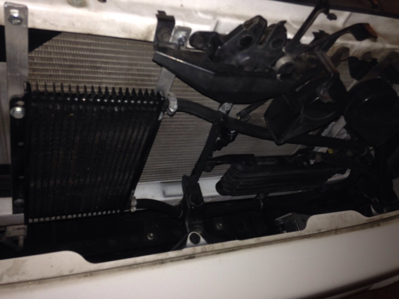

    Kept my stock cooler and added this one. Used 4 rubber coated hose clamps to keep hoses from rubbing. Lost 25 degF ATF temp going up Saluda in NC towing camper.Aux rad.jpg
