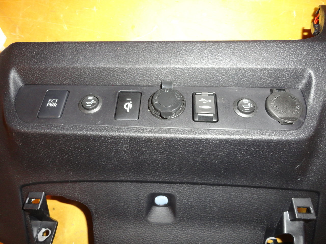

    I added one of those Blue Sea outlets to my lower dash panel when I had it apart to add seat heaters. I tapped into the wires for the 12 volt outlet which I left in place.
    NMBruce and hirod like this.

    seat heaters not popular where I'm from but i do like the symmetry of it. whole thing looks pretty factory to me. nice job.
