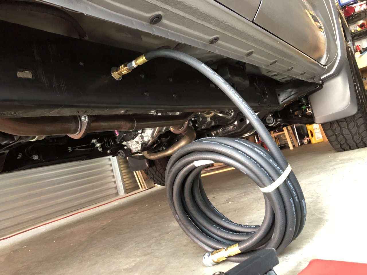

    This pic helped me, the pressure switch goes to a tank or manifold. I used a 2 gallon tank and bolted it underside of bed front passenger side.
    Installed coupler on frame right next to the tank (yeah not getting sliders anytime soon). The compressor itself I put in the bed storage with the expedition essentials mount, totally had to hack up the EE mount, but fit perfect, then locking Mobtown doors.

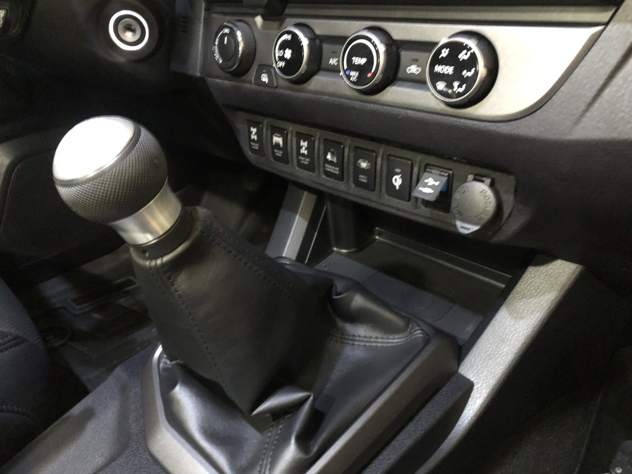

    The power switch I put in lower dash (Meso panel) next to the locker switch. This was a rather long ass install, like several weeks because I ordered parts as I went.

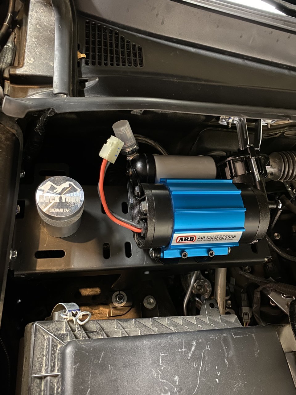

    I mounted my ARB Single in the passenger-side corner using a Slee Offroad bracket. You could fab up a mount I would think
