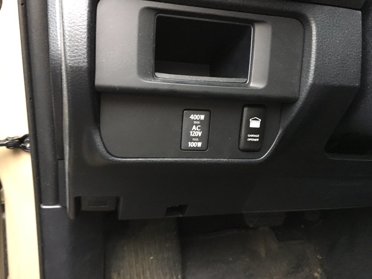

  10. Mar 9, 2018 at 10:27 AM
    #30
    Captqc
    Captqc Well-Known Member
    Mar 5, 2017
    #212458
    5,176
    Tigard, OR
    2017 Tacoma 4x4 TRD AC Off Road
    Yup! Air-On-Board switch.

  11. Mar 13, 2018 at 3:20 PM
    #31
    Ch4rles
    Ch4rles Active Member
    Dec 10, 2017
    #238154
    33
    Houston, TX
    2017 TRD Sport 4x4 DCSB
    How did you do it?
    As in, how did you go about making it work with your garage door?
  12. Mar 13, 2018 at 3:58 PM
    #32
    Captqc
    Mar 5, 2017
    #212458
    5,176
    Tigard, OR
    Fortunately my remote ran off 12 volts so I hard wired it into the truck (no changing batteries). Soldered wires to the circuit board switch connections out to the panel switch. The most amazing thing was after installing the remote permanently it doubled the range!
