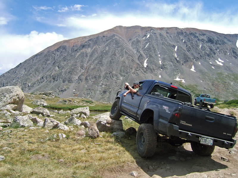

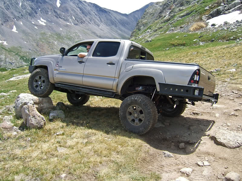

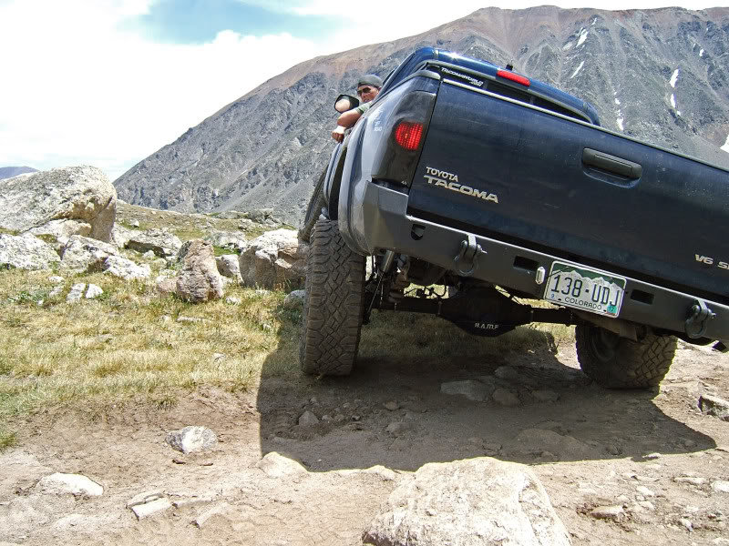

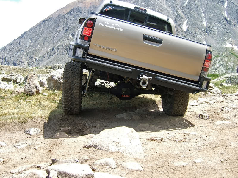

    OK. Went wheeling today and did the best I could to get a good comparison shot with a similar truck. In this case the blue truck is NYCO's. This is how is rear is built so far:
    Rear suspension
    . -Fox 2.0 w/ resi 10" travel
    . -Dakar 3" leaf pack
    . -All-Pro U-bolt flip
    . -Slee Off-road extended brake lines
    . -Wheelers SuperBumps
    My rear suspension is:
    -Billy 5110 shocks
    -All Pro EXPO leaf packs (11 leaves)
    -All Pro U Bolt Flip
    -Wheeler extended brake lines
    -Factory bumps weld to the top plate of the U Bolt flips
    -Shackle flip with stock shackles
    It performed as I suspected. EXPO packs appear to be limiting some movement. Bumps stops stuff short of full shackle extension (can be seen in pic 2). But bump stops stop the stuffed shock 1/2" short of full compression which in IMO is good. Leaves get a little negative on the stuffed side but it is livable. Wheel lifts on the flexed with roughly 1.5" of shock left.
    So for now this set is working as I wanted it to given my EXPO style build up. No binding on the shackles and at some points on the trail the springs drooped in full because we could hear the shackle touch the forward holes in the flip bracket. At some point a longer shackle might be in order but I think I would have to look at some springs with more flex to really take advantage of that. I am impressed with it and believe it or not the ride seems to have improved. I don't know if it is the larger valved Billy's or the shackles but I feel noticeable improvement.
    Great job and great product Travis!

    Thanks for the update. Unfortunately with the different shots its tough for me to actually notice a difference of droop between the 2 trucks.
    I think a good comparison would be if someone used a hi lift and jacked up on one slider till the rear tire starts to leave the ground, then take a picture. Then do the shackle flip and take a picture the same way to actually show the difference it made.
    I have allpro expo springs too so I do feel that they will limit my droop, just like you said.

    Yeah unfortunately the picture taker was 2 different people so the angles were off. Also too I didn't realize we both were on the same part of the rock so technically I should have tried to go higher up on the rock to see if I could extend further before the wheel left the ground.
    I still like the set up and the feel of everything. I will continue to play around with it to see what else I can get out of them.
    The shock was my limiting factor before I put the 5110's on. Now the factory bump stop stuffs before the shock reaches full extension. Which I am fine with because if I trimmed it down I would only put the compressed spring further into negative arch. Am I limiting my droop a bit yes but this is where I want to be with my build. It is a drastic improvement over the setup I had before.
    If or when I decide to go with a longer shackle I will also be considering - the leaf pack, bump stops, and shocks all over again. But this current set up works very well for my wheeling and I will enjoy it for now.
    Yeah I agree the pictures are deceiving since we did not get the same angles on each one. We were too busy having fun and forgot about a tape measure. Looks like I will have to take another trip out 4 wheeling. :D Also it is hard because his truck has the full rear fenders still and mine does not. So it might appear as though my tire is drooping further.
    Let the record state that I am a paying customer for Freelance Fabrication. The pictures I posted up are of my install and my first experience with this set up. They are not intended as a marketing tool for his product. I am sharing my experience so far and I am impressed with what it as done for me. :)
