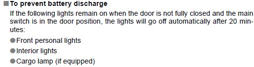

    Try this, put the switch on regular door mode. Lock the doors and walk away. Get the fob away from the truck, wait 30 minutes.
    Then go check it without the fob so it doesn’t wake up. It should be out. I just tested my truck it took maybe 20 minutes or so, I think it has to do with the led bulbs.

    Well, the light does go out. I suspect it's because of the 20 min timer. Unfortunately, if the car is on the light doesn't go out when the switch is in the correct position for the door activation.

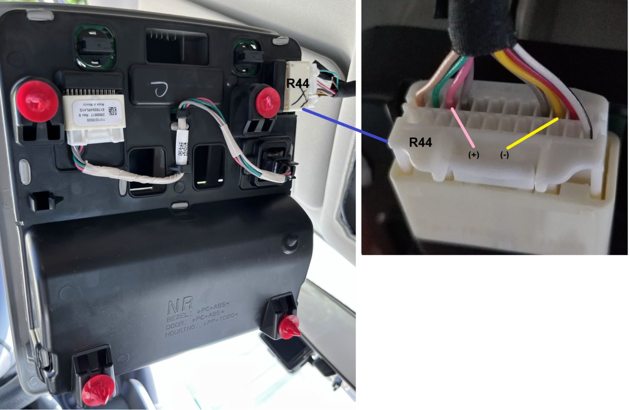

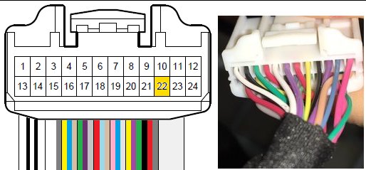

    There's a connector in the overhead console (R44)
    #22 is the ILE circuit (dimming ON or OFF)
    #15 is the power source to the overhead lamps. It's always ON, off after 20 min engine is OFF, unless doors open and close. This would reset to 20 more minutes.
    The connector numbers on the drawing is looking into the connector, NOT the wire side.
    With a multimeter, place probes on these terminals.
    Have someone press the door closed switch at the cab door frame.
    12v ON, voltage drop to 0 when door closed.
    #22 is negative.
    No need to remove the connector
    probes can be place on wire side touching the terminals if you gets these or similar ones:
    If you get 12 then 0, it's only the overhead console PCB.
