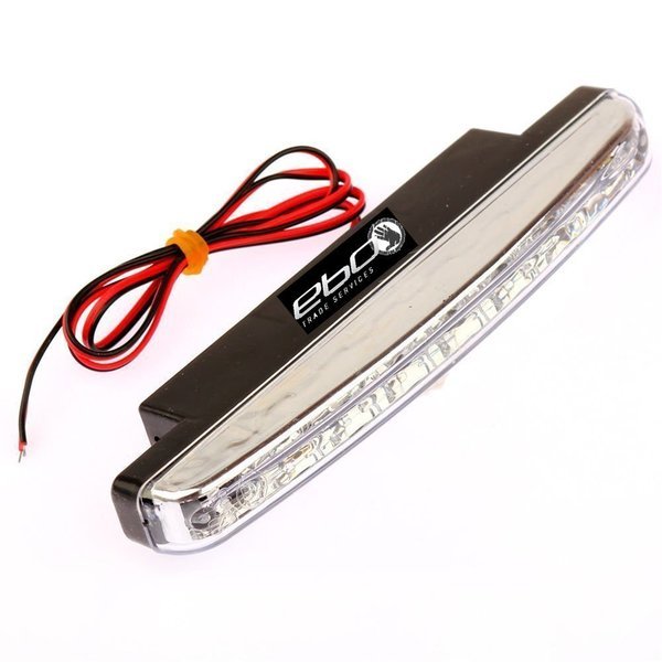

    Can't find my pic but I added footwell lighting to my dome light circuit. I plan to add more to the rear footwell. Good luck OP

    If you find the pic, please share! Can you provide a link where you were able to purchase the foot well lightning?

    Look for my postings. It's in the what did you do to your 3rd gen thread

    I also found this for the foot well lights in your post in the "what have you done to your 3rd gen today" thread
    http://www.vleds.com/all-products/auxillary/strip-lights/pcb-6-c.html
    I've seen some horror stories of ECU's getting fried from not knowing exactly where to tap for a power source. The price is right for the lights but I have zero experience with wiringo_O
    I've seen the guide you've provided but I will seek out a pro's help before any attempts. Thanks for the info! :thumbsup:

    Yeah I've seen those stories too. I took into consideration the factory 7.5A dome circuit and my totalled up my LEDs a little shy of 3.4A of current draw. I've been in the 12V industry for 20 years now so I only use computer/air bag safe tools. Write ups and tapping wires blind are kind of a scary thought.
