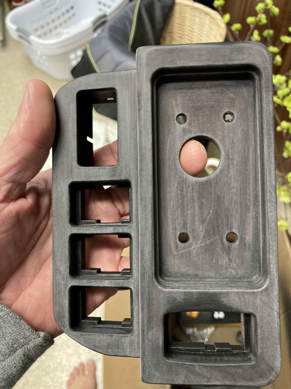

    Replaced my map lights with MESO ultimate map lights. Fun.

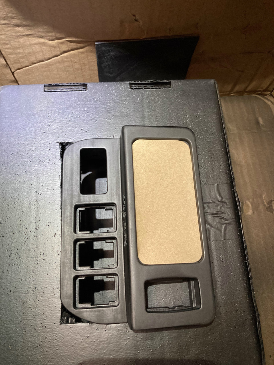

    Painting my MESO driver side cubby which will hold:
    Switch-Pros 9100 | Clutch Start Cancel
    Cargo Rocker | Inverter | MESO puddle switch | RedArc trailer brake controller.

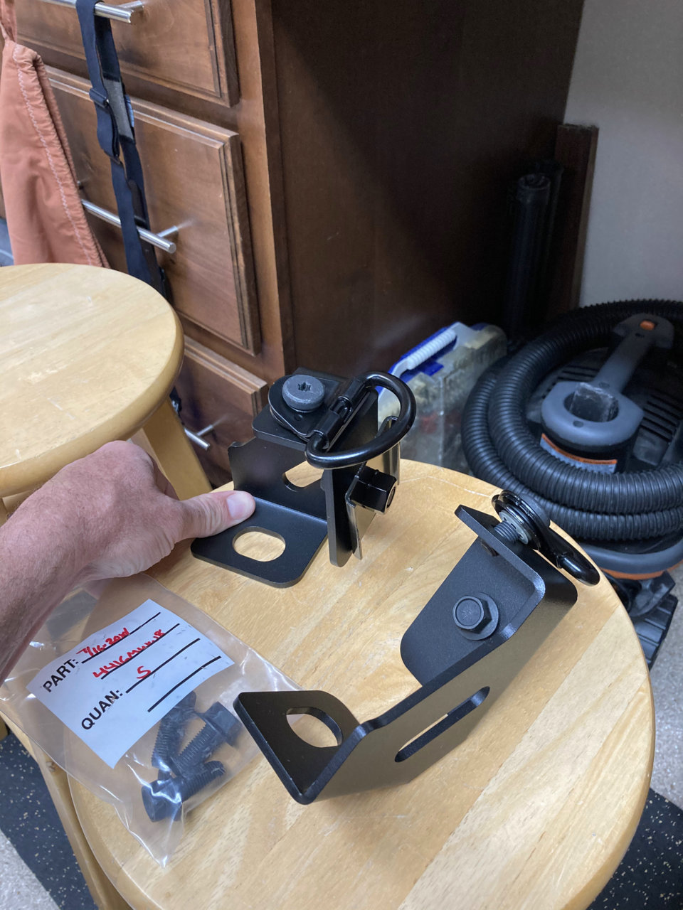

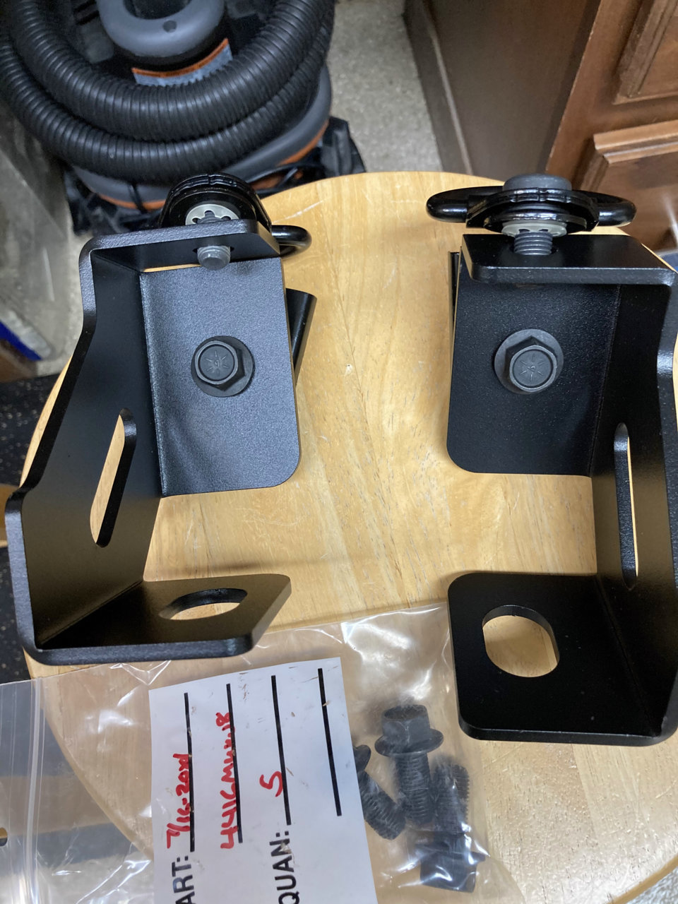

    My mini stiffy setup is almost ready.

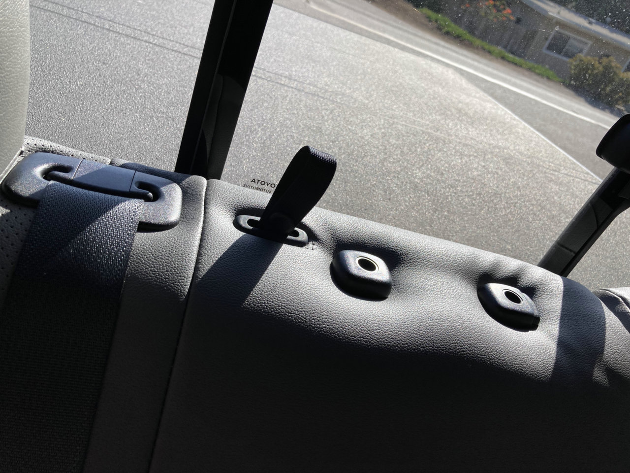

    1 pair mini stiffy
    1 pair OEM D rings
    5 x frame bolt 7/16-20x1 (aka fine thread) — need 4
    2 x 7/16-20x1 hex nuts.
    Drill one hole. Relocate D rings to the top. Use frame bolts and brackets on the tailgate side.
    I’m also planning to install a custom license plate light reverse defeat harness from senor puppypunter while I do this.

  5. Nov 18, 2020 at 6:24 PM
    #65
    caribe makaira
    caribe makaira Well-Known Member
    Feb 13, 2011
    #51121
    11,714
    Caribbean, Puerto Rico
    05 PreRunner TRD Offroad AutoTrans
    Hood Struts, My version Fogs always ON, Map & Overhead Light Mod,
    :popcorn:
    Luv to see the nut side when installed. Bottom and side.
    daveeasa[OP] likes this.

    I was originally planning to recycle my seat bolts since they are fine thread and I figured that would clamp the bedside well.
    then the OEM D rings arrived and they are SAE 7/16” fine thread.
    kinda mind blown on that one.
    Still, rarely have I truly regretted a fastener purchase.

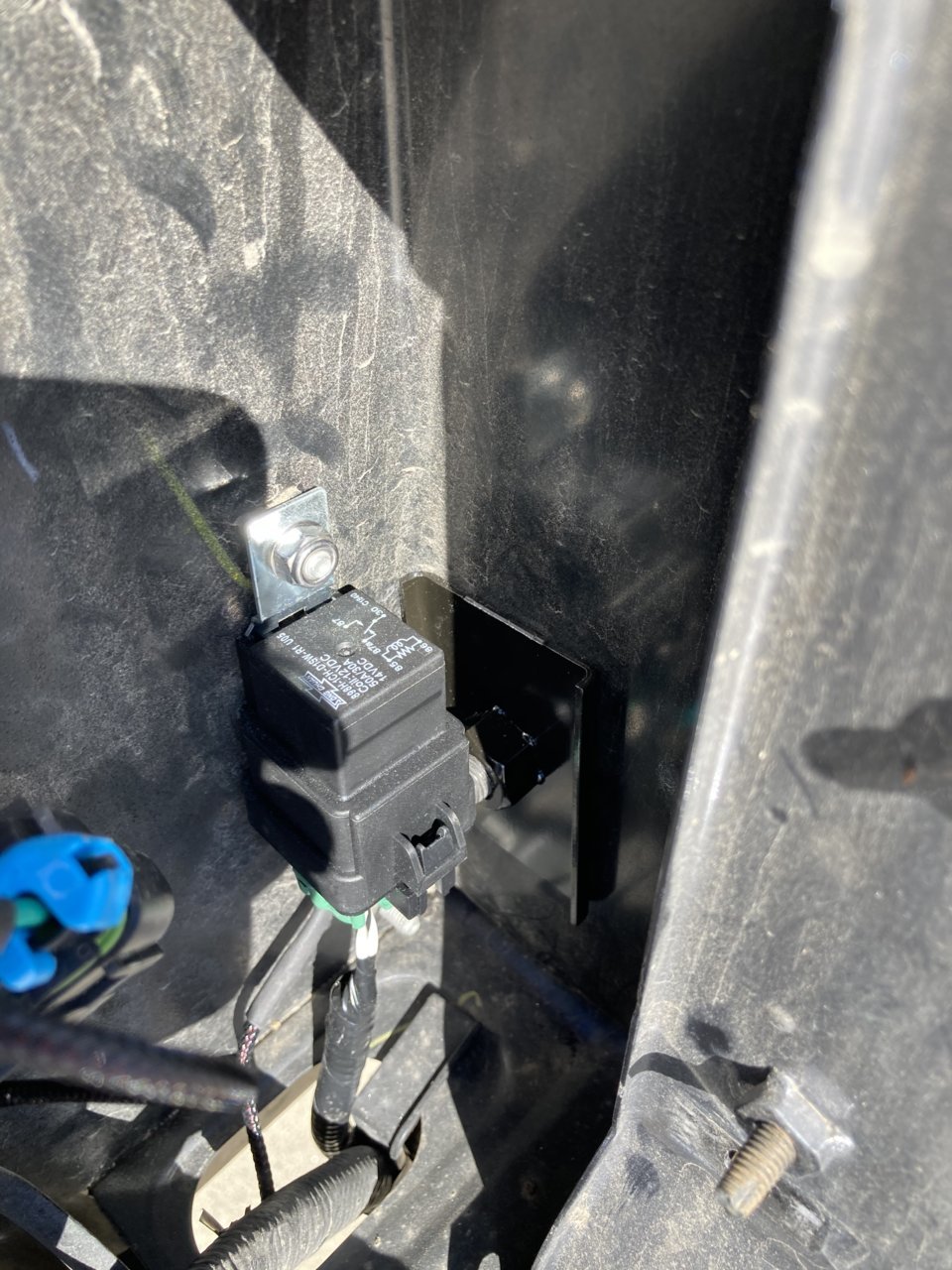

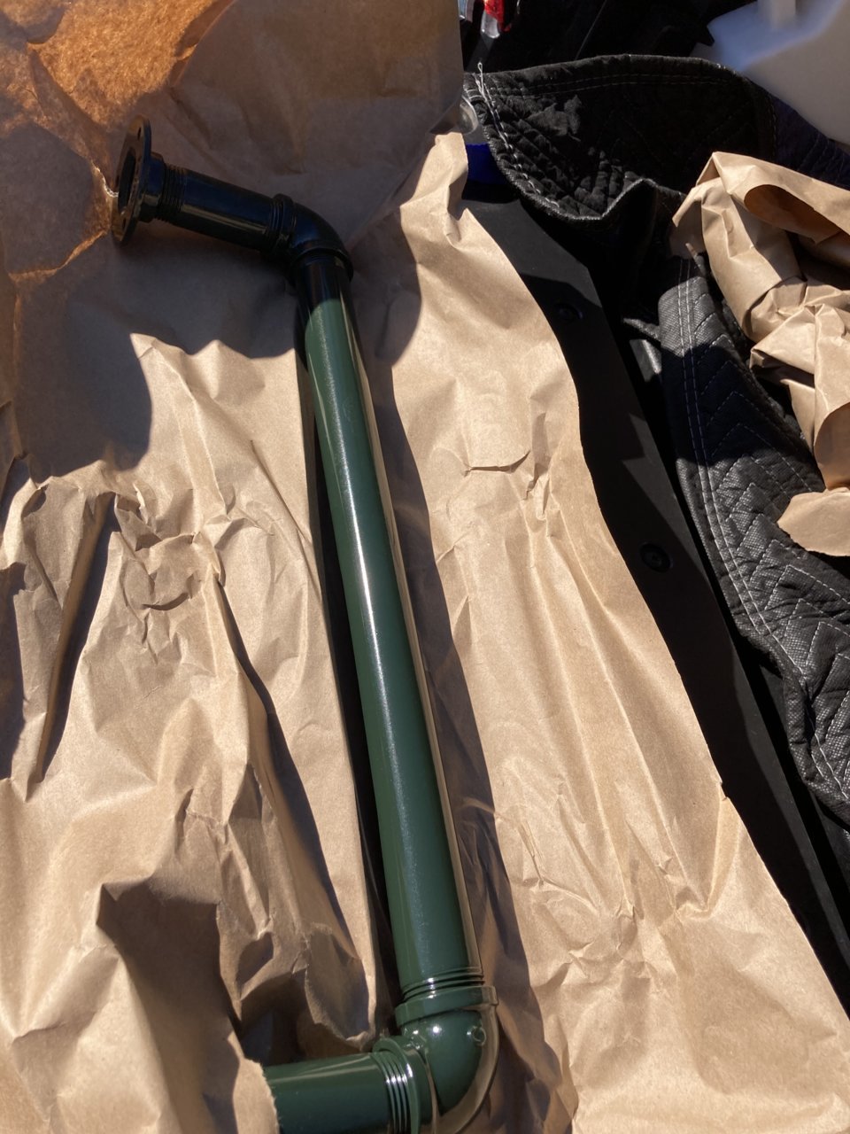

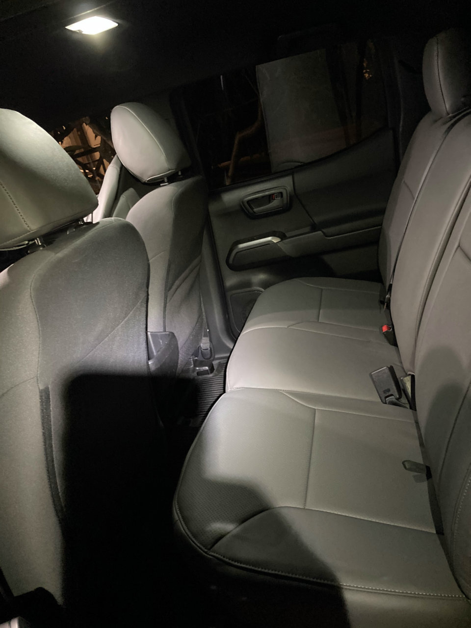

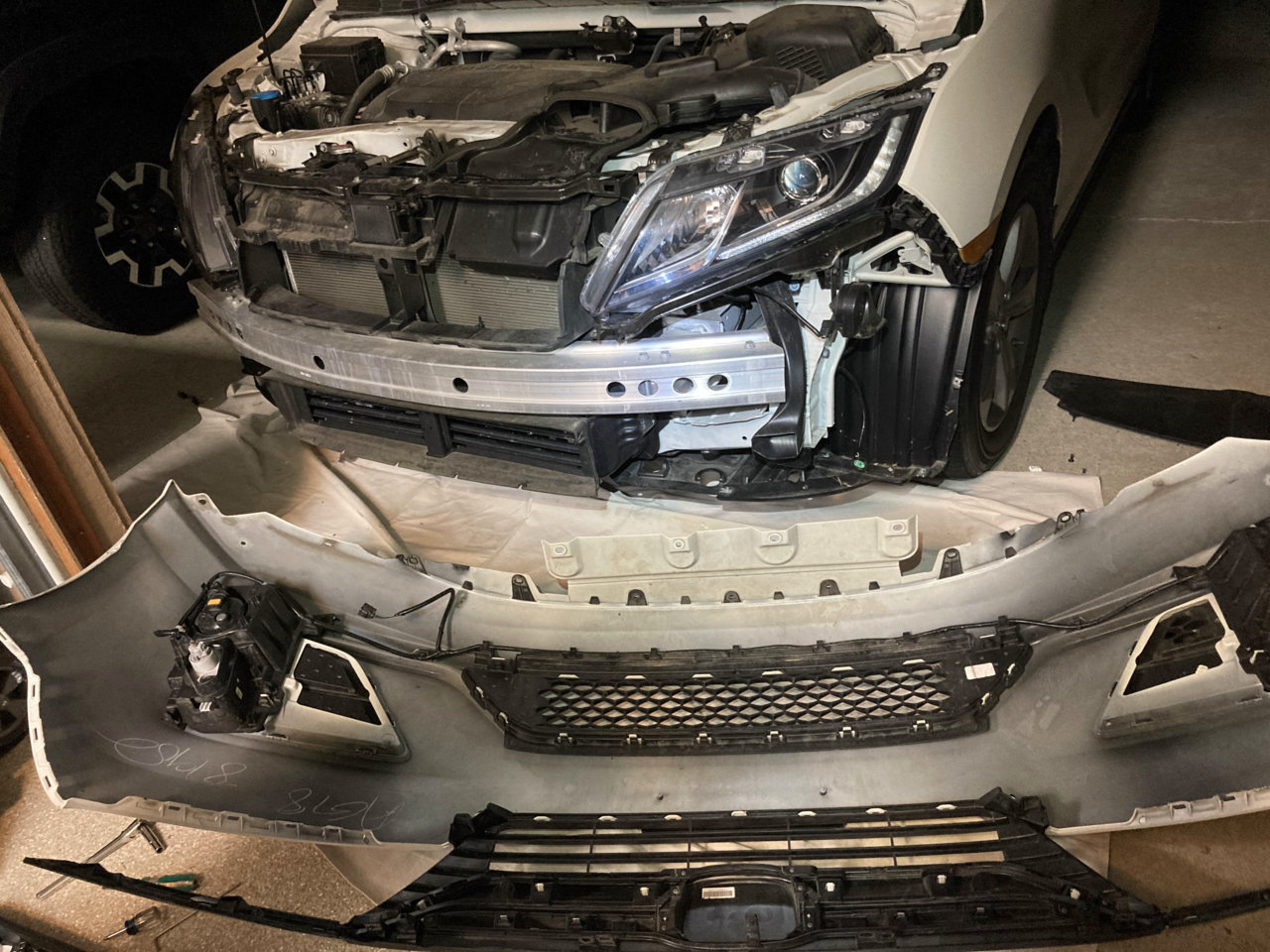

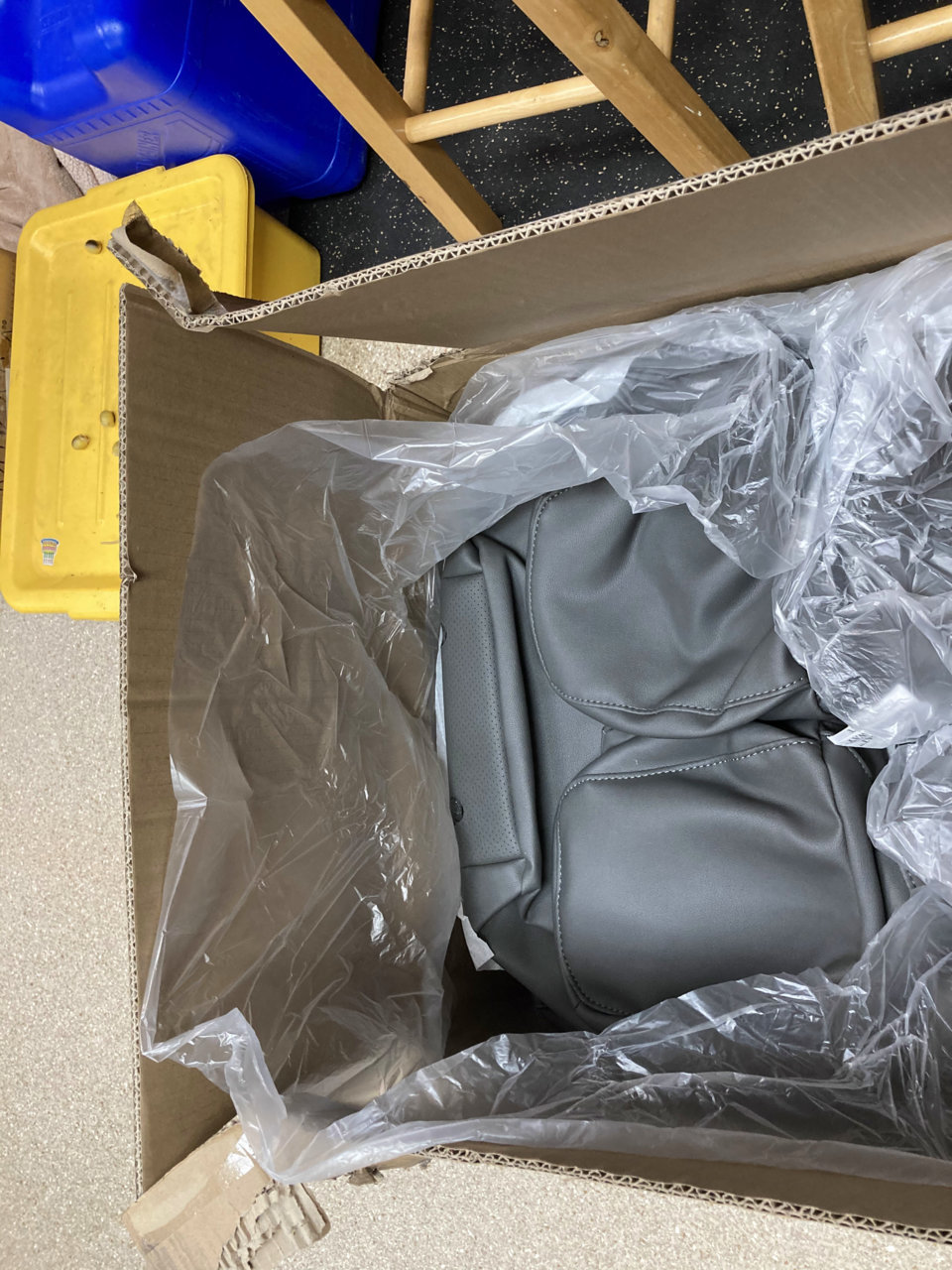

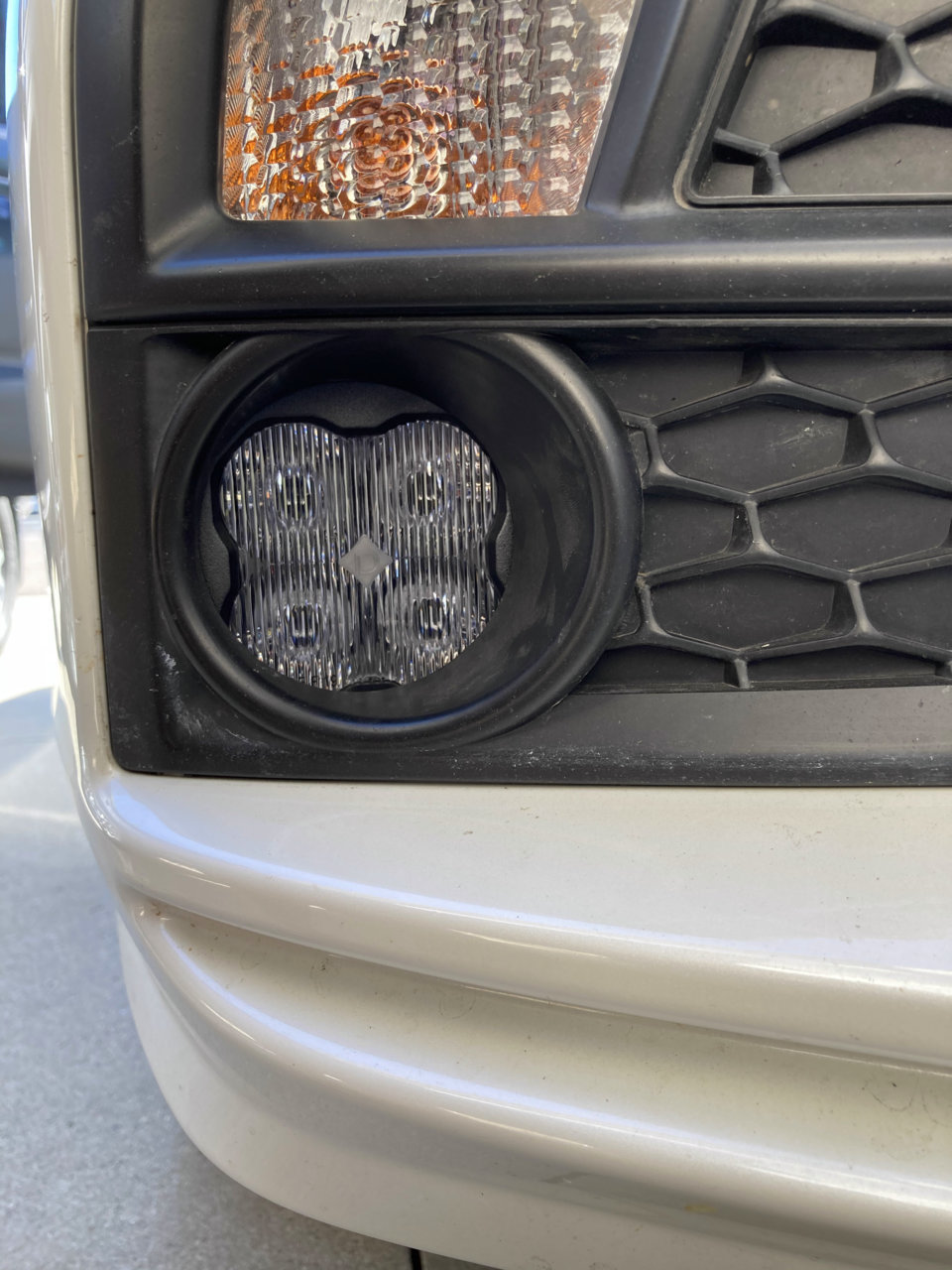

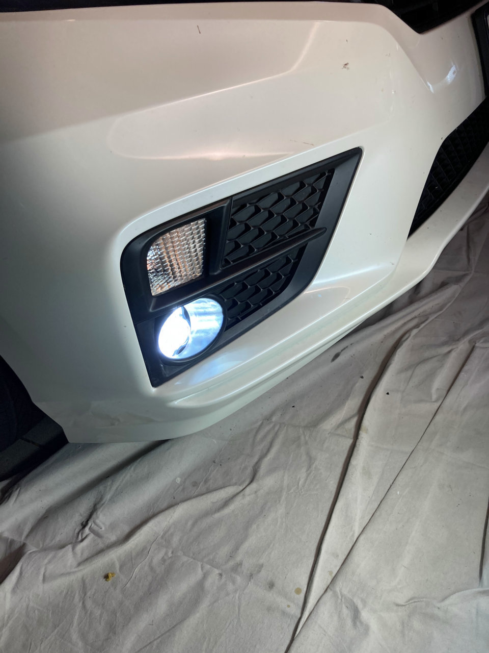

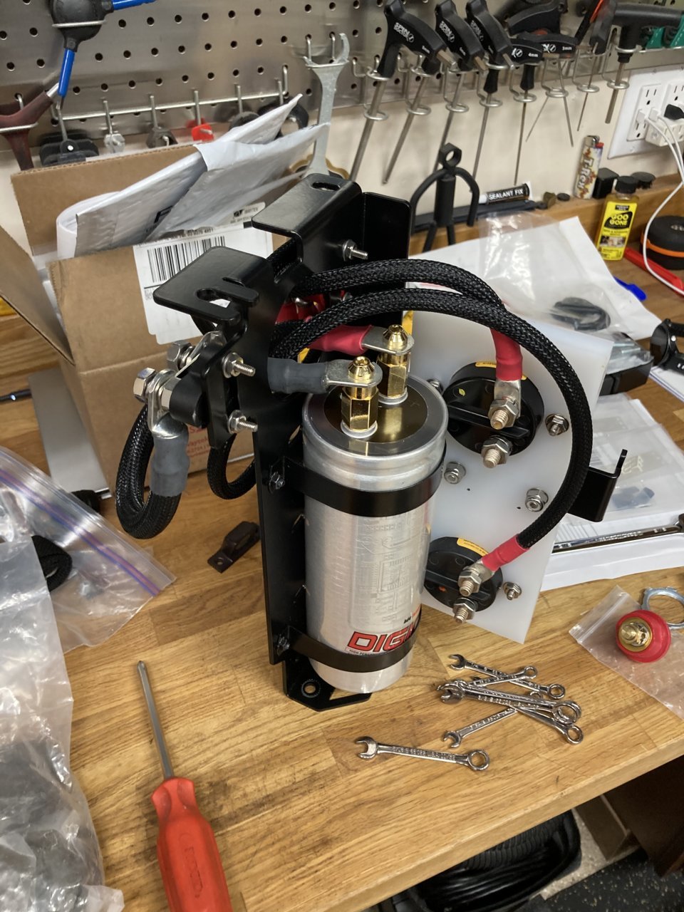

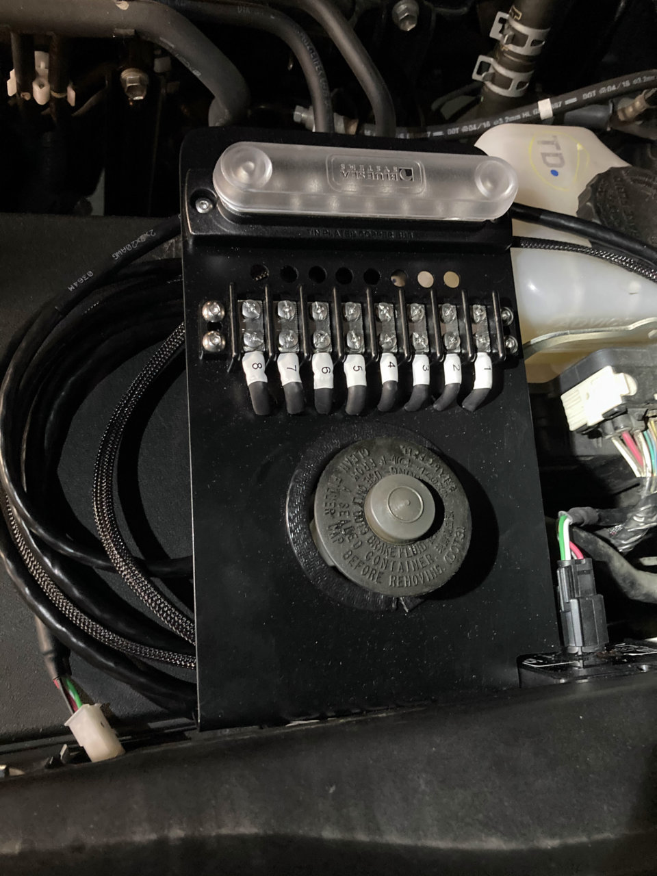

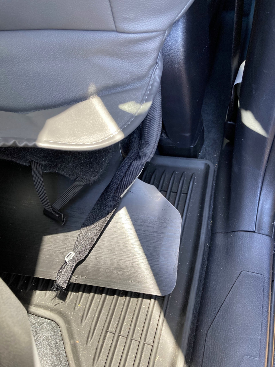

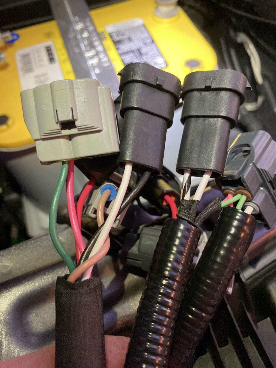

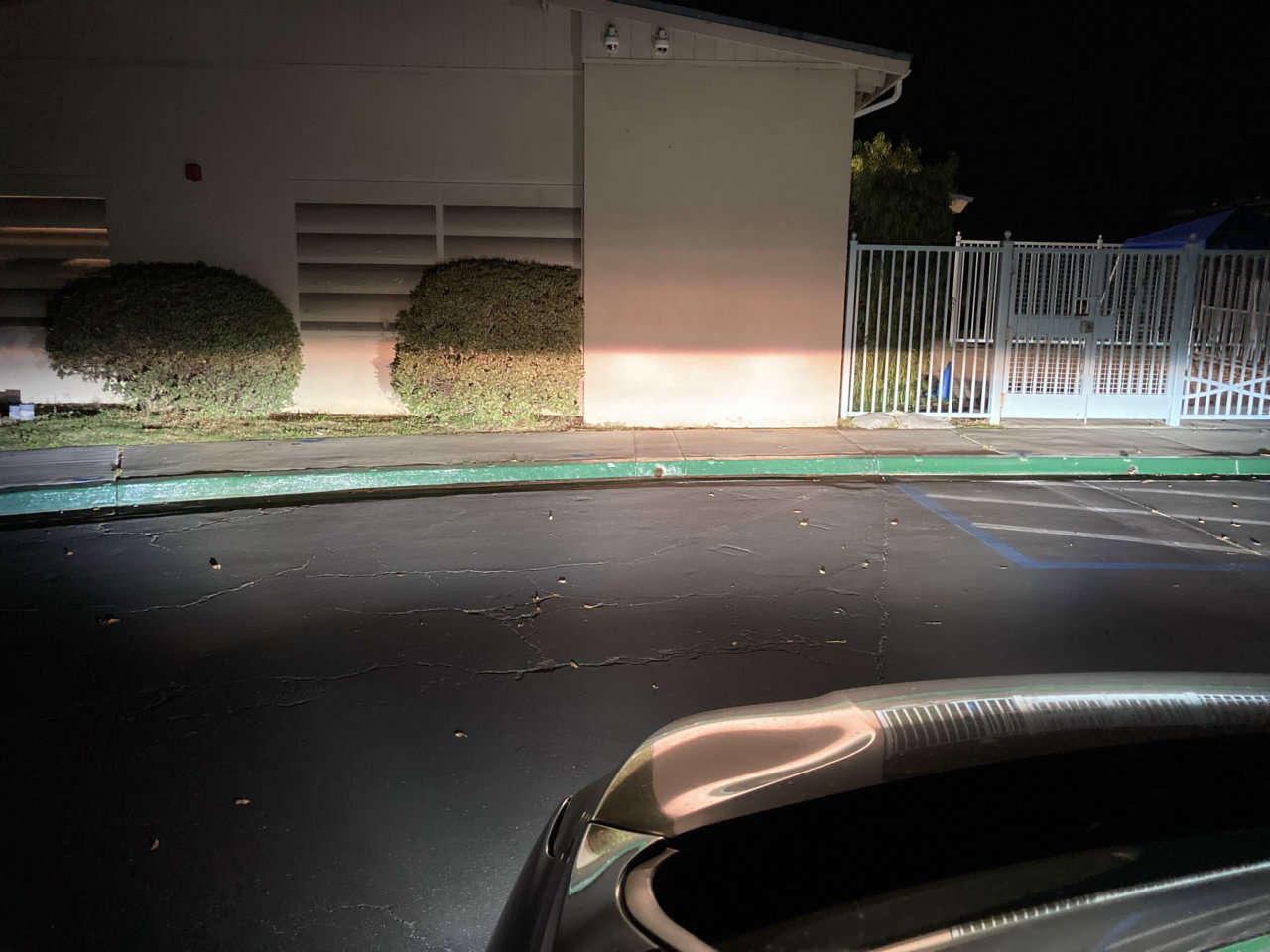

    Latest installments:
    1. Clazzio seat covers with heating pads.
    2. First part of Switch-Pros (power module) and stalled out getting the wire through the firewall.

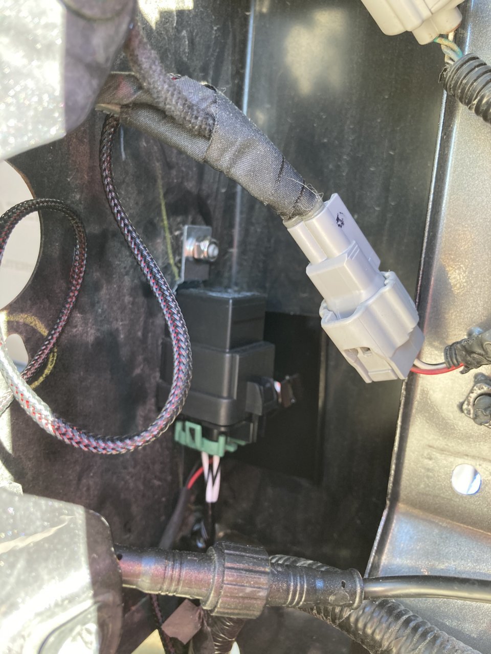

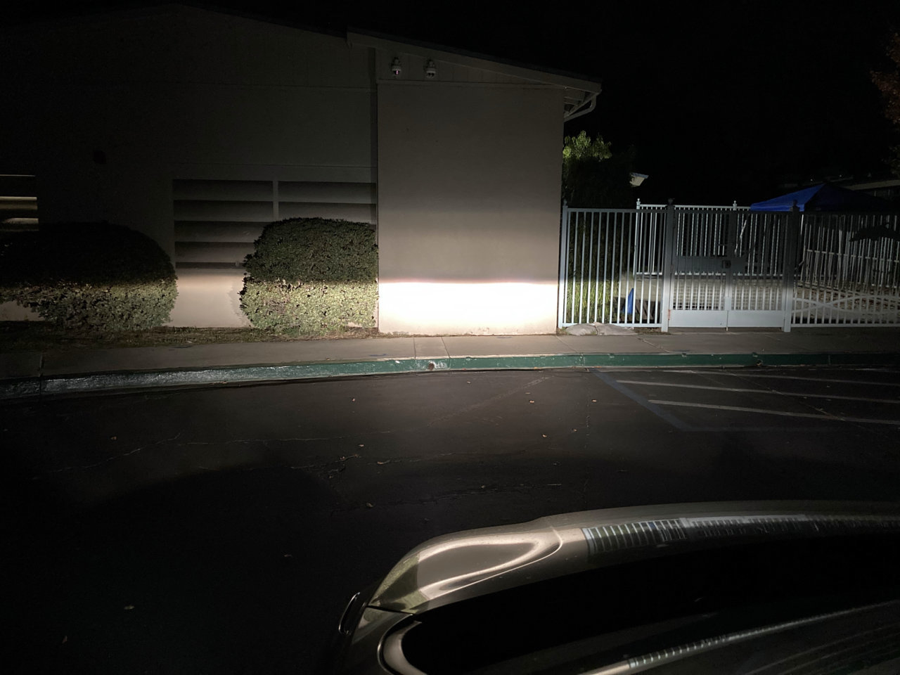

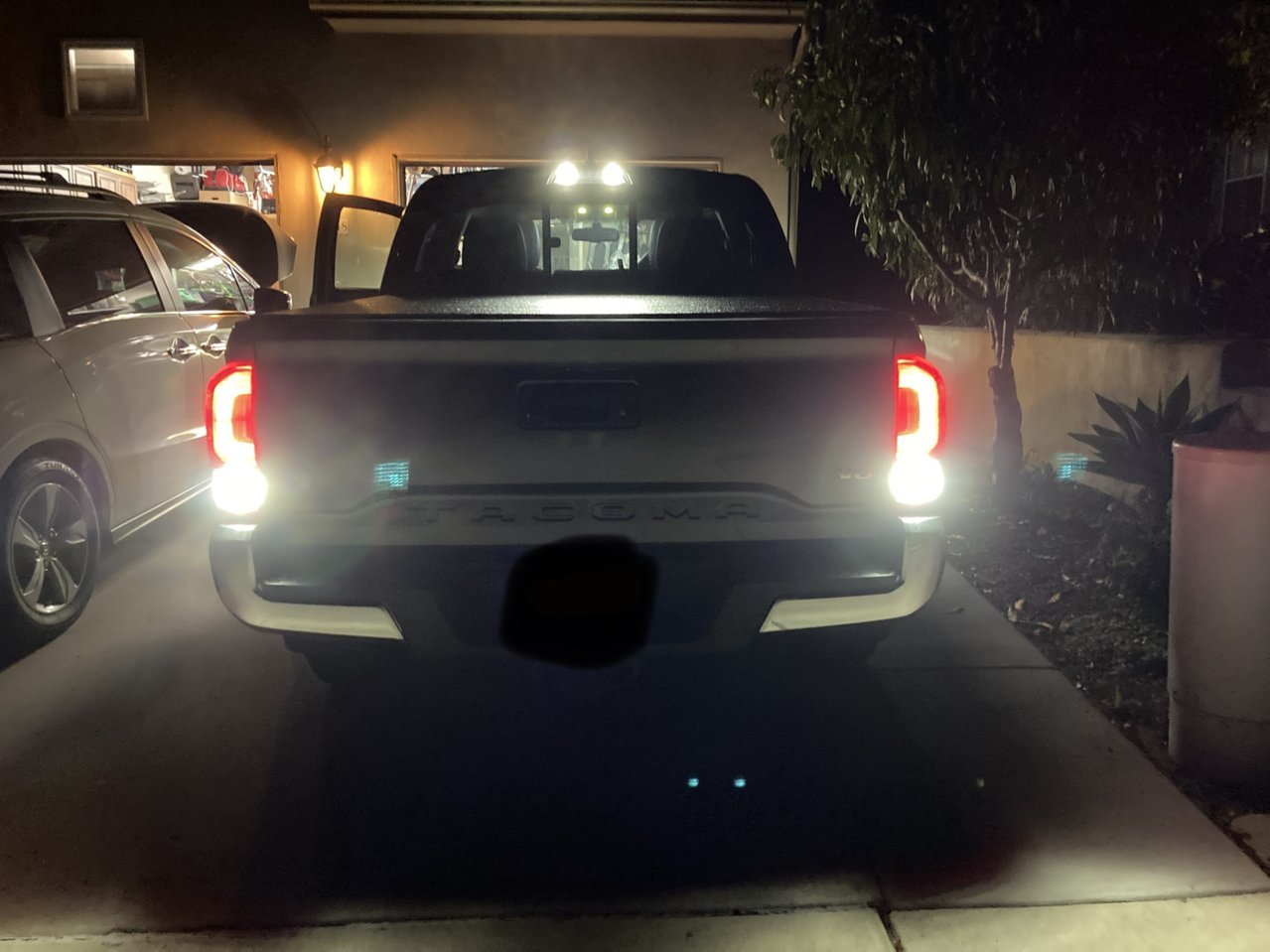

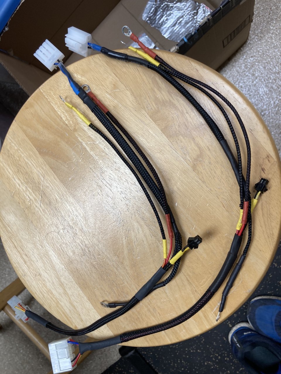

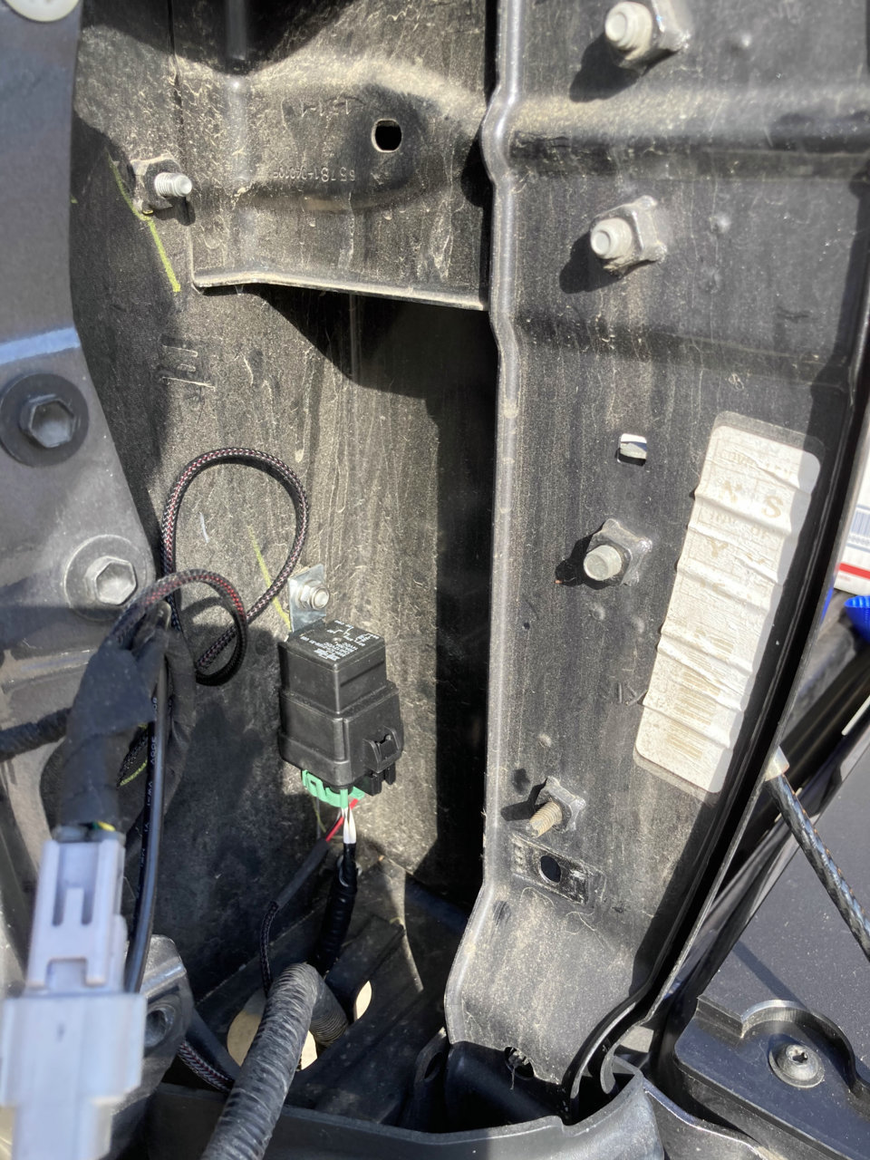

    3. Custom @Puppypunter combo LED headlight adaptor + DRL grille light output
    4. Custom @Puppypunter harness for license plate light defeat when in reverse + DD LED license plate lights

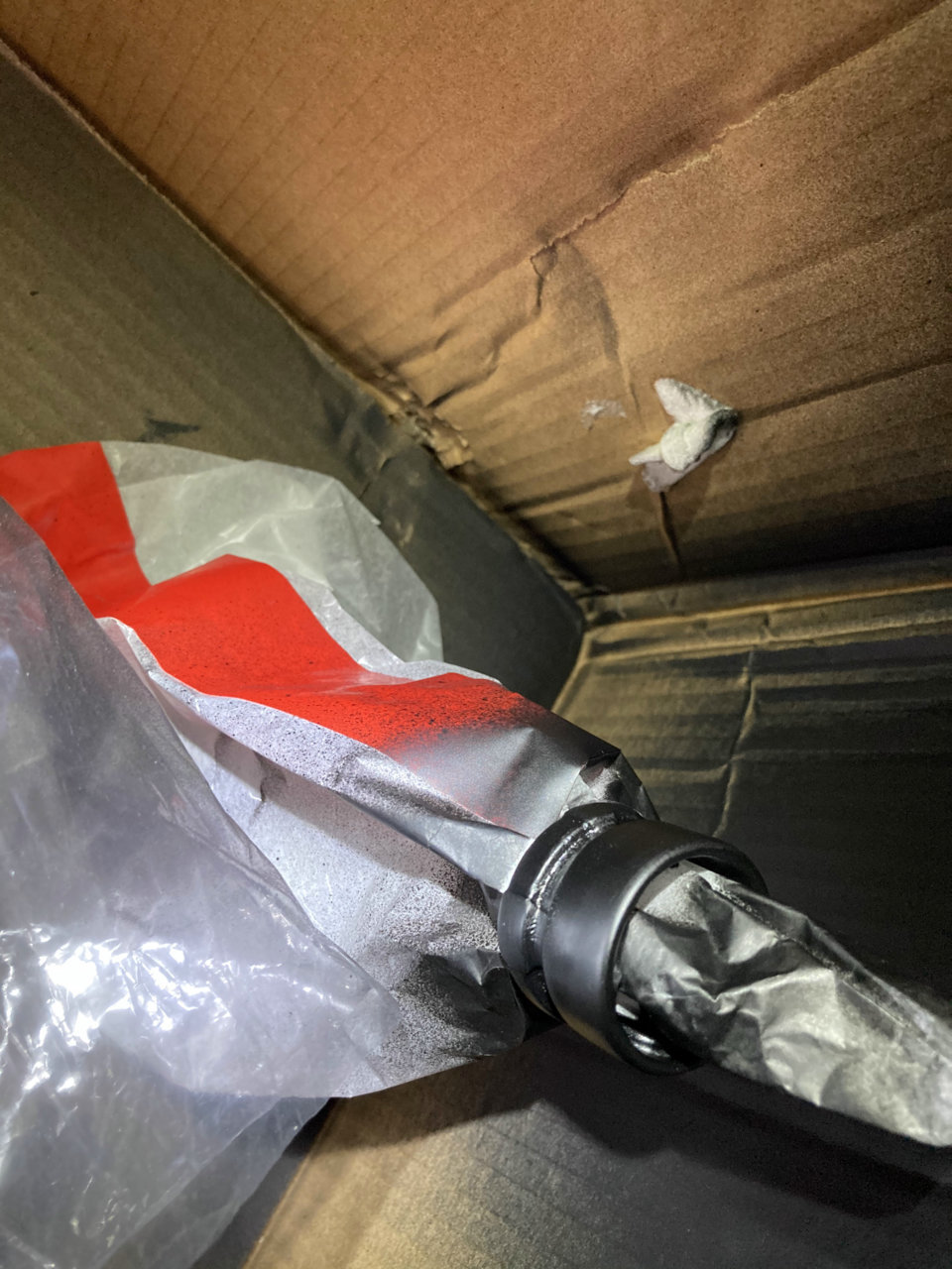

    5. Sand and attempt a better job of painting MESO driver cubby and OEM shift boot collar
    6. Bed stiffeners

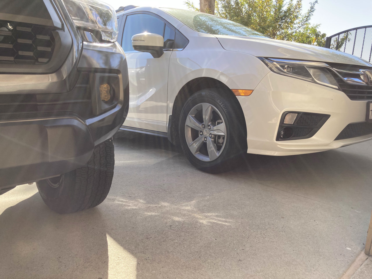

    7. DD SS3 MAX 6000k on the minivan (and minor bumper re-form + JB Weld due to rock crawling incident)
    Plenty of remaining mods including a big budget for time on sound deadening and puddle pods / door speaker install.
    Comments from my 2 fan club members always welcome :)

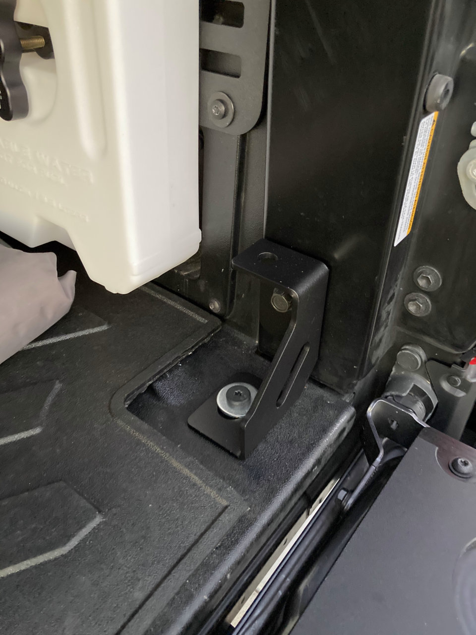

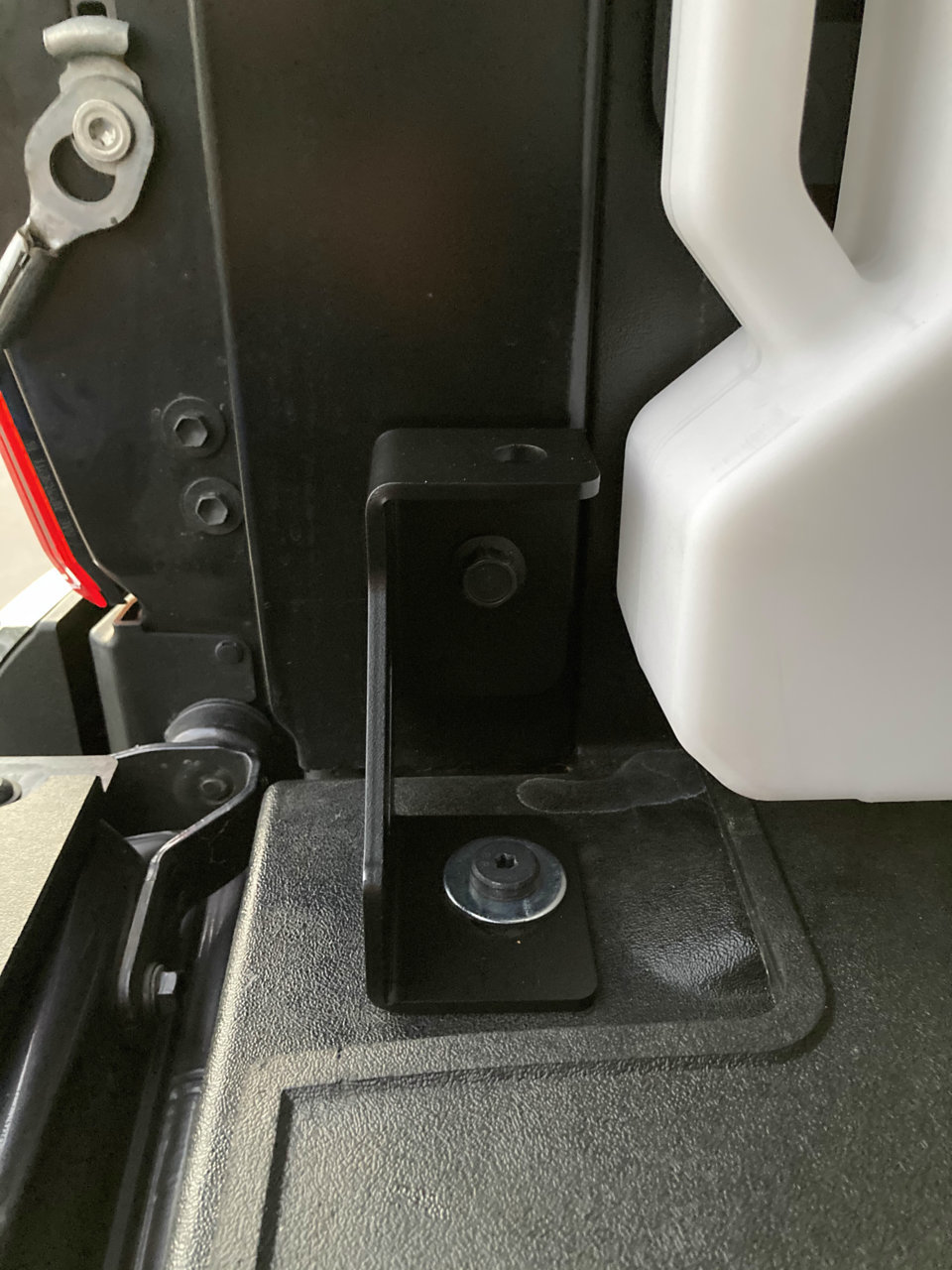

    More photos of the brackets on the taillight side of the stiffeners.
    274432B6-09C5-4F70-AEA1-3A6F4DA8740A.jpg 6B94E28B-4847-4E64-A6E1-1BE444CB07BB.jpg
    And my low tech anti rattle temp fix.

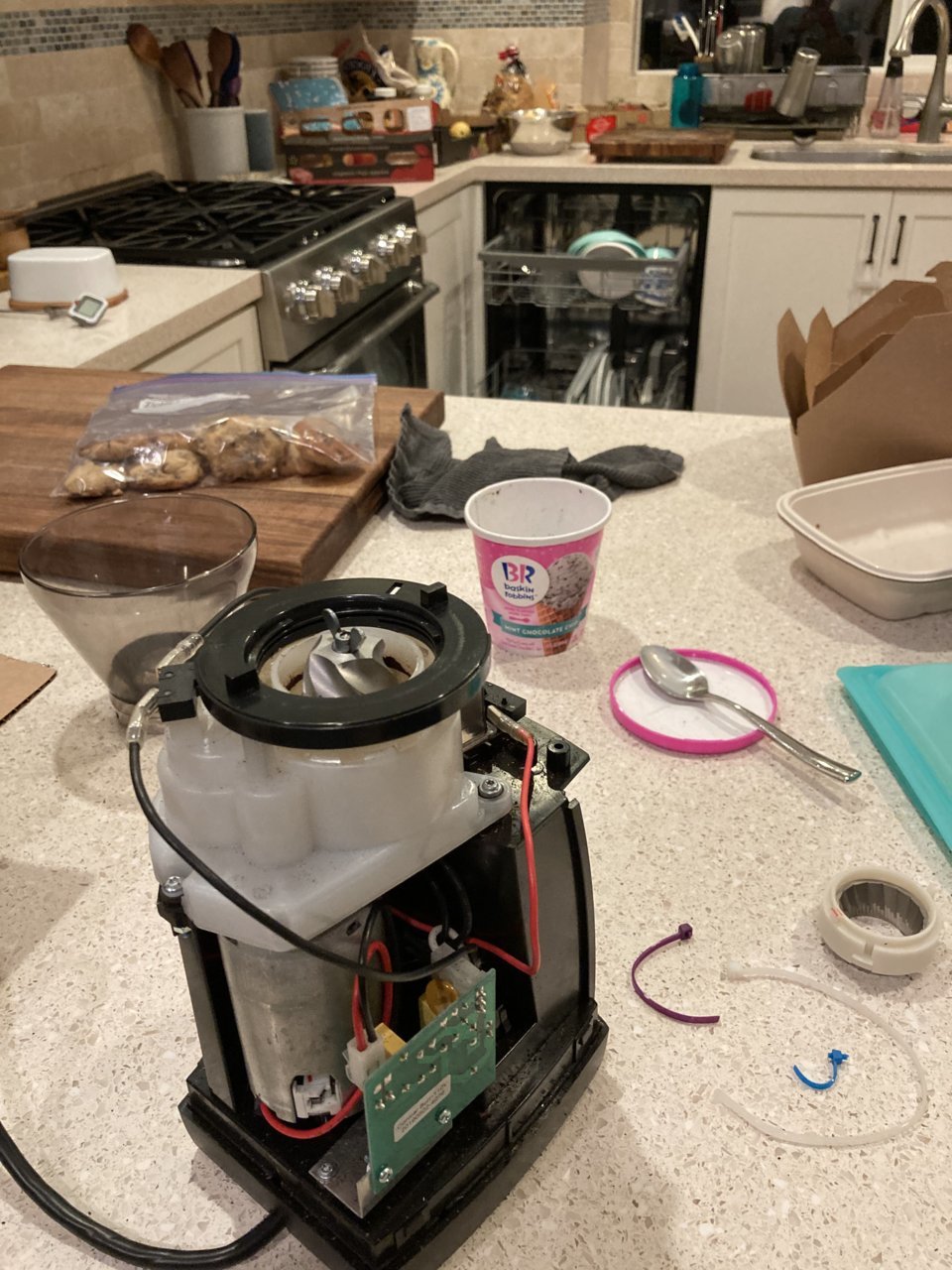

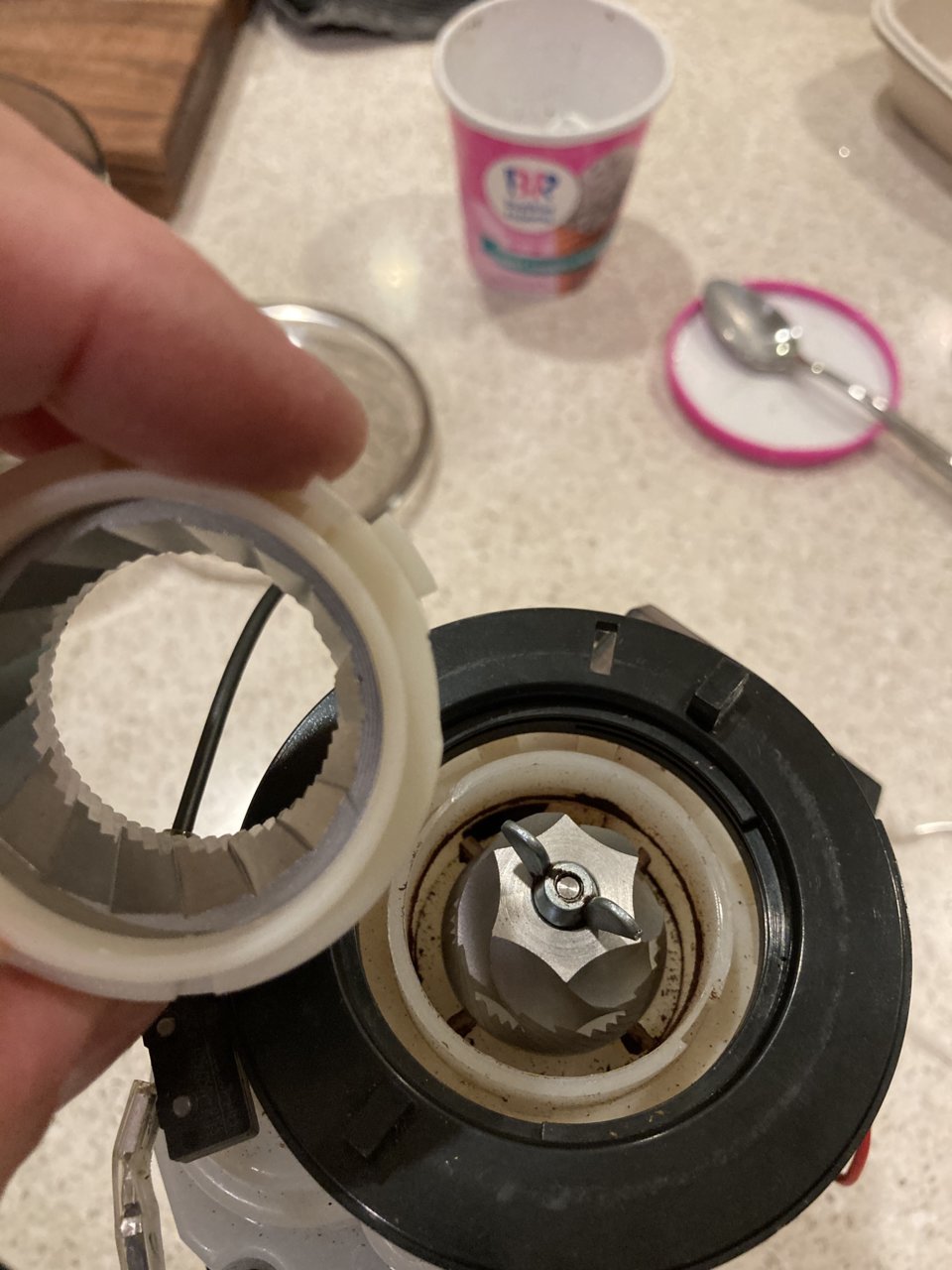

    Coffee grinder mod complete. Newer (higher quality) burrs on basic Baratza Encore grinder. Wife increasingly annoyed as I had to order a new driveshaft after being unable to separate the old lower burr from the original shaft.
    B100E608-6FEB-4BCA-BEF4-7DD8779F07D4.jpg 8D447140-E050-45FC-96B8-41DF8C6FE89D.jpg

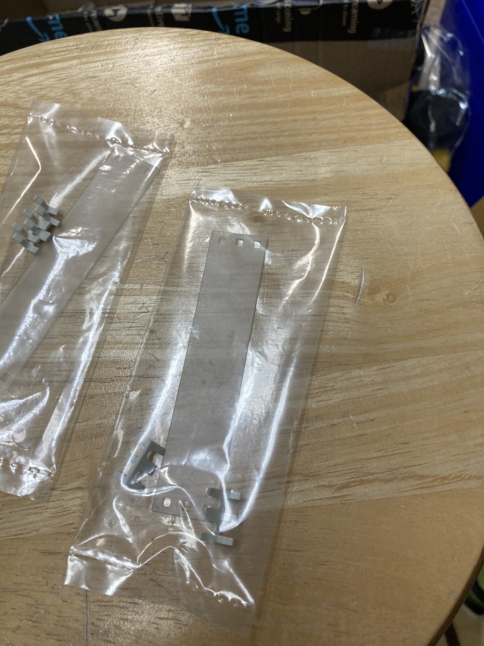

    Found these. Will try to get them attached. Might help a little but of course not waterproof at all

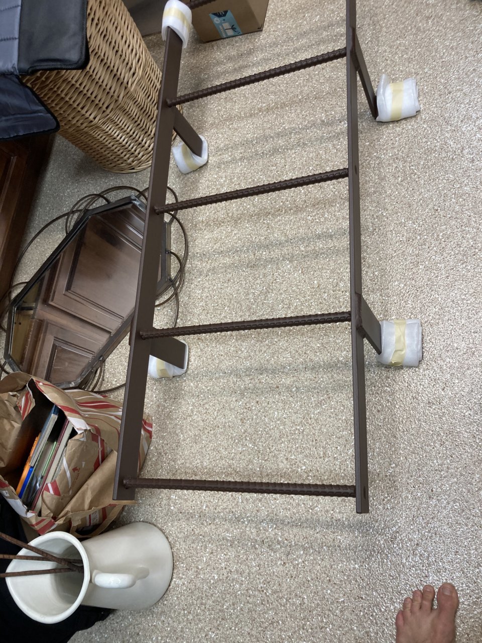

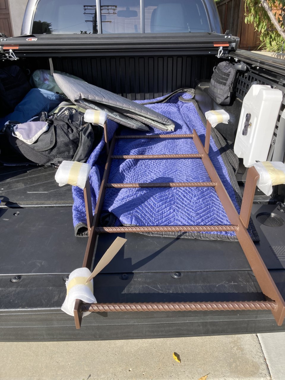

    Not truck related but I got some metal powder coated for the play structure and house ladder.
    2F8EC5AA-C4DD-4737-AF25-352A5A7C742F.jpg 4C3CCE32-CC23-4342-96D5-8EDD68A680D6.jpg FFF31EB1-2C1B-4B1C-8F6C-DA66D838FAE6.jpg 58B340E1-CA08-4EAD-82C0-BC4A06334230.jpg

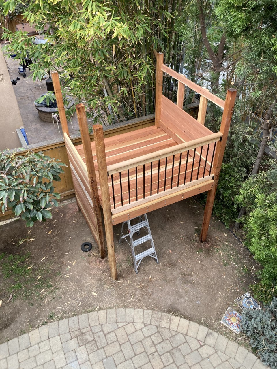

    Updates:
    Coffee grinder mod is proving well worth the time and effort. Much improved grinding experience with new burrs.
    Very minimal progress on the truck. Picked up a nail and got that tire patched so switched to my spare and thus the 5 tire rotation begins. Forgot to write down the number from the TPMS on the spare so I need to go back to DT to ask them to scan for me so I can update via TS. It’s reading the spare right now which isn’t so bad, really wish the display showed all 5, would be so nice...
    Very slow progress on wiring. Truck in pieces for the most part, just barely driveable. I did get some cleanup braiding and heat shrinking done on the seat heater harnesses though so it’s now time to connect them and see if it all works.

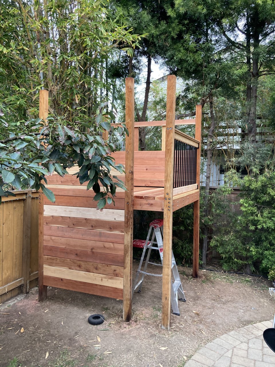

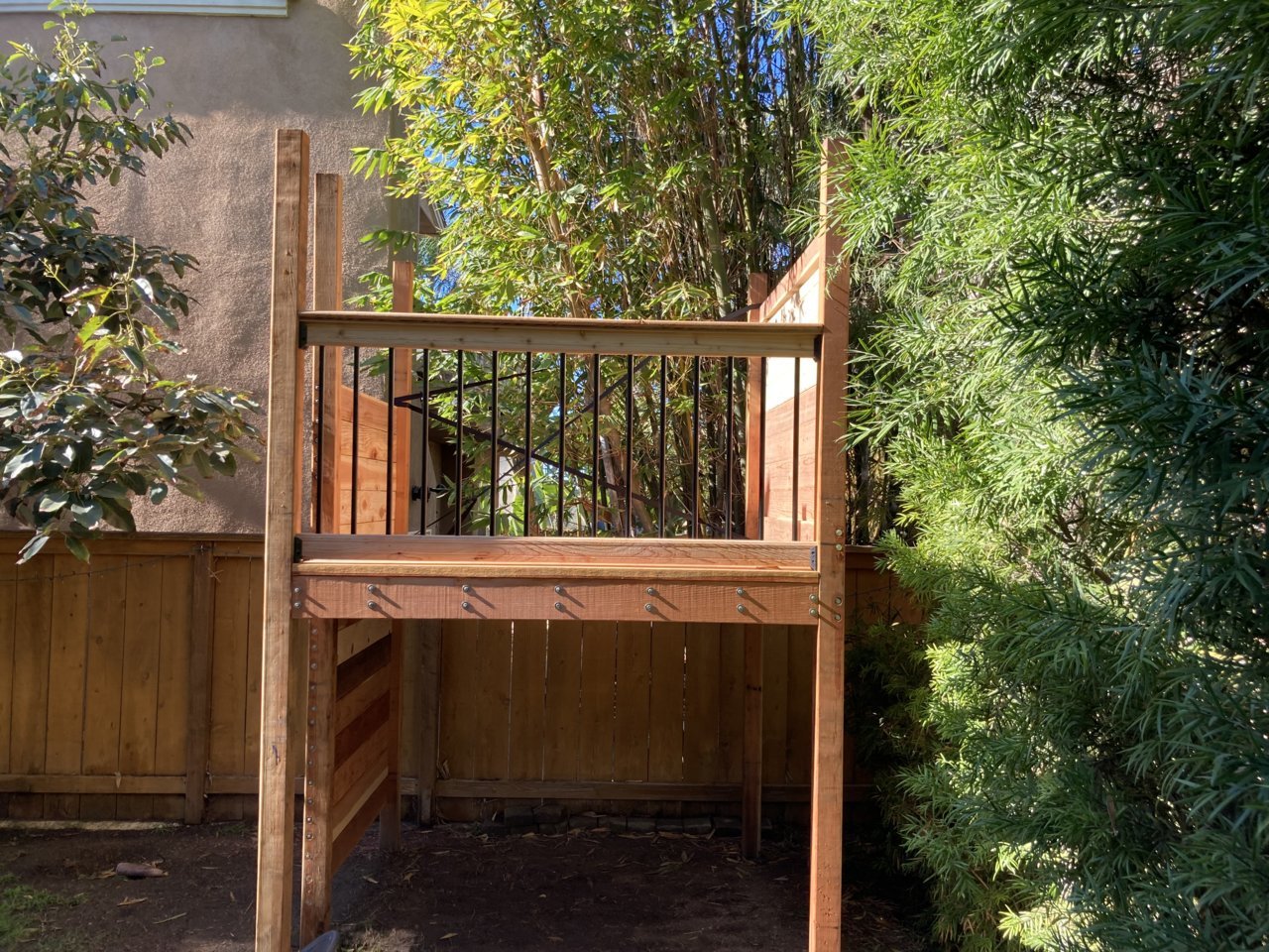

    But I’ve been cranking on the play structure and it’s nearing completion pending arrival of some remaining fasteners and a 2nd railing.
    2A5352C1-A7F9-4DE0-BE2B-946F2DF198E9.jpg 5DD237FA-26B5-435D-AC80-6D9A243F0E22.jpg A80ACFF7-4322-4EC1-9A31-3F505AE2E8B5.jpg
    8CE9EDF0-B0DD-476F-8A69-D65ECCC5FB67.jpg 0860521D-5075-4F8F-8555-2A3D773E97D4.jpg
