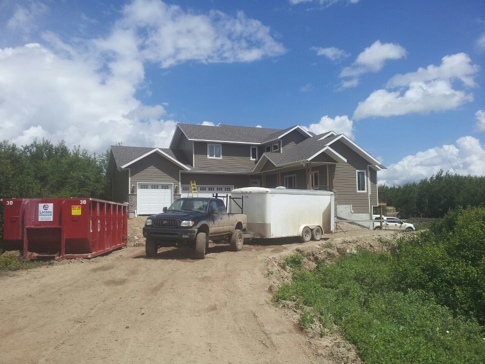

    Alright i'v read the threads, got mixed reviews so i want some opinions.
    I read the towing bible and installed a tranny cooler as well as brake controller in my 01 extracab 4x4,
    i Pull a 16x7 foot tandem axle enclosed trailer weighing in at 2490 pounds which isnt to bad but i Have a 1000 pound seamless eavestrough machine in there with a coil of steel on it that weighs 541 pounds.
    So im already at 4000 pounds with out ladders and tools and what not so id say right around 4500 pounds loaded.
    I have some work to do about 2 hours away and im wondering if its safe to pull the trailer that far ? its pretty flat the whole way.
    the truck has a 6" lift as well as 265/75 16's
    here is the outfit

    yes sir its a v6 and the tongue weight is 250 but loaded is say 300

    Tongue weight is 500# for the V6

    with the trailer at 4500 and 300 tounge, its gonna wanna dance a bit on ya.

    yea the trailer did start swaying once when i had bags of cement loaded in the back. so should i load all my stuff in the front of it?

    Try just forward of the axles.

    well you know you have a load behind you, just be careful.
    I pulled tag-a-longs for years, and the most stress is when you take off and stop. be mindful of whats going on, and take it easy.
    with it being summer make sure your tires are in good shape and proper inflation, make sure the truck is in tip top shape.
    one thing everyone should know, and I was told this by a Dexter Eng. is that trailer axles are rated at load cap. at 55 miles per hour.
    so for every 10 miles per hour faster you LOSE 10% cap.
    now for every 10 miles per hour slower you GAIN 10% cap.

    I know I'm a little late, but future help.....60% weight up front. Rest in rear.
