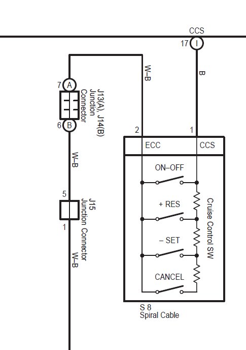

    Since the only real responses I got were either 'I prefer constant speed cruise too,' and 'why would you want such a stupid thing?' yeah, you're probably right. The only option I likely have is wiring up an Arduino to trigger the 12V+ line that comes out of the cruise stalk for 3 seconds on start-up. It would be a pain, but the result would be the same, plus I'd get 'always-on cruise' which is a feature I have really missed since I sold my 95 Yukon.

    I think I found my method of attack. I believe all I need to do is supply 12V+ for 3 seconds to the black wire leaving the cruise stalk.
    Will still take some testing to trace it into the steering column/dash before it gets to the ECU, but I think it's doable.

    I think you just need to make contact between the Black wire and the White/Black wire. The white/black wires in our trucks are generally Ground. The Black wire you speak of I believe already has a voltage on it from the CCS.

    Op can you get a wiring diagram of CC ? What happens if you cover the sensor
