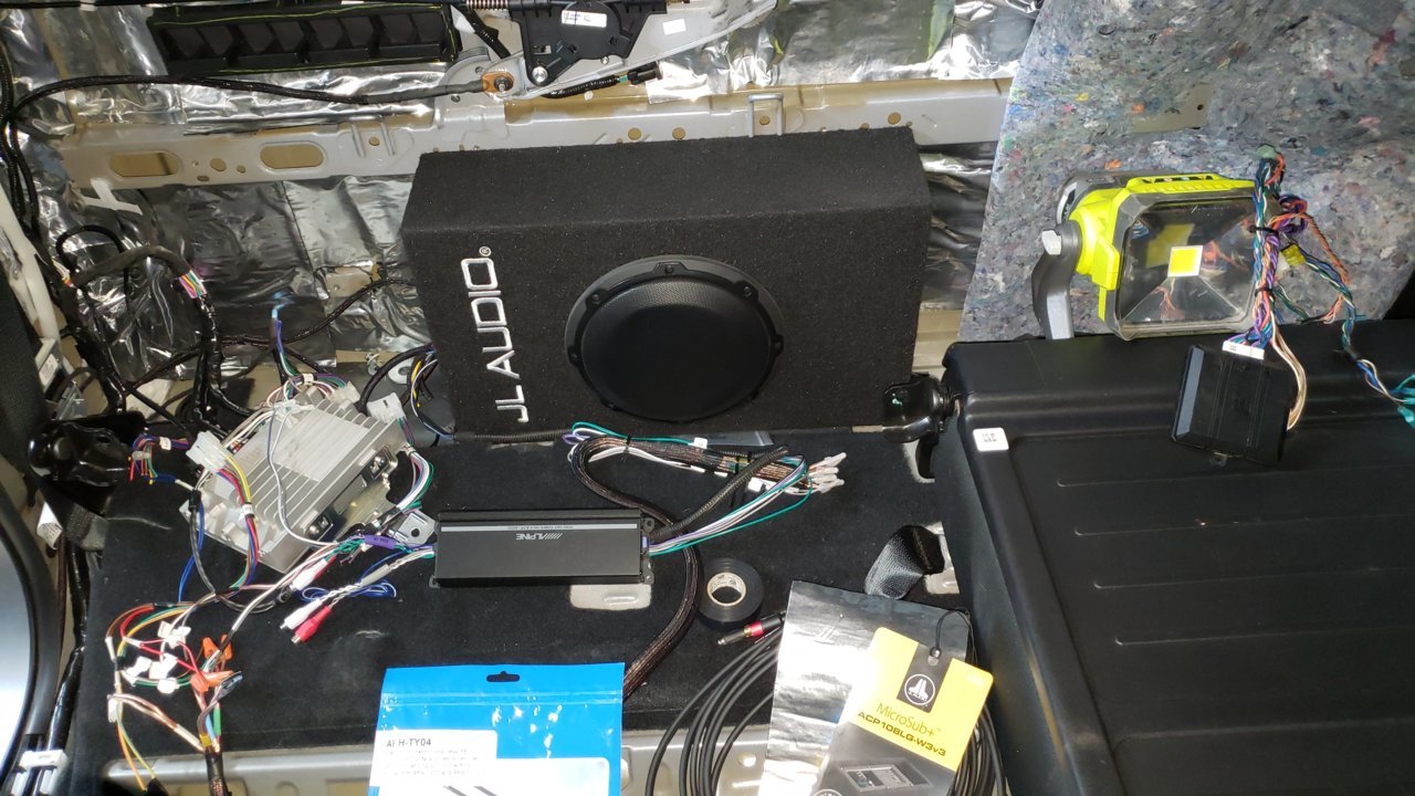

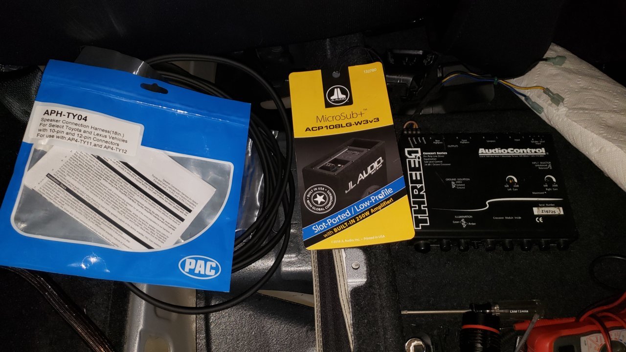

    20190428_202719.jpg 20190428_202754.jpg I'm in the process now doing my JBL system now. I saw your previous post, I got the pac aph-ty04 harnesses for the amp instead of splicing into the wires. How did you finish behind the seat when you took the sub out?

    I have the amps where the factory sub was and the sub is in the compartment behind the drivers rear seat!! I wish I would’ve known about that harness for the speakers!!! Oh well I plan on keeping this truck for a long time so I’m not too worried about it!!

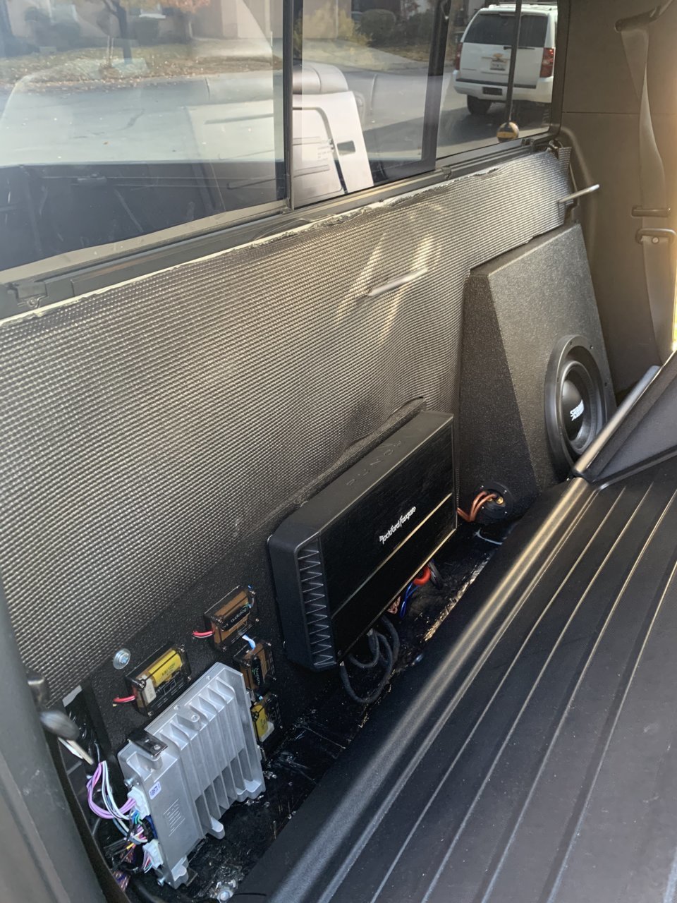

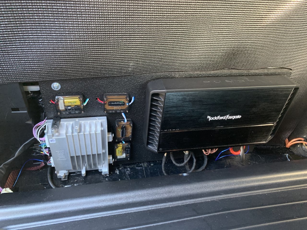

    Here’s how I mounted my setup. Amp rack where jbl sub was. I didn’t want to move the jbl amp too far as I would have had to cut and extend wiresFA107197-3412-4097-8DC4-AF7661C49A67.jpgD4DADBCE-8A1E-4931-BE5B-B5B2E451511A.jpg
