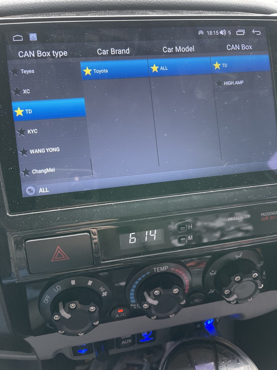

    Hello all. Over the weekend I went ahead and installed the Joying HU over the weekend in my 15 Tacoma non JBL. I was able to get everything working, even backup camera using the default harness that Joying sent, but I cannot get the steering wheel controls to work. I attempted to program them, but no luck. I posted some follow up / questions over in the Joying thread posts 1112 and 1115:
    https://www.tacomaworld.com/threads/2nd-gen-joying-head-unit-thread.706997/page-56
    Overall I think it comes down to the canbus that is not programmed within the Joying menu, but I am not sure which canbus I should select (see picture attached) If anyone has any recommendation or suggestions greatly appreciated.

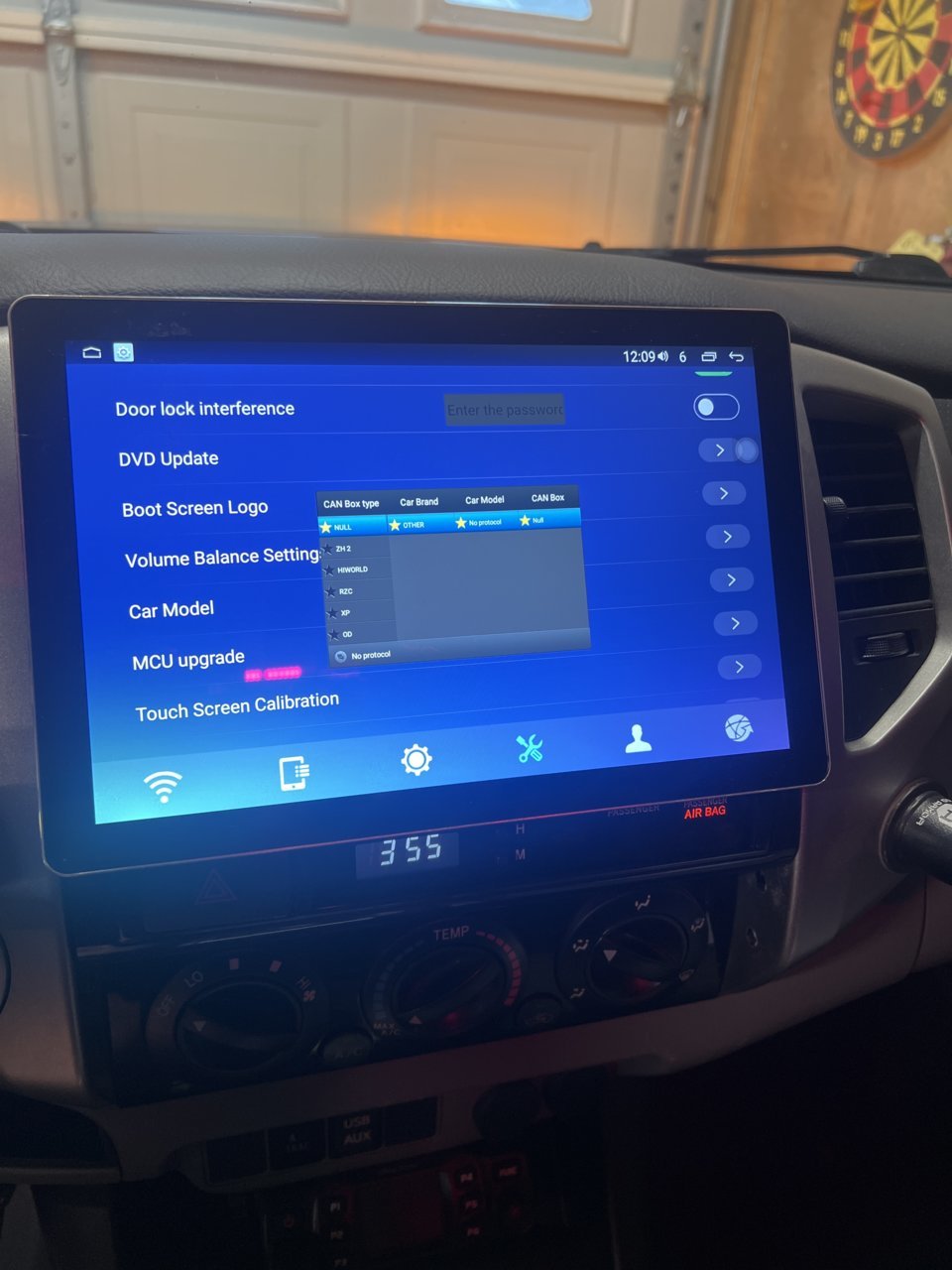

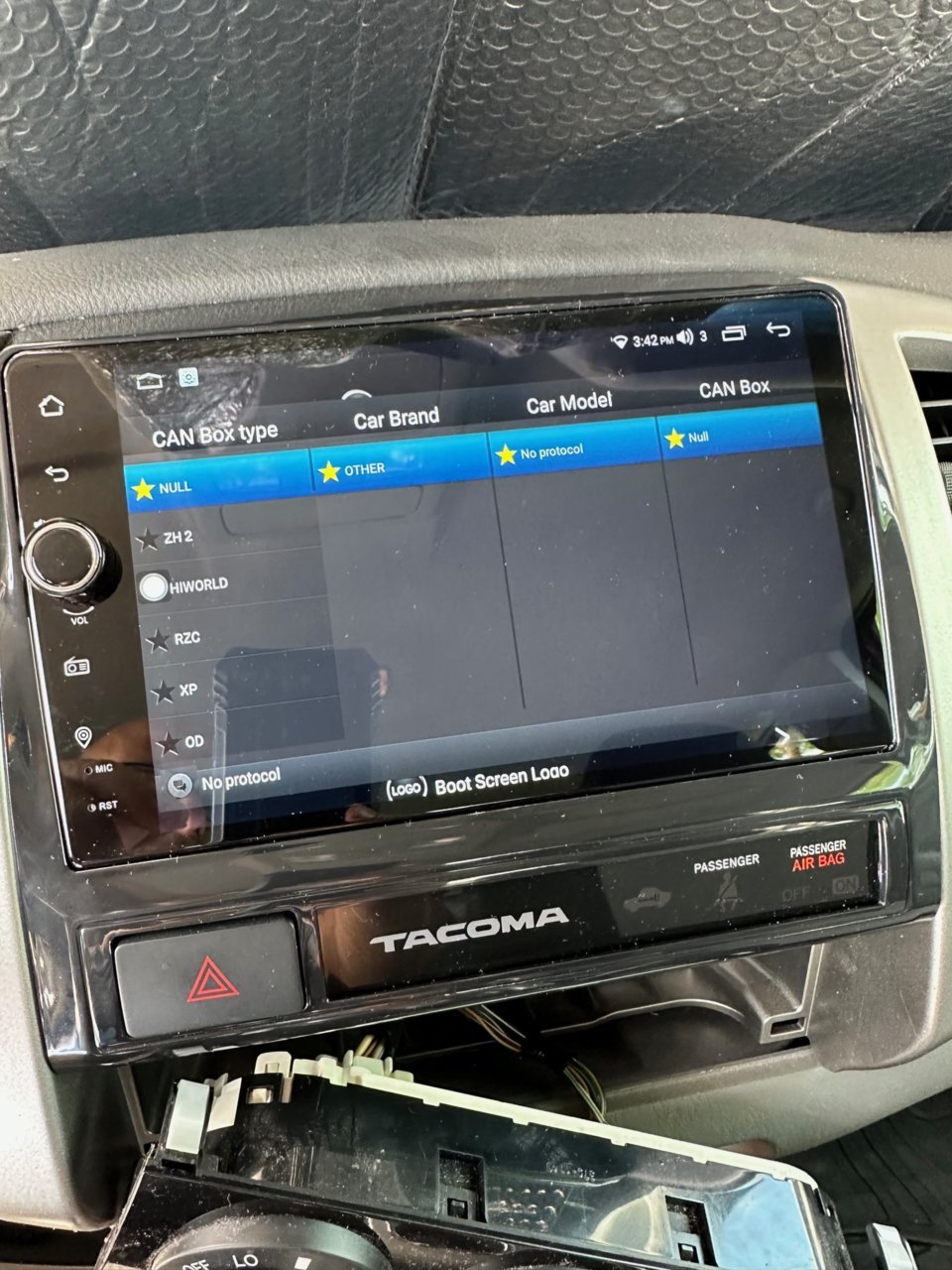

    Any luck on the SWC? I have a different joying with no buttons or and I can’t seem to register my SWC to the HU.
  15. Jul 23, 2023 at 3:19 PM
    Danke5305
    Danke5305 Well-Known Member
    Sep 17, 2020
    #341107
    124
    2013 tacoma prerunner
    You will have to scroll down a little but try this setup. Works with the Toyota special harness. Not the universal.
