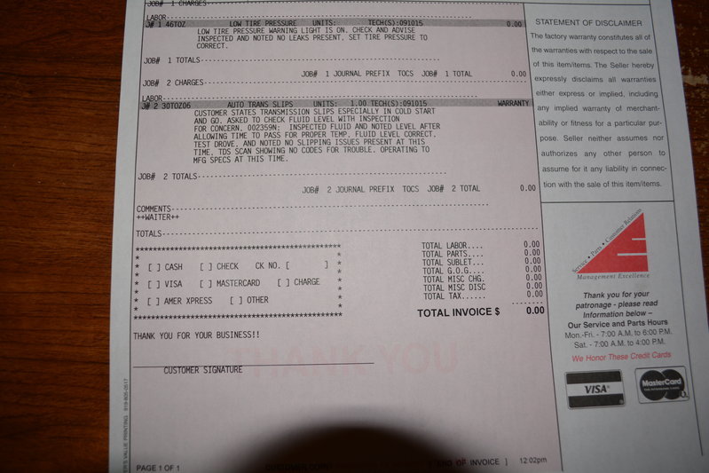

    Serviced mine today.They said fluid was full,no codes and no updates.DSC_0111.jpg

    Mancub , did you paint your overflow plug before you took the truck in ?
    Any sign on the plugs that they were removed ?
    When transmission fluid dumps out the overflow plug , it stains the aluminum casing . Technicians wipe off the remaining fluid but you still get a stain . Any stain ?

    Curious about this as many will just "say" it was checked, especially with a new vehicle
    they believe is fine and the owner is just being "picky". Just wish it was an easier process
    to check ourselves, not a big fan of jumping fuses, sure, should be fine but still never a fan
    of screwing with the electronics.
