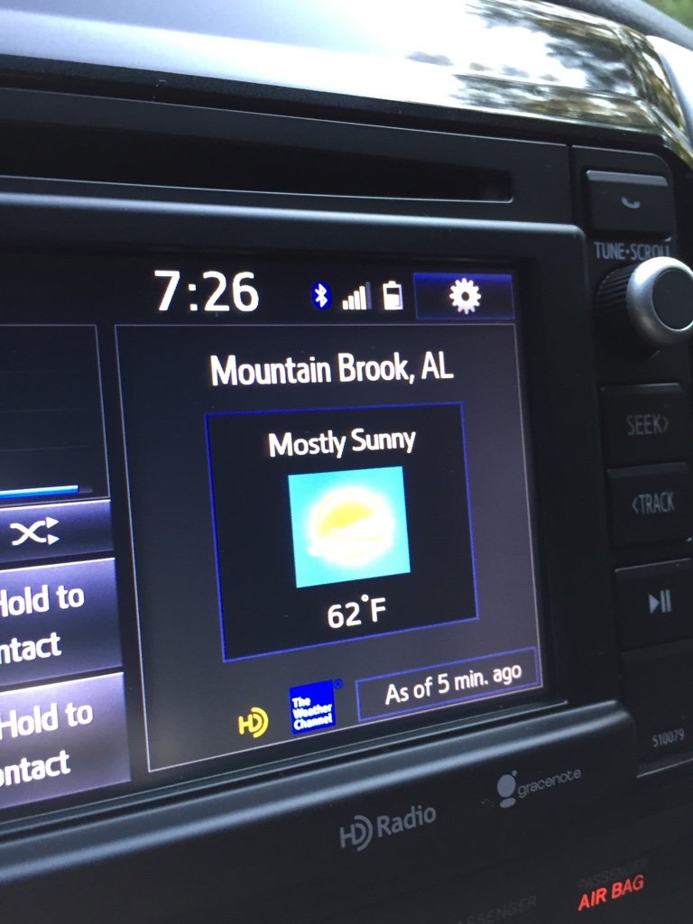

    Full tank of gas (100lbs), bike rack + bike (75lbs), + a 60deg morning cured my vibes
    No but seriously the difference between a 95deg afternoon and an empty tank and this morning is night and day
    I guess the 180lbs of rear squat plus the cool temps were enough to alleviate any high angles and stiffen up the CB enough
