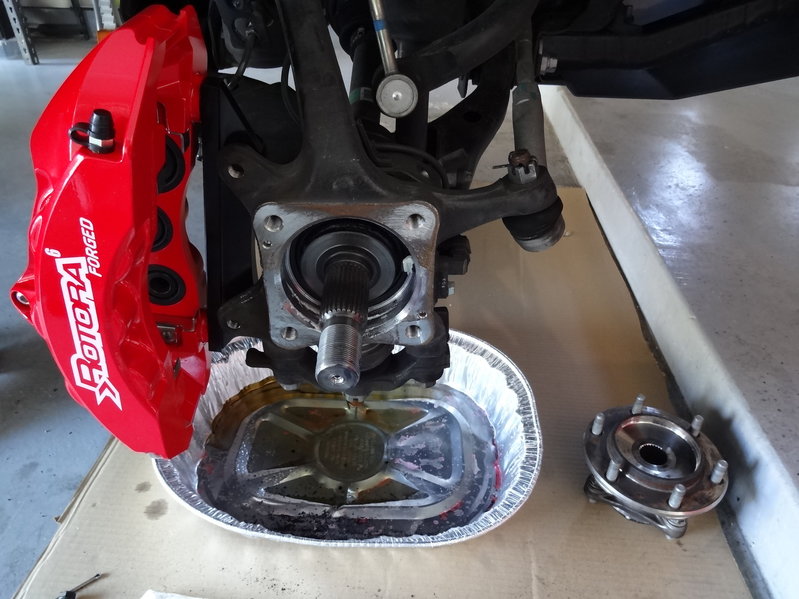

    I took my front hub bearings off to trim the splash guards for my big brakes and when I got to the driver side; there was very little grease on the inside of the bearing unlike the passenger side which was packed with white grease. The drivers side had little to none and what little there was, was black. I packed it with some white lithium synthetic grease I have for my bicycle bearings. Reinstalled and turned the axle shaft a bunch of times before reassembling. After about 30 miles the front drivers harmonic I had at 40MPH is still gone. But have no locked it into 4WD yet.
    Attached is a pic of the passenger side. You can see the white grease inside the wheel bearing. I forgot to take a pic of the dry drivers side. Hopefully this helps some of you guys, if not maybe it'll add a little more life to your front wheel bearings if they are dry like mine were.
