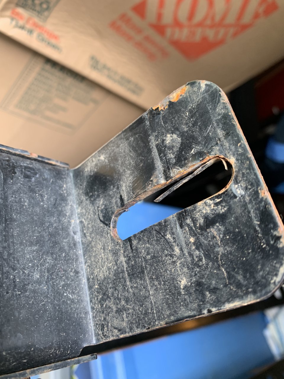

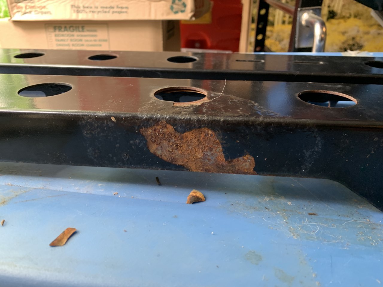

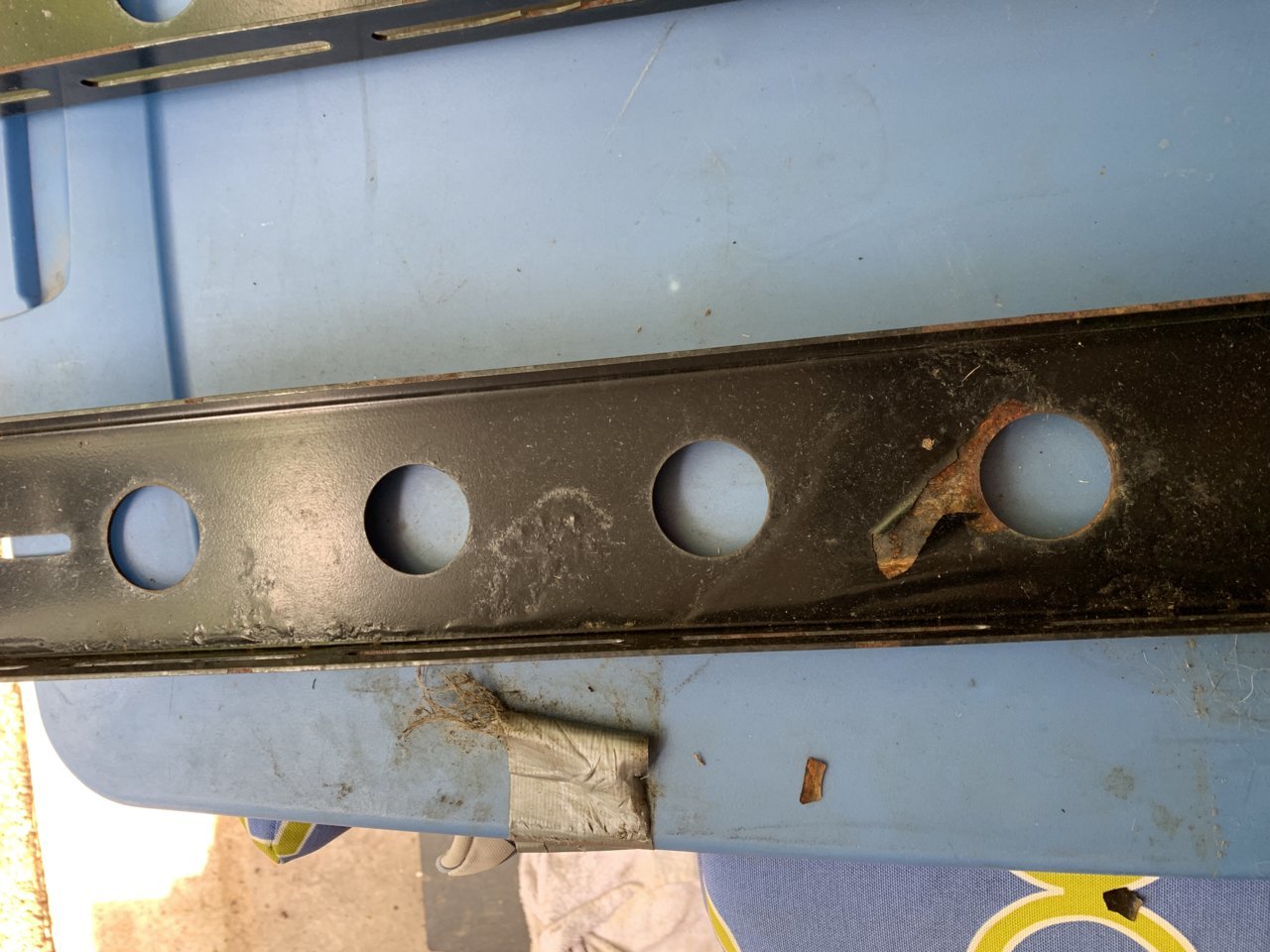

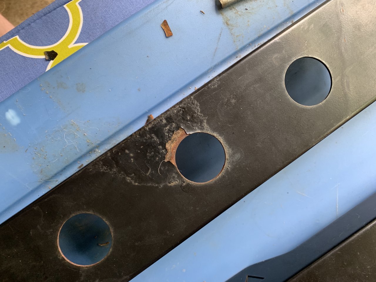

    Here’s just a couple pics of what I’m dealing with. These are the worst of them, all the edges are already peeled off and I can just scratch the paint off any part that isn’t already damaged with just my nail. F9FD6DC4-8FFA-4B9A-87B4-EC75B1F003B3.jpg 31ED0EBE-1508-4BBE-91C8-5E47D755782A.jpg BACE3FB4-6612-4D6B-9D49-18801AACF88A.jpg 6C0725E8-AF30-4714-8201-02391081DA78.jpg

    A $10 grinder from harbor freight and 2 polycarbide wheels would remove the rust, loose paint, and scuff up the rest. Then just Rust-Oleum bed liner or any other decent spray product

    Hell my Brand New Relentless Fab Lower Stingray Winch Mount has been on the truck for 2 months it already has spots of rust. I'm just gonna wire brush it then how it with Duplicolor Bed Liner done.

    Yea just a wire brush and some bed liner. The bed liner has held up on everything I have sprayed it on.
