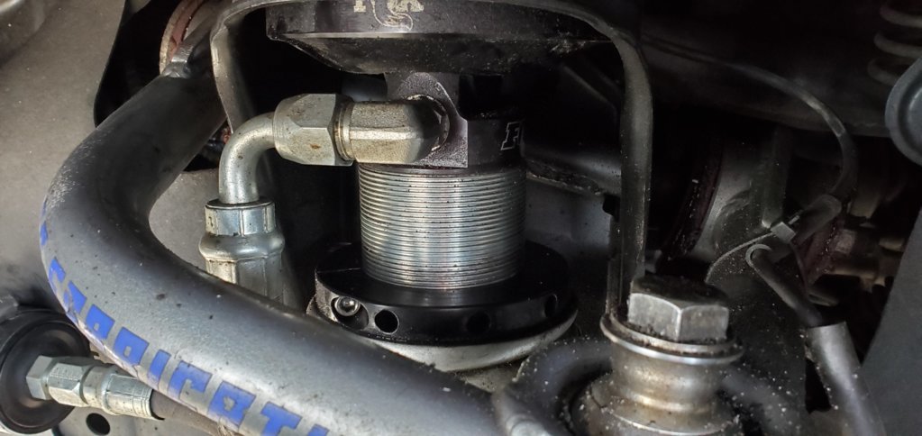

    This weekend I finally tackled my Fox coilover install mistake from back in March. The adjustment collar on the driver side was delivered to me with the set screw/bolt facing inward. I didn't notice until after install when I went to adjust the collar. So I believe stock height in front was 20.5" hub to fender and 22" in the rear. I was at 21.5" in front with coilovers as delivered with 1.25" of thread showing above the collar. Now I'm at 1.5" of thread above the collar which gives me 22" hub to fender in front. Still only 1.5" lift but with the CMC I had done it's enough to clear my 285/70R17's. Back end is at 24" hub to fender but I have Firestone riderite air bags so that's easily adjustable with a compressor. The 1/4" adjustment of the collar was 3 turns of the collar on the passenger side and 3.5 turns on the driver side (the extra half turn to get the set screw facing outward).

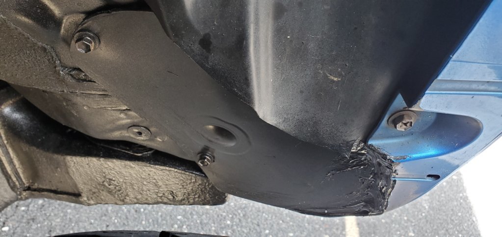

    Also added new fender well shielding made out of black 5 gallon pail lids.

    OK, here's some pictures of my home made fender well shrouds for the backside of the front fender well where I had trimmed to make room for 285's. Had a slab of rubber there for years but this is much cleaner looking.
    And here's the coilovers after adjustment:
