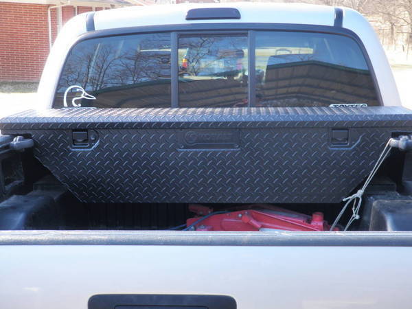

    I picked up a slim tool box and didnt like the finish so i got it powder coated black and LOVE IT. But my ? is what is the best way to mount it?

    The easiest way it to install it is with j-hooks. Do a search and you'll find some threads on it.

    X2 on the J-hooks

    I got the same toolbox, mounted with j-hooks into the tracks and its held fine for a couple of months now.
    1 thing though. The Kobalt boxes (or mine at least) has 4 HUGE slots for bolts. Do something to seal them up, otherwise, if you wash your truck, and aim the hose anywhere near your box, it will get water in it. Minimal water, but still.. Don't want them tools to get rusty. I did some rigging, and siliconed it in.. Today come to think of it.. haha

    you can get the grip mounts and they will fit into your rail system if you flip around the bolts, mine is held that way and hasn't moved an inch.
