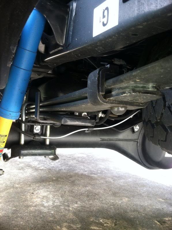

    Excuse my ignorance, but, how many leafs do I have? 3 or 4? Here's a pic...

    That would be Four. 3 leafs plus 1 overload.

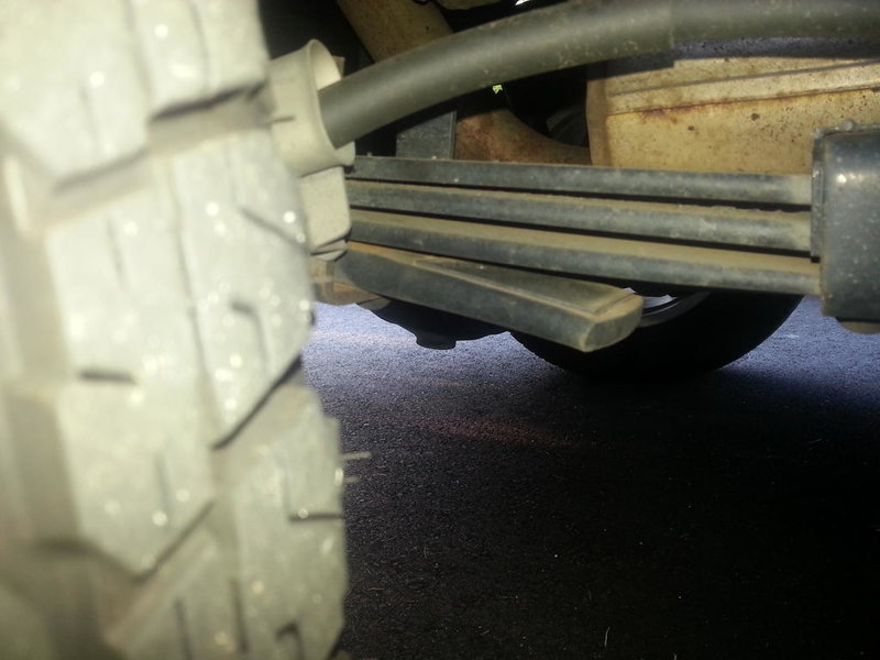

    Well I'll let you know what Toyota gets in when they replace both my leaf springs. When I bought my '13 DCSB TRD offroad about a week ago I didn't notice the brackets in front of the axle that hold the packs together were bent. All the dealer and I could guess is that from the port to dealership some one held it to the delivering truck with chains mounted in that area, which bent the brackets. So 2 new leaf packs are one order.
    My current ones look to be 2leafs + 1overload.
