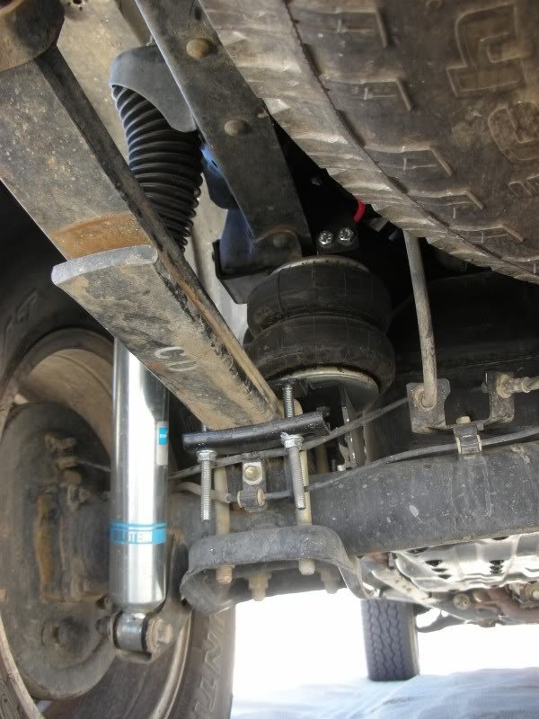

    Airbags (Ride Rite by Firestone) worked great on my 2005 along with 5100s in the rear. This solved the bottoming out over every bump with any load (didn't know about TSBs and dealer was no help). You control the firmness with more or less air... fill valves installed next to license plate. 15 psi emptybed to light load, to 40 psi for heavy load worked for me in my double cab. (range is 10-100)

    I went with the Firestone Airbags. At least for now.
    My install was pretty quick and the air valves are in the bed storage boxes making it easy enough to check/fill them.

    Ummm... the stock leafs were wrong for the truck and that is why I added the air bags. If I changed the springs, then I wouldn't need the Ride Rites...
    I researched doing the Deaver springs, re-arcing the stock springs, etc. Those would all have made my ride hard all the time, when I only needed extra spring support with a load.
    Off Road Warehouse recommended the Ride Rites and I was very, very happy with them.
    No, you add air only if you need more firmness or want to raise the truck... It lifted the truck close to two inches. I usually ran them at 15 psi for my light work loads and up to 30-40 psi for a camping trip with ice chests and gear in back.
    You could install an onbaord air pump and do it from your cab... but adding air is so easy and fast... a couple of seconds blast of air changes the ride.
    When I traded the '05 for the '10, I had the dealer remove them in case the new truck had the same lame springs (I was concerned, because they are also only 3 leaves).
    Well, it has been nearly a year on the new truck, and the spprings have worked fine under the same conditions that caused the older one to bottom. So, I have a set of Ride Rites still sitting in a box here.
