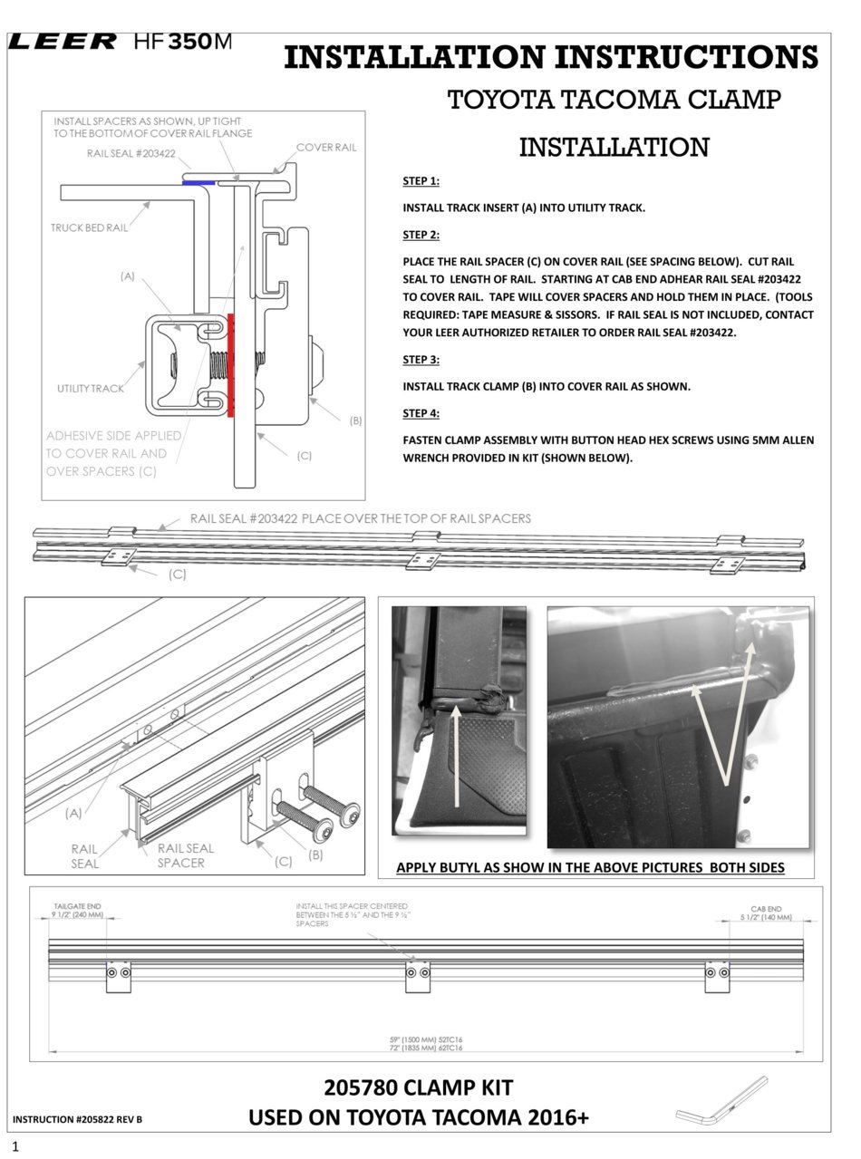

    I was also having trouble so reached out to Leer and they sent me the attached instructions. The instructions are for the HF350M but they said it is the same process for the HF650M. Not sure why they didn’t include these with the cover!?!? They only difference is they say to use the sticky butyl weather stripping in the gaps near the bulkhead where you cut off 1.5in sections of the other stuff.

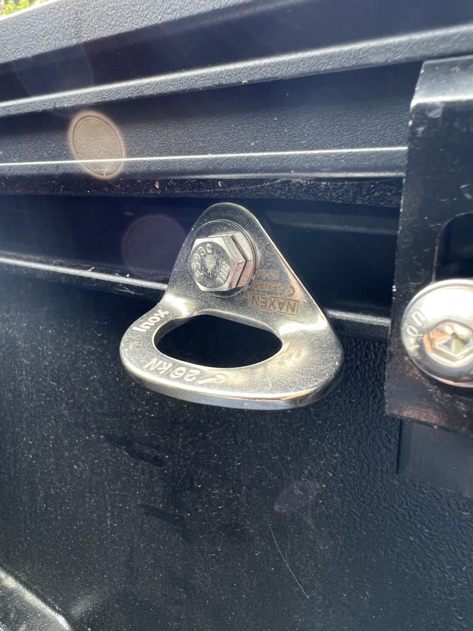

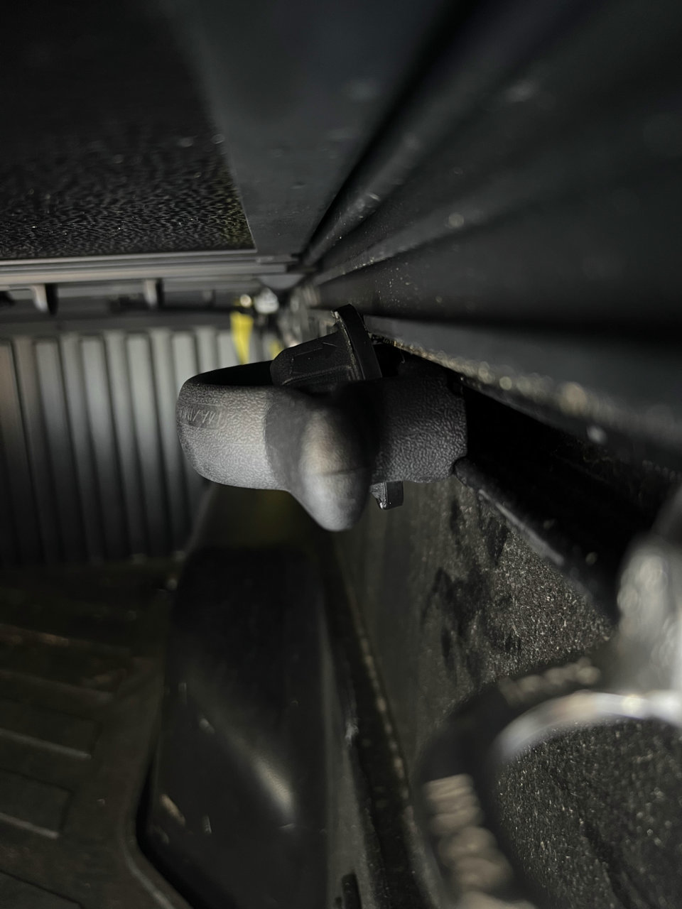

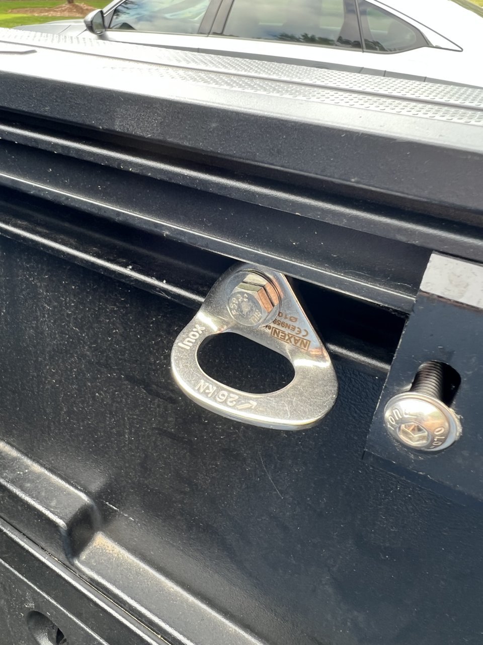

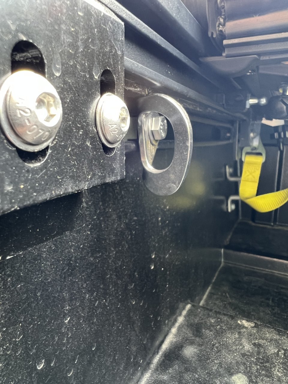

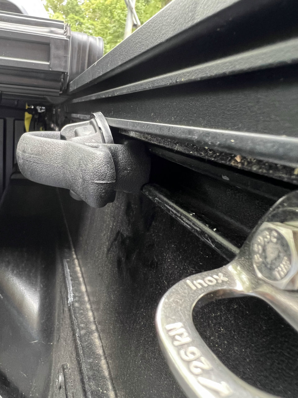

    Can you still use the bed cleats with this cover folded up?

    I took a few pics for anyone curious in the future. The OEM cleats do fit under the cover but the knob hits the rail and it sits at an angle. It will work but it's kind of a pain. see below.
    IMG_3367.HEIC.jpg IMG_3368.HEIC.jpg took a few pics for anyone curious in the future. The OEM cleats do fit under the cover but the knob hits the rail and it sits at an angle. It will work but it's kind of a pain. see below.
