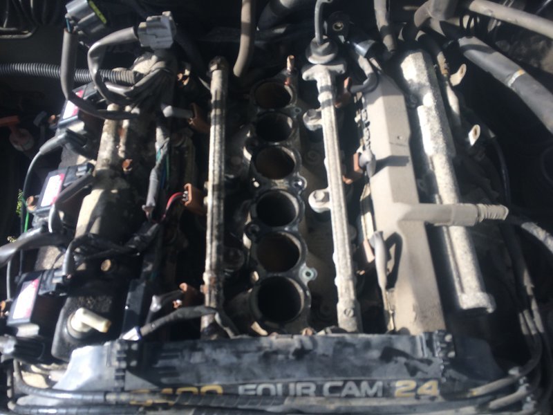

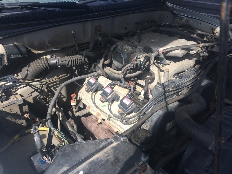

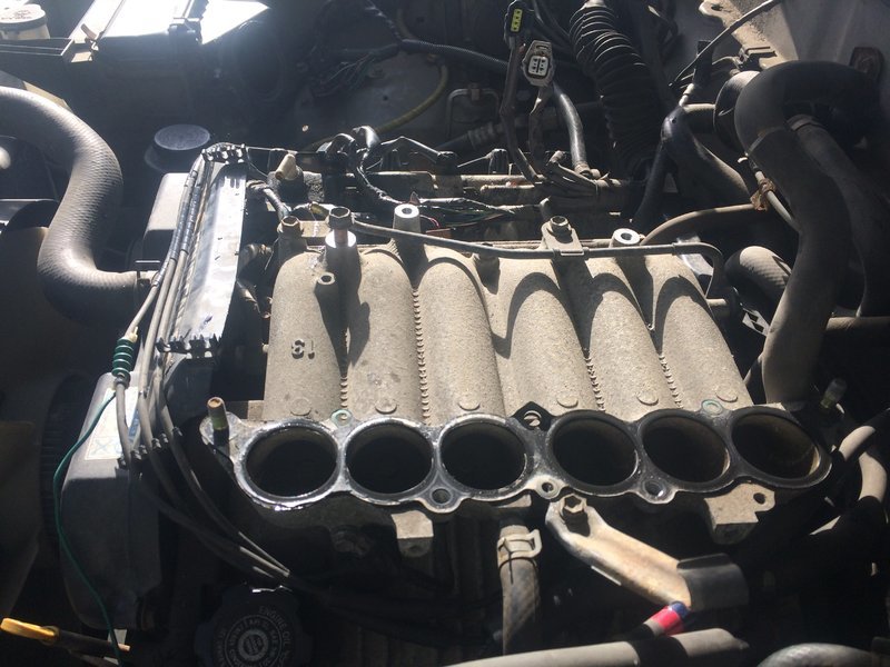

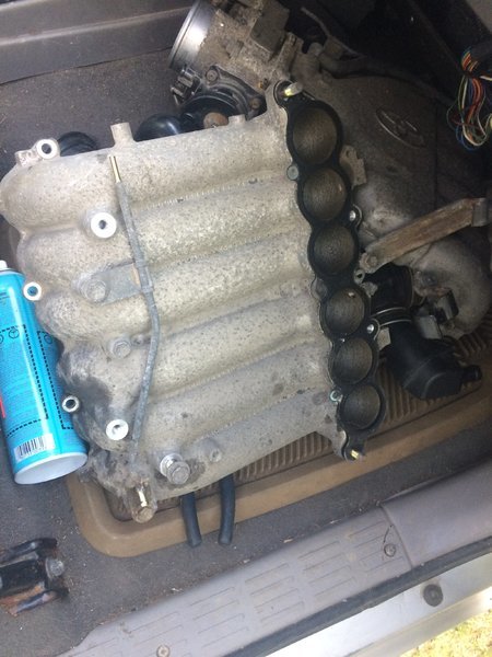

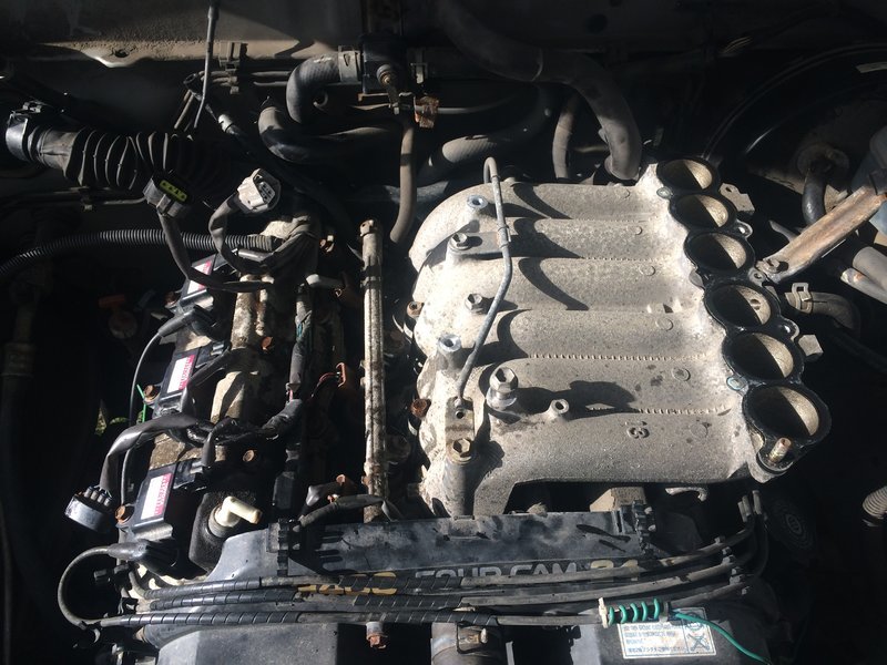

    Butttt this is about hi hoe silver !
    Where to start .....

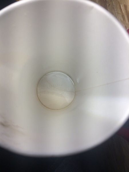

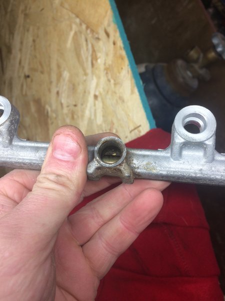

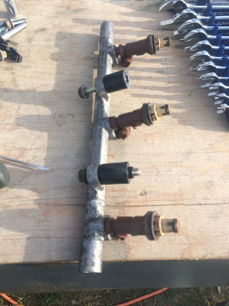

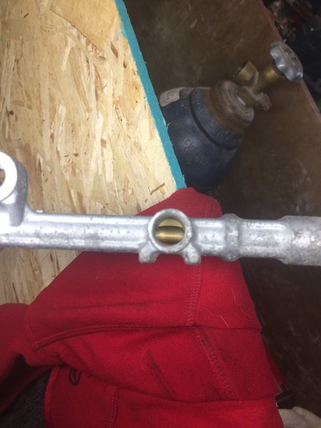

    I cought what fuel I could in a cup to have a look and it looks like the fuel rail had a considerable amount of water in it even after various gas line treatments.
    I removed the injectors and put them in ziplock bags with what # cyl they came out of. I will clean them as per the directions on YouTube and re install. I am also going to take the box off (for red truck) while I am at it remove the sending unit from the tank and clean it out ....
