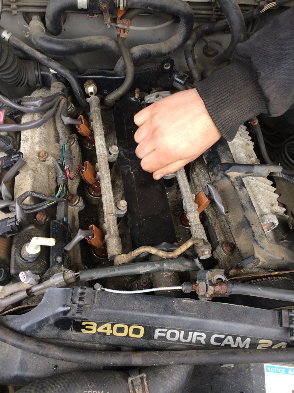

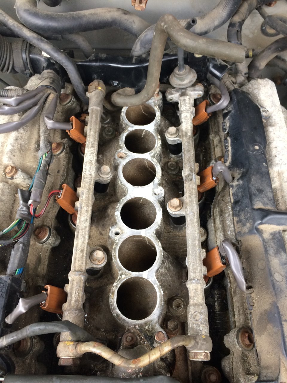

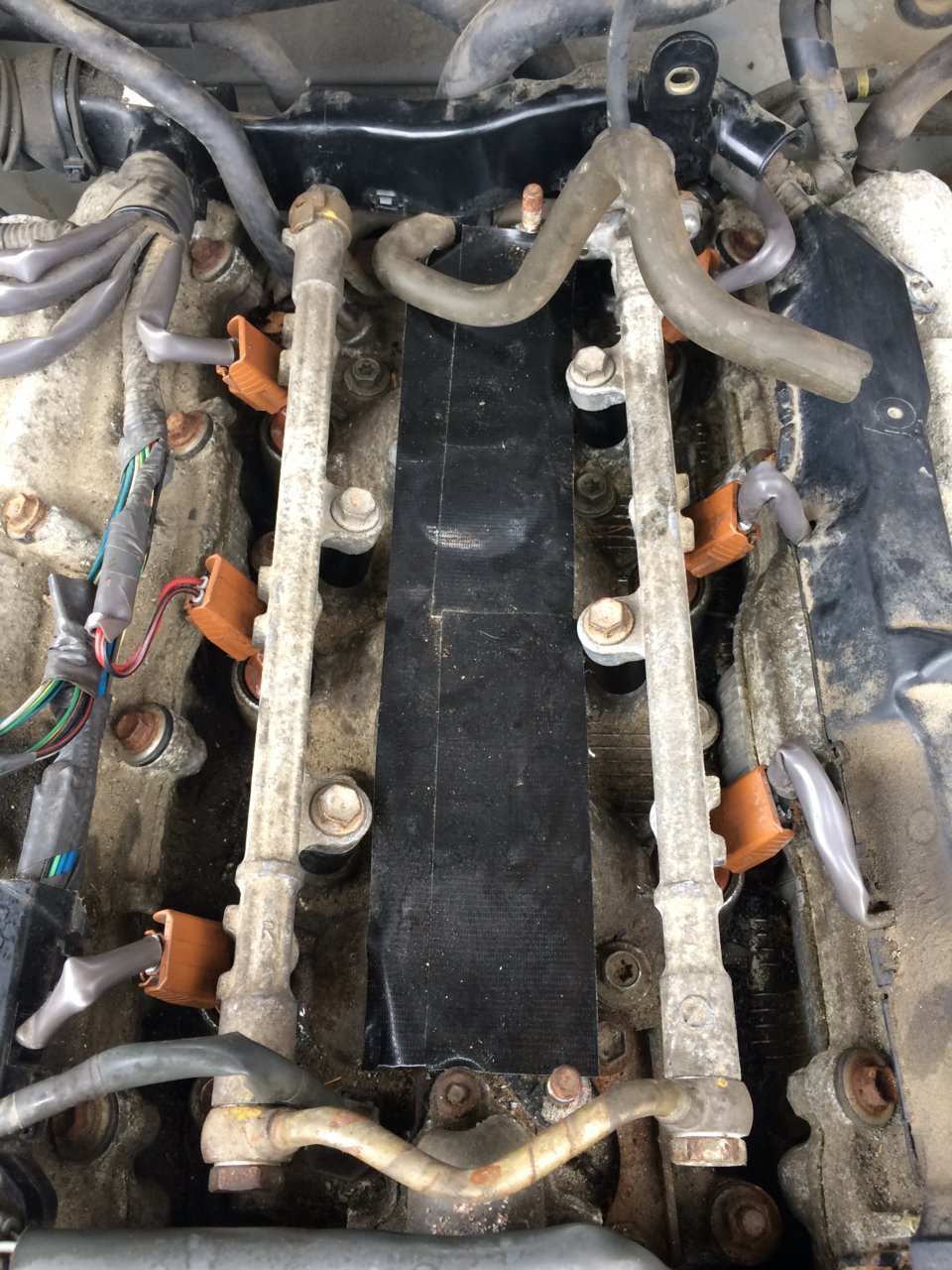

    So I had tape over all the open holes in the motor then put a rag on top then a second rag with a road sign on top. Few weeks ago I opened the hoof to find the start of a squirrel nest. It was new and i was lucky he did not tear into anything, seeing this put me into Holy F i need to get this back together.
    The old injectors were rebuilt last year and placed in ziplocked bags marked from what cylinder they came from.
    I wiped out the hole where the injector sits then hit it with parts cleaner. I took each injector and put oil on the rubber seal and tried to install them into their proper home. I could not get the injector seated properly so i took a 12mm socket and put it on top and gently tapped them into seating position.
    Fuel rail bolts and spacers, banjo bolts, electrical connections

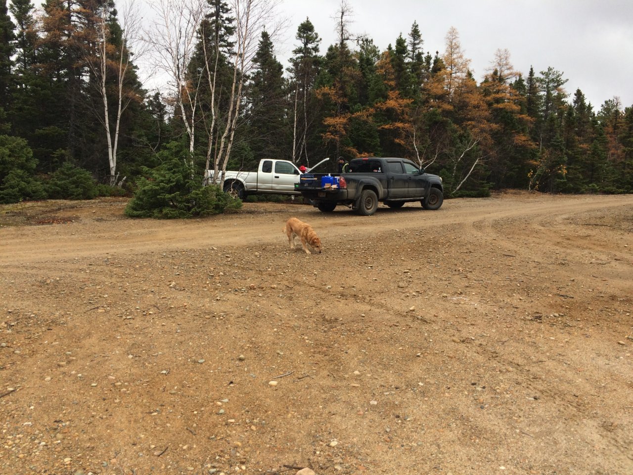

    My Dog Terra and my good friend Jason came out to help me with this wrenching adventure. :)

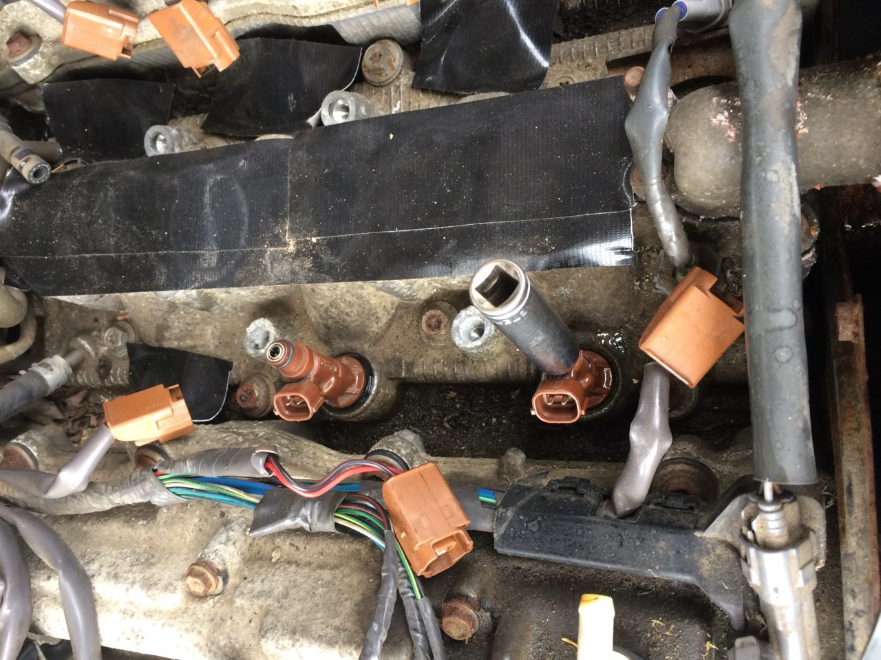

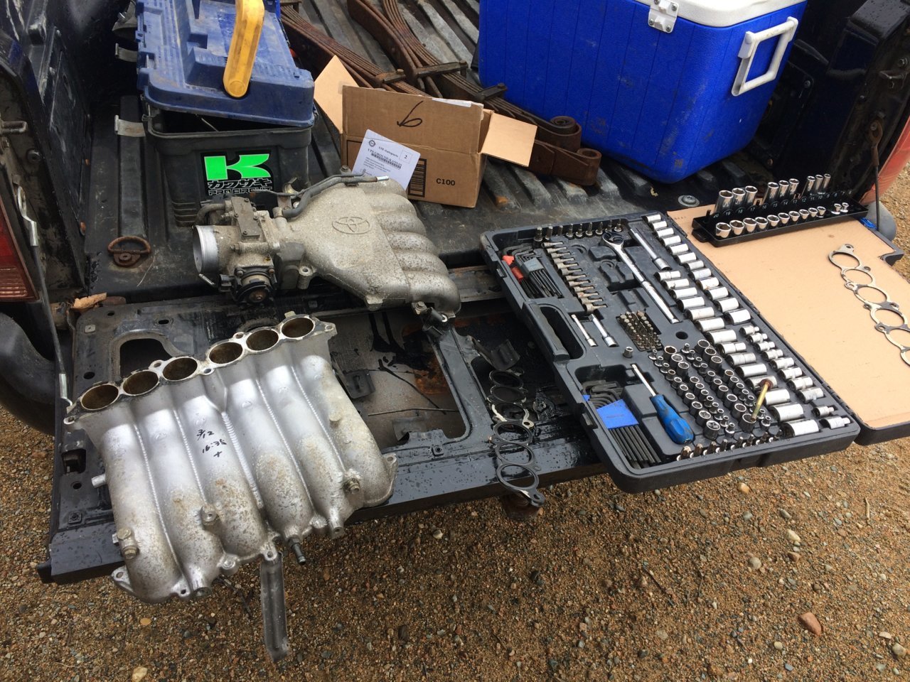

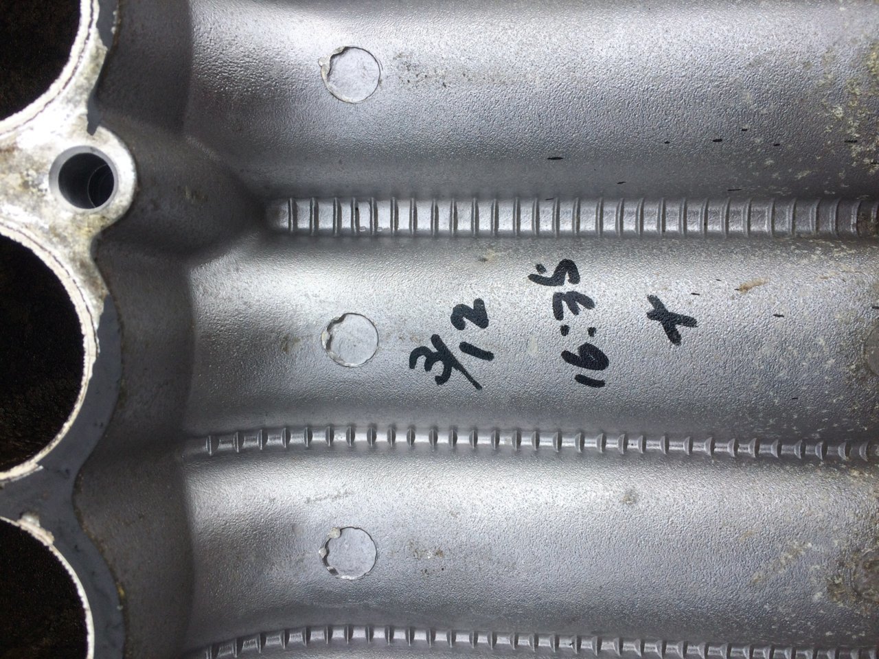

    I cleaned up the gasket surfaces and applied rtv Gasket maker I know not the right way BUT this is only a parts truck for my RED one / play truck for at the cabin / learning experience so it has a small budget
    I DID score a free well used toytec lift for it 3'' i think
    two leaf packs
    two adjustable coil overs (springs are cracked off)
    Anyone know the markings on the intake mean ?

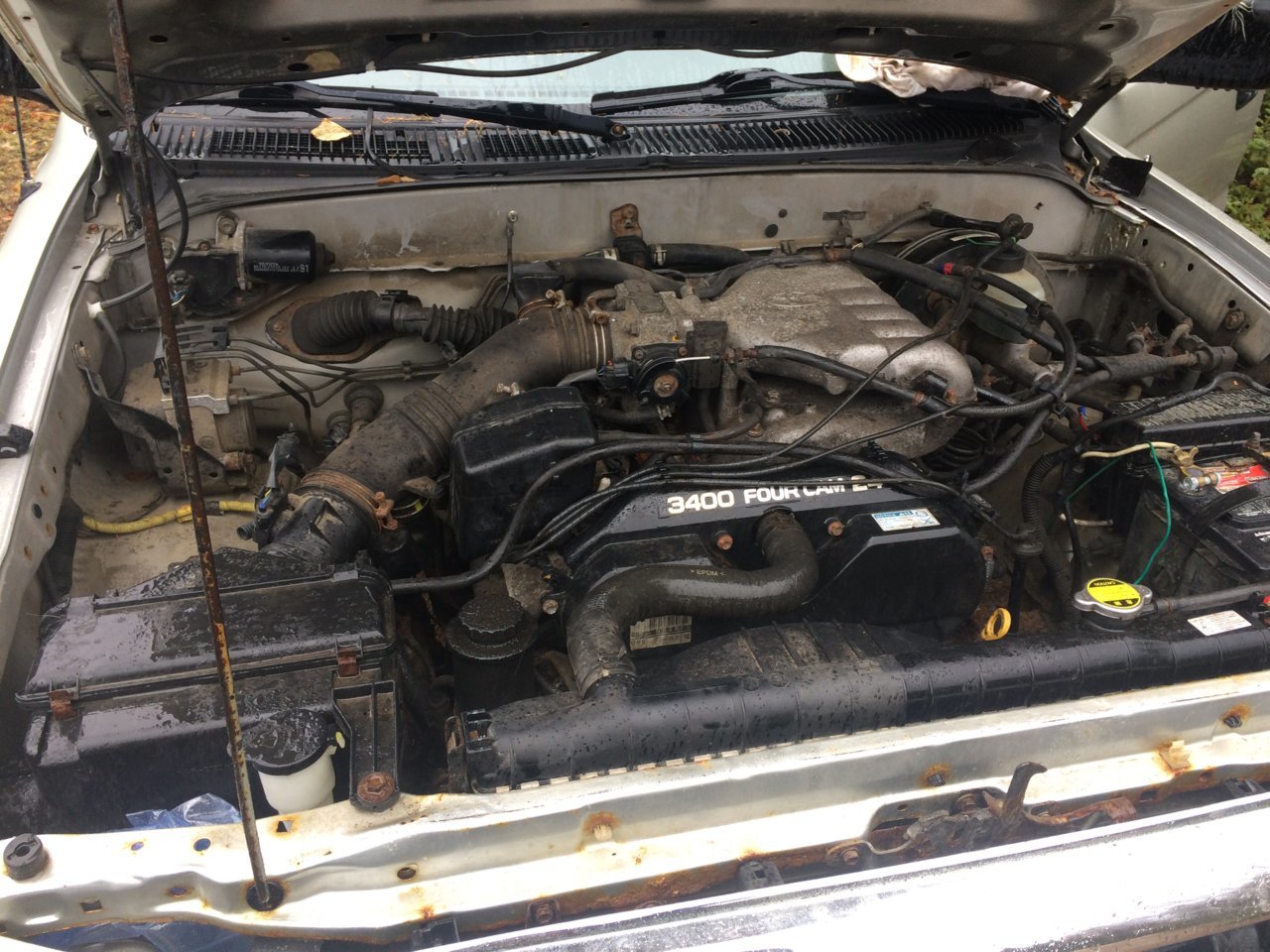

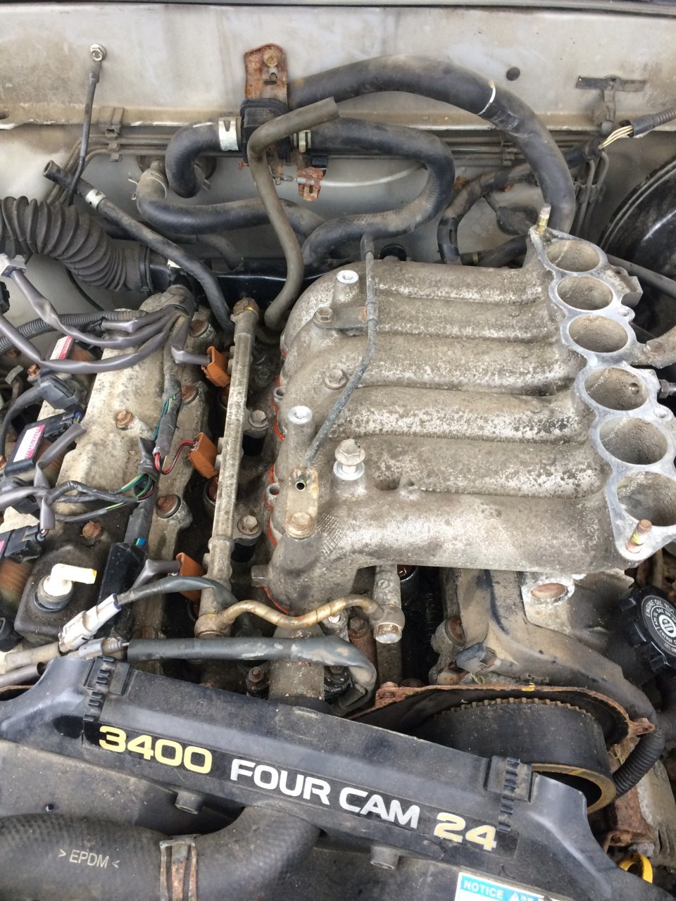

    So this is where it gets interesting and of course F Sakes my phone went dead so pictures from this point on are limited. The sky opened up and RAIN RAIN RAIN and cold cold wind :(
    Got the injectors and intake back on and all hooked up, no missing or extra bolts no Where The F does this go, to my knowledge it is all hooked up correct.
    Made sure alternator was free along with the PS pump. did not have the right tools to check the motor by hand. That's the starters job anyways
    Put the 007 Taco Pro on it with a set of booster cables.

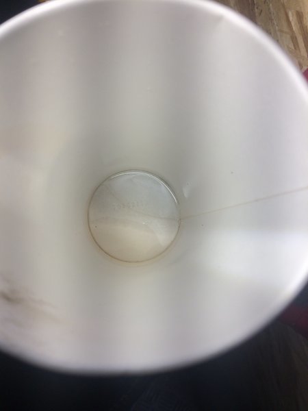

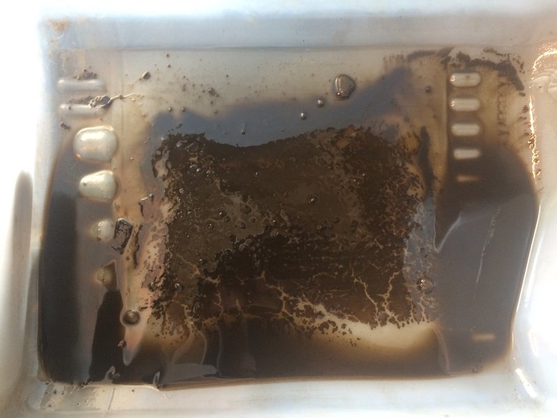

    If you remember from posts way way back I had this narrowed down to what i THINK was water in the gas as this came from a local small out port community where fuel quality would be questionable and water has probably built up over time. (still a theory)
    Pictures of what was in the fuel filter plastic container
    and the gas / water combo in the cup was in the fuel rail

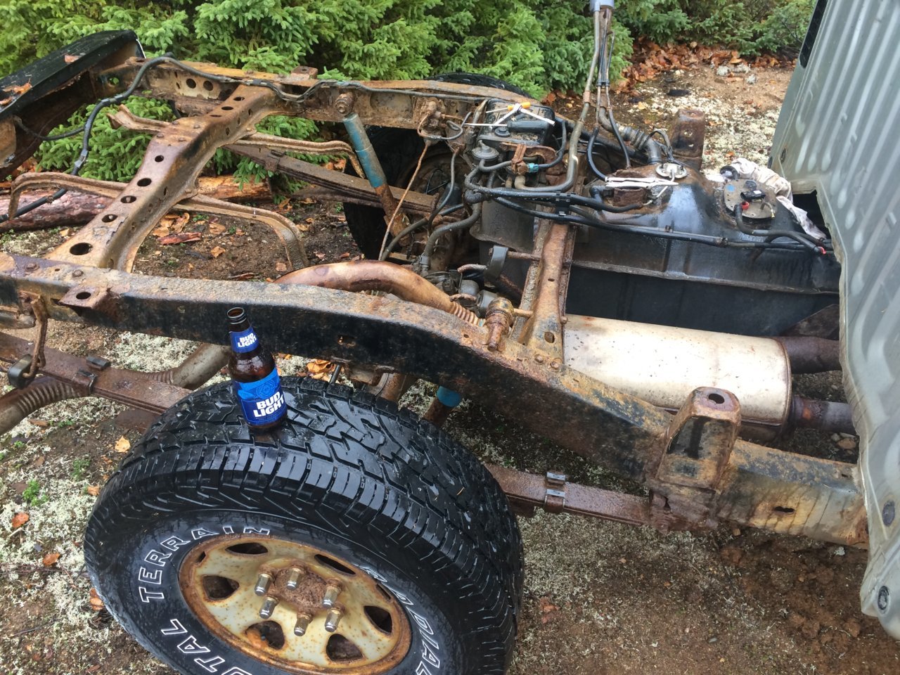

    So with all the injector building i wanted to make sure it would be getting clean fuel
    OFF comes the box to take the sending unit out of the tank

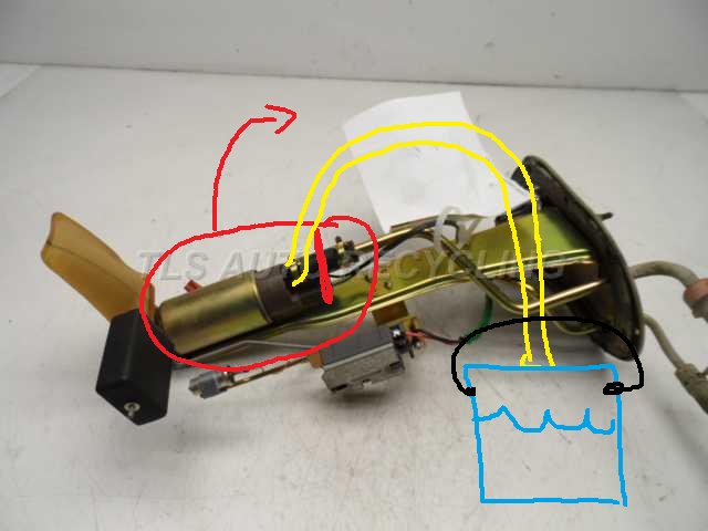

    NOT MY PICTURE BUT I NEEDED ONE FOR REFERENCE just a google image that i marked up for explanation
    So Off comes the bed in the rain,
    took the clamp off the return line with a pair of pliers
    tried to remove the sending line but could not as my hands were cold and i think you need a special tool ?
    What a stink of bad fuel !
    managed to get the sending unit out with the high pressure line still attached.
    Had a look in the tank and to be honest it does not look dirty of any huge water puddles.
    We did not have a hose to drain the tank came up with the idea to use the pump, took the hose off the PCV valve YELLOW and removed the pump from the sending unit frame circled red, removed the short hose and stuck the long pvc yellow hose on it and the other end in a bucket. I laid it all back in the tank hooked up the electric connections and turned on the key and the pump did not kick in to build up fuel pressure

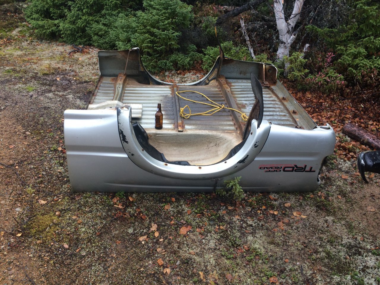

    The box came off and i got to have a good look at it as this will be going on my red truck.
    Cleaned out under the box liner as there was a lot of dirt and saw dust holding water that would rot the box out
    I towed the truck next to my shed and parked it so it does not look abandoned anymore.

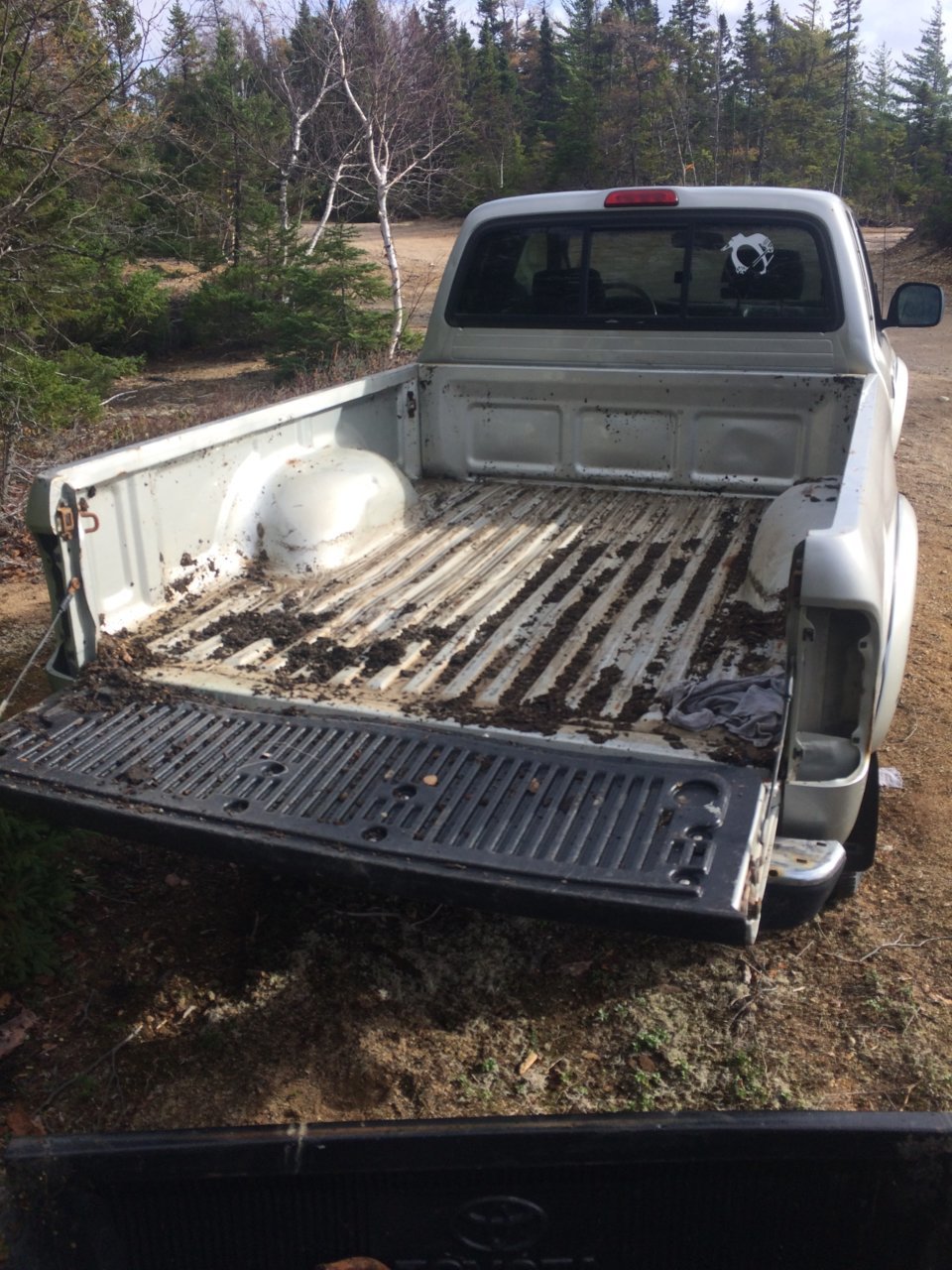

    Last picture form the weekend
    put the box back on the 04 and i took the liner out to clean the build up of sawdust, dirt, mud
    when i go to build the RED truck / restore it this will probably be the box i will use as the red one is damaged
