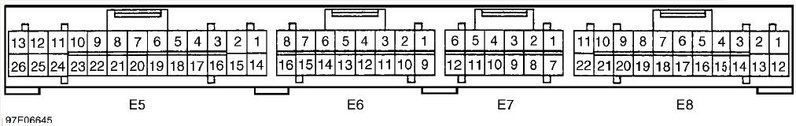

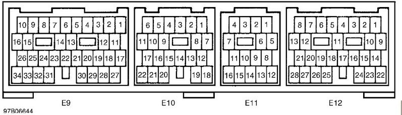

    This may be my next step ........
    I know no odb2 codes for ignitor are present but this is the only info i can find on how to test the ECM
    I TOOK THIS OUT AS I AM UNSURE IF IT IS THE CORRECT INFORMATION FOR MY 04 V6 AUTO, REFERENCE THE LINK ABOVE.

    Couldn't hurt, make sure the ECM pin outs are the same for your year, trans combination.
    Jon G[OP] likes this.

    This came off of Mitchell On-Demand workshop manual that someone put on a different site ...... searching for the correct info now (never found as the ADD got me and i ended up reading about a auto to manual conversion and what all the wires to the EMC do)
    EDIT ..... got myself confused with wiring diagrams and what each does, but in my mind this is the most logical place to check
