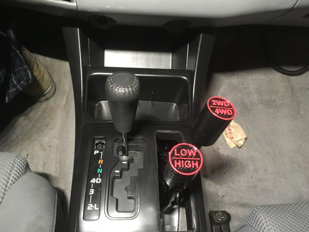

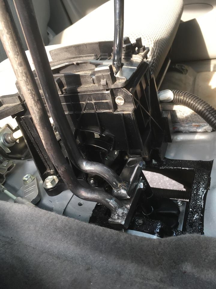

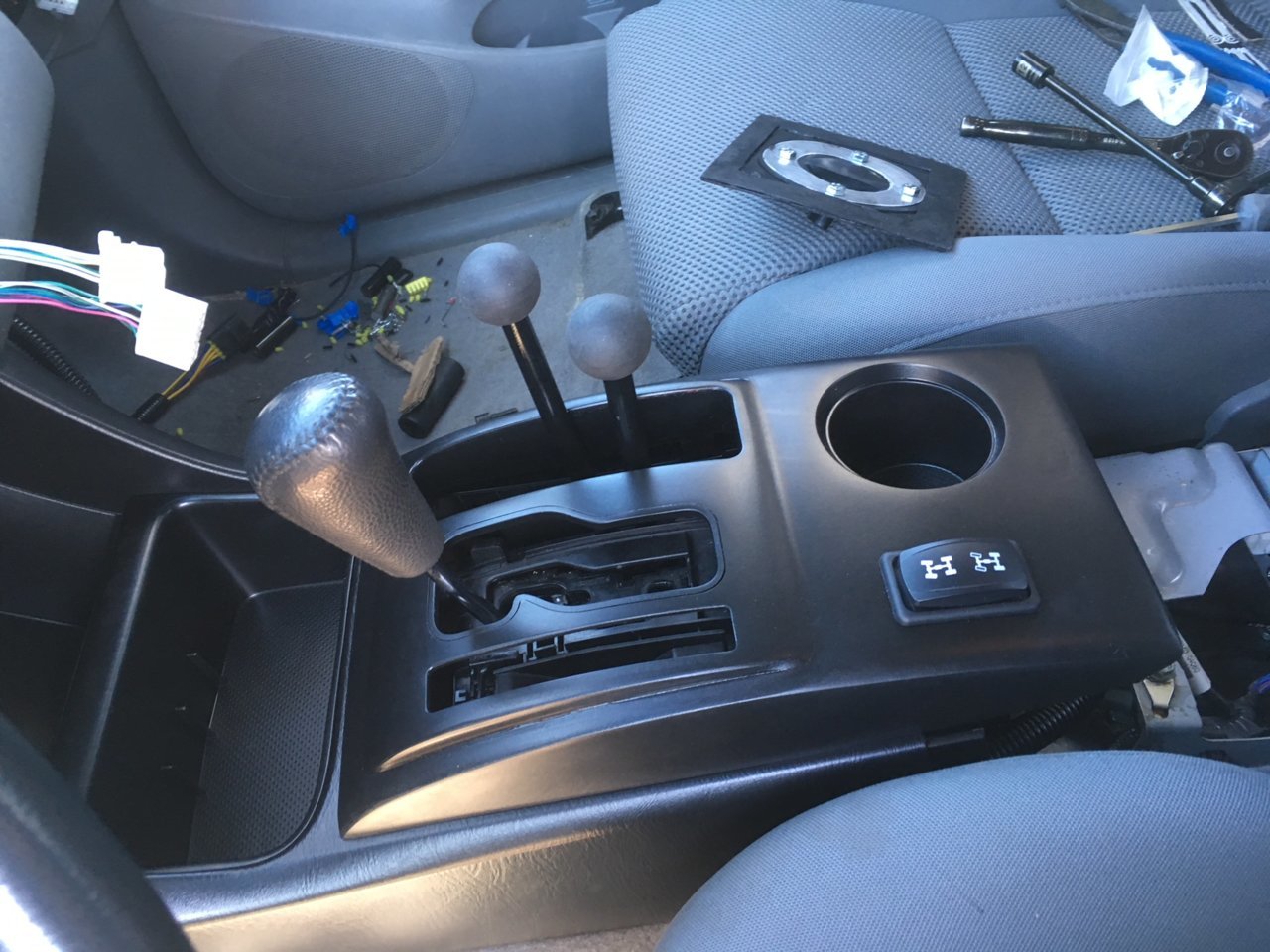

    Here’s mine. Slightly different now since I changed twin stick shifters.

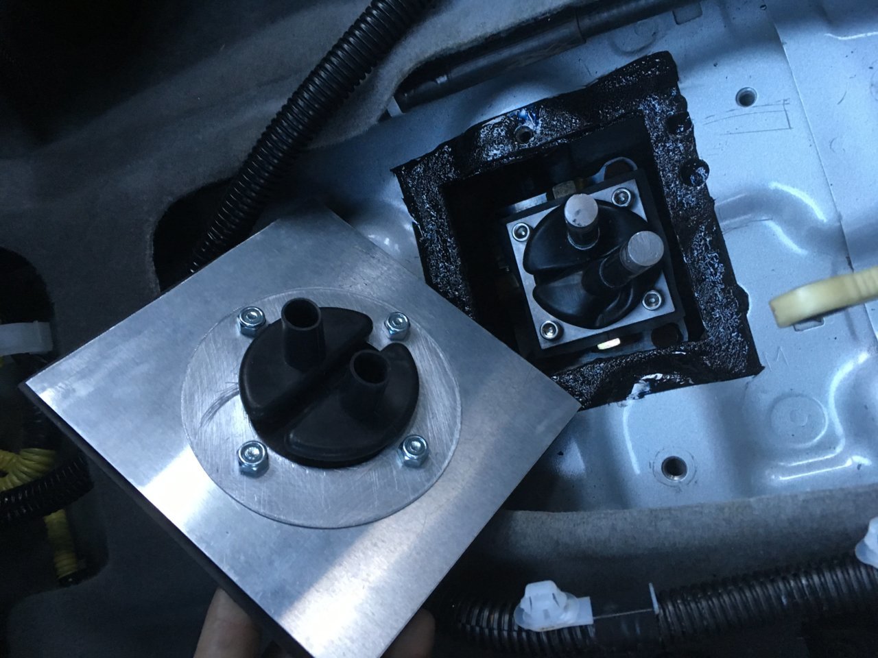

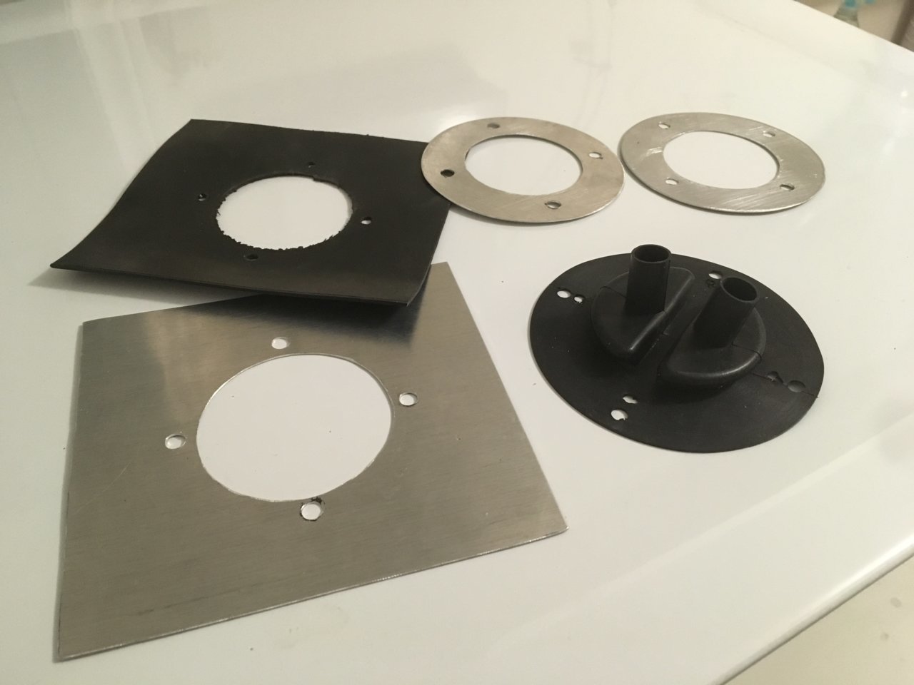

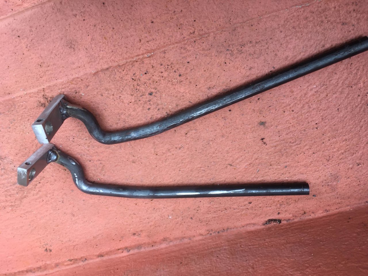

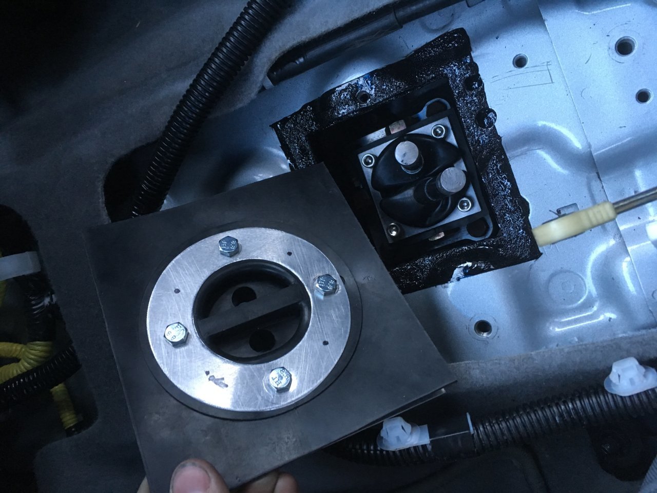

    So here it is. My FJ swap (with ideas taken from a lot of different builds posted here..
  17. May 14, 2018 at 7:49 AM
    #137
    libagui
    libagui Well-Known Member
    Feb 16, 2009
    #13689
    594
    Dominican Republic
    05 tacoma prerunner
    Bilsteins 5100 set at .085 Rear custom 1" add a leaf 265/70 R17 tires. Custom made aluminum tonneau cover with bike rack. 4x4 conversion with 4Runner transfer case.
    How will you seal the hole?.
  18. May 14, 2018 at 8:23 AM
    #138
    NeonHeights
    NeonHeights Well-Known Member
    Feb 21, 2017
    #211262
    455
    I made a custom floor seal with aluminum sheet, and a rubber shifter boot bolted between the aluminum plates. This assembly slides over the shifters under the truck, then gets bolted to the body. The rubber square part faces up against the underside of the cab and pinches against the metal creating a seal, while the shifter boot section seals off the area around the shift rods. This method only works with me because im running a 1.5” body lift and have the room below the truck between the t-case and the cab to slide the seal in place. I dont think this method would work on a truck without a BL as the top of the t case is touching the floor/is in the cab and theres no room to mount a seal from the underside. Trucks without a BL will have to seal from the interior

  19. May 14, 2018 at 8:29 AM
    #139
    libagui
    Feb 16, 2009
    #13689
    594
    Dominican Republic
    05 tacoma prerunner
    Excelent solution ..!
  20. May 14, 2018 at 8:36 AM
    #140
    HolyHandGrenade
    HolyHandGrenade NOOB
    Mar 25, 2013
    #100579
    11,801
    Tim
    Garage Most Likely
    DCFB (RIP)
    Some Stuff
    Genius :thumbsup:
