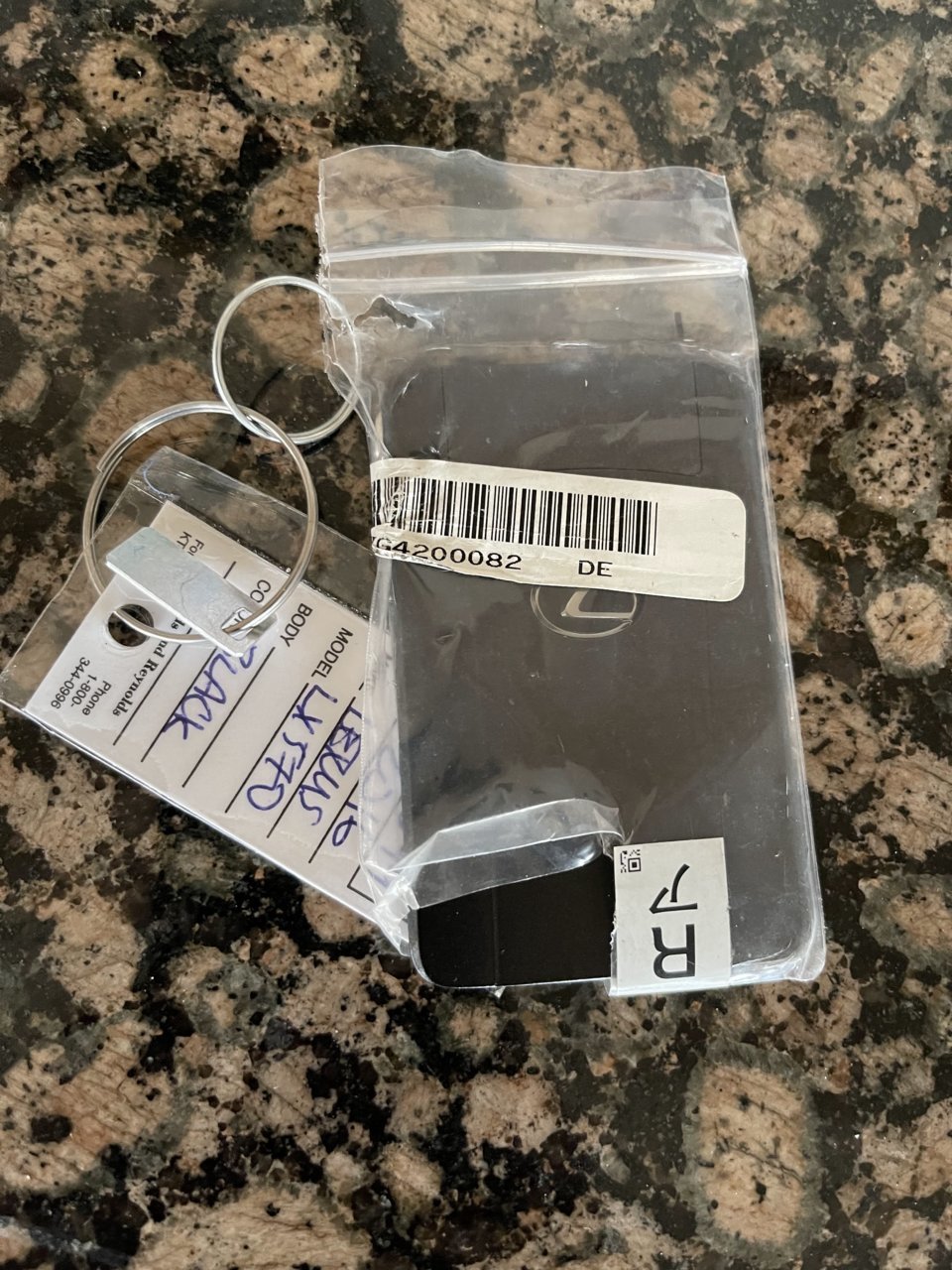

    oohh nice tdlr i don't want to read through the entire thread but I do have a Lexus keycard unused & unprogramed from my LX570. since I need a spare key anyways I should really look into finding a local Denver area locksmith who can program it onto my 2020 Taco. If it works sweet one less thing to carry around with Colorado's new digital drivers license app I don't even carry around my wallet anymore...

    What’s the back of the card look like with the part numbers? Might be a different coding than the Tacomas.

    Denso 14CBB
