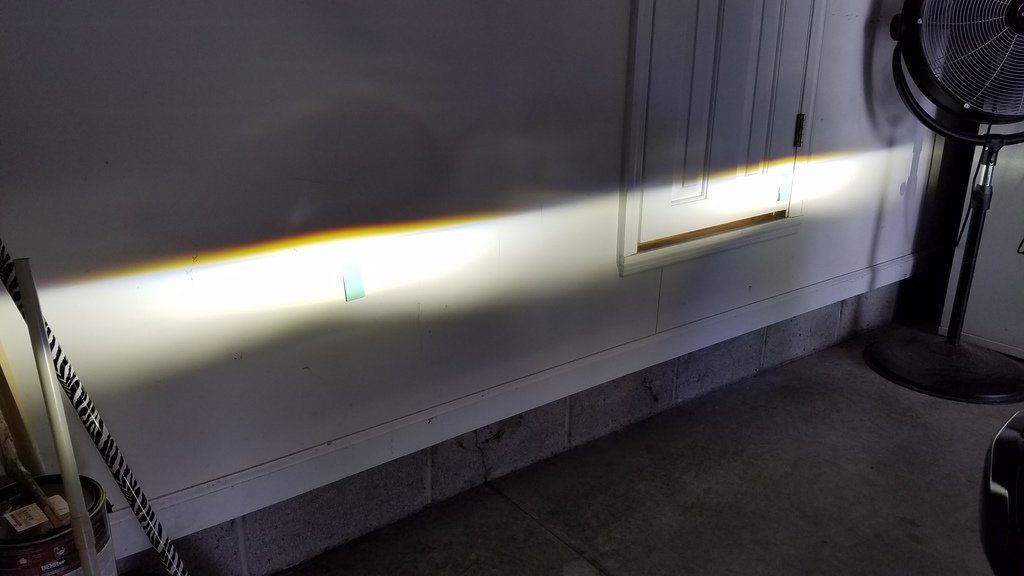

    First off, thanks to the OP for finding this solution. As I stated above, this worked well for me and I'm happy with the results.
    This post is pic heavy. Just FYI...

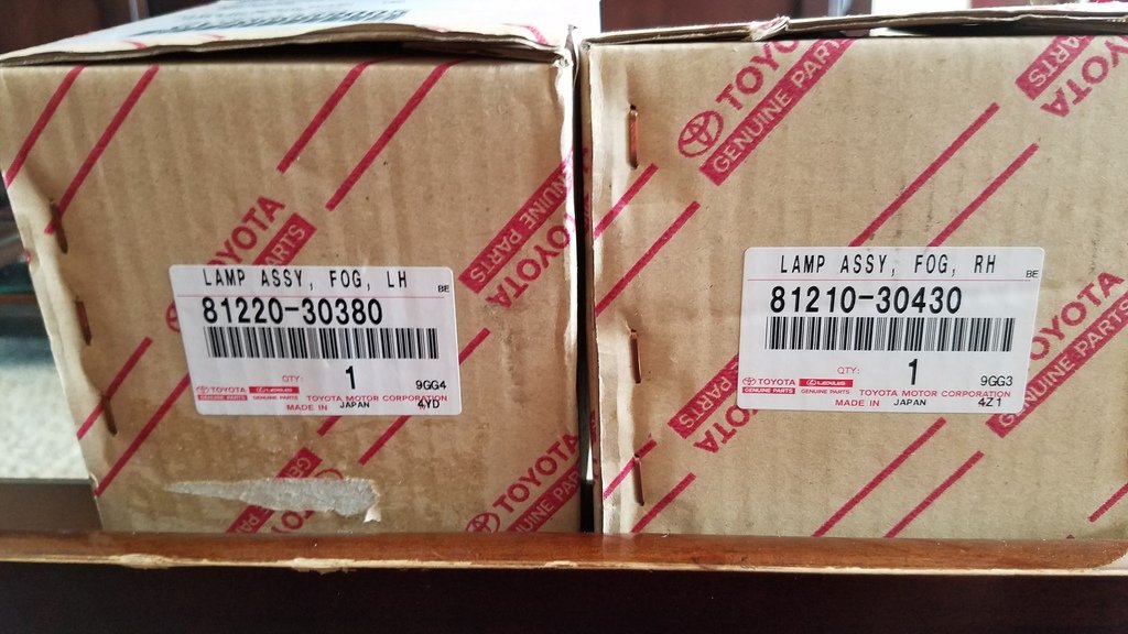

    I know the part numbers have already been posted, but just in case.

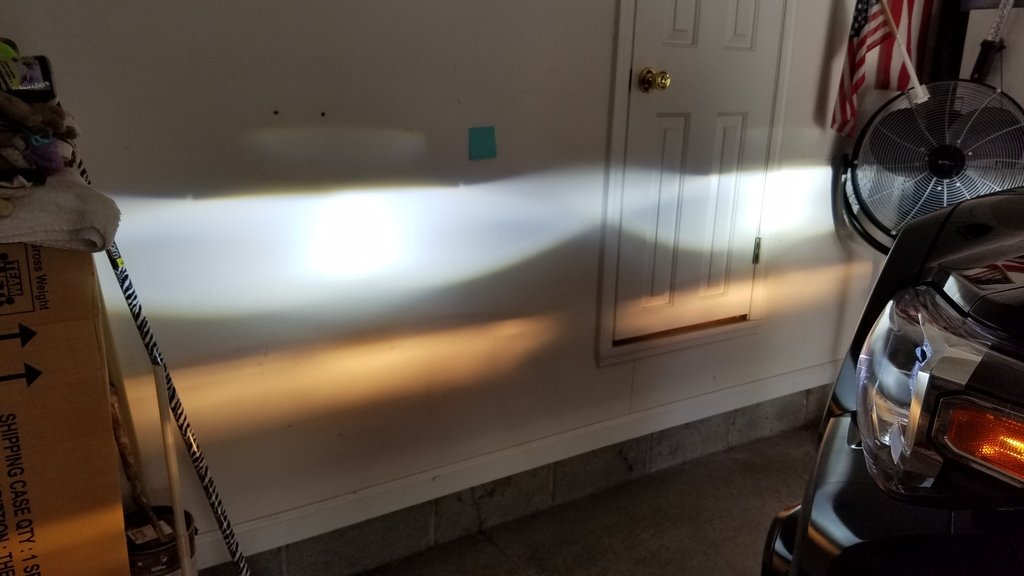

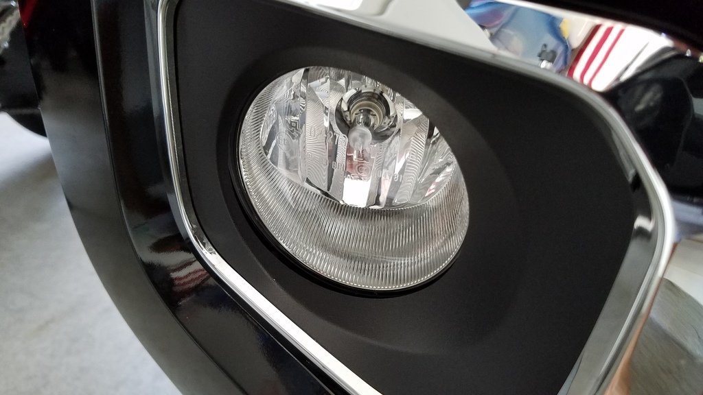

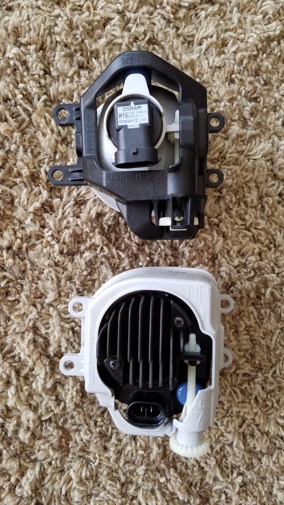

    Now for the physical size comparison. OEM on top, Lexus on bottom. Notice the heat sink and different angle for the plug.

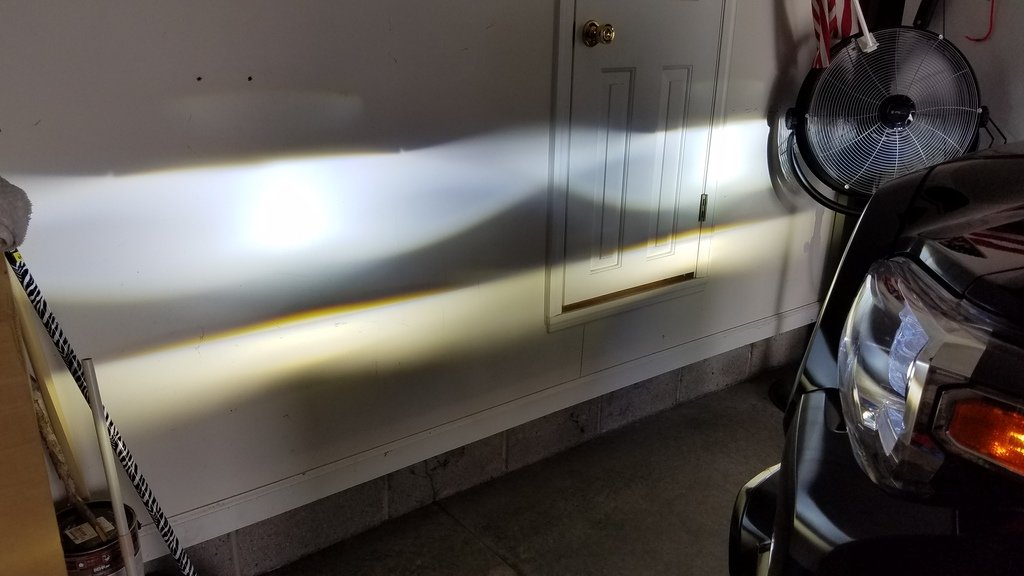

    OPT7 LED low beams on top, OEM H16 (Limited, SR5) halogens on bottom.
    OPT7 low beams on top, OEM H16 halogen on right, new Lexus LED on left.
    OPT7 low beams on top, both new Lexus LED's on bottom.

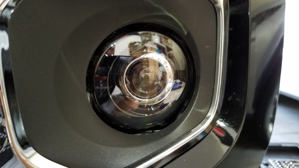

    Just the new Lexus LED's. Notice how in this picture with just the fogs, the color temp looks whiter than the pic above. I think this is a camera problem. In person, the lights look very similar in color with only a slight color difference...but a difference none the less.

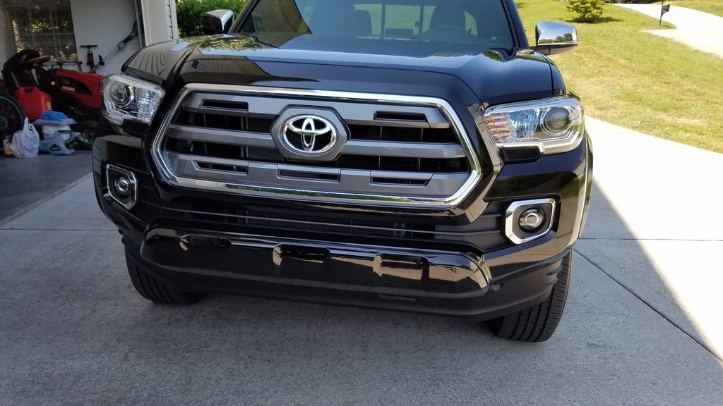

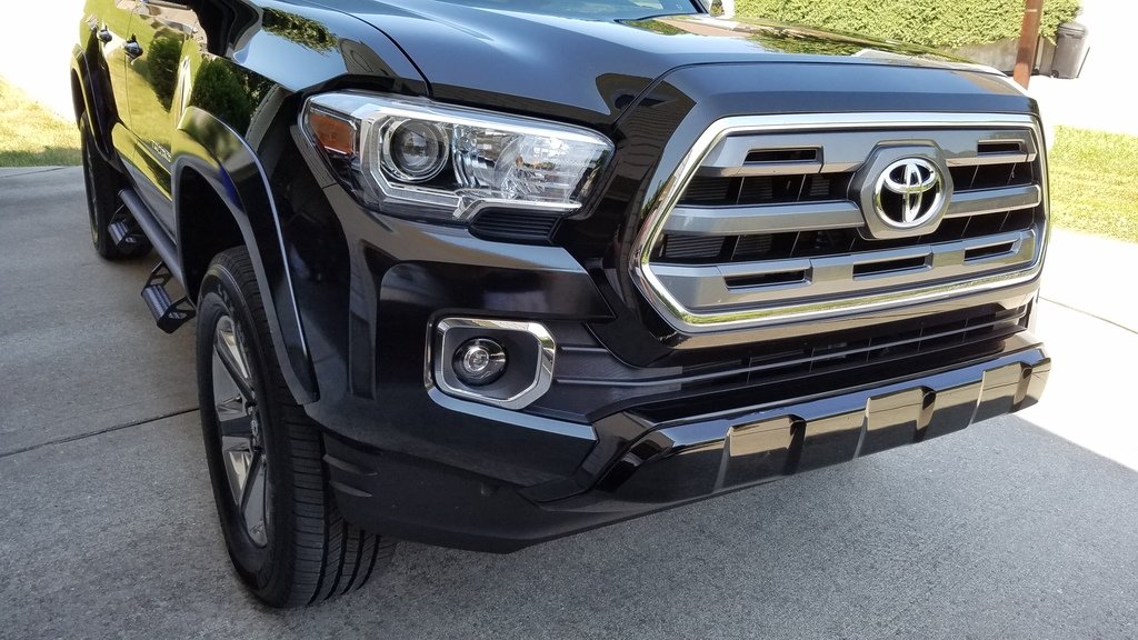

    Before
    After
    Other pics
    There you have it. Like I said, they look good...whether turned on or off. Check out the OP's pics of them for night shots. If you need more, I can go out and take a few later.
