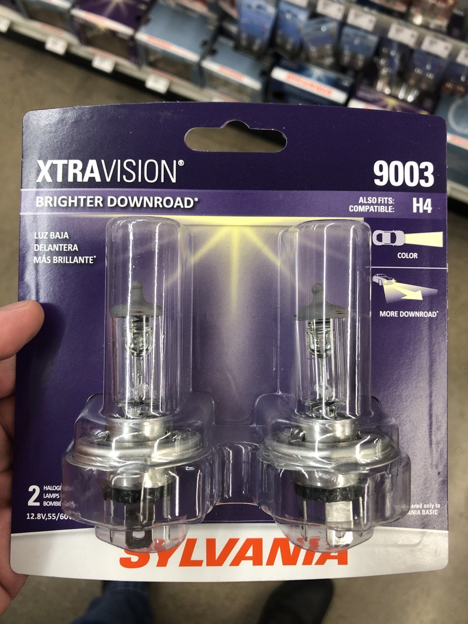

    I just replaced my stock headlights (one went out) with these. Comparing the two, the metal around them is stamped the exact same, Osram and everything.
