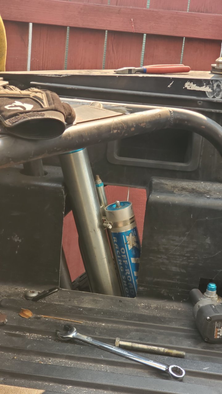

    Is a straight angle better for shock position? Or should I leave it as it sits?

    That is probably good. Big thing is you don’t want the shock to swing past vertical during cycling as that will cause it to bind. That looks about the same angle as how mine are set

    10*ish at full bump is what I’ve been told

    Did 14.5° :notsure:

    Not too shabby at all
