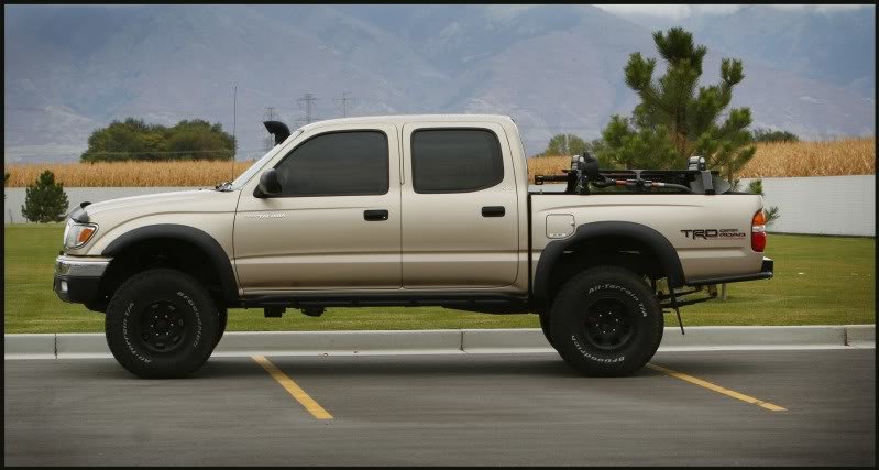

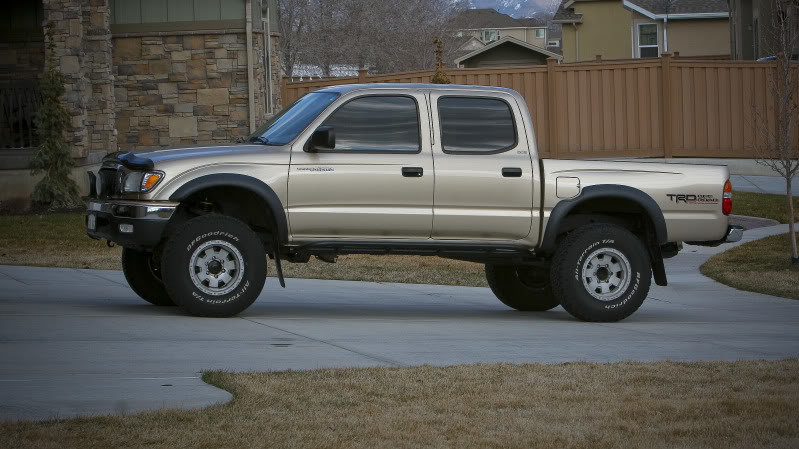

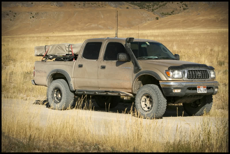

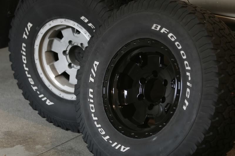

    Here's my wheels I rattlecanned on my Tacoma.
    before and after together:
    before:
    After:
    and yes it gets wheeled and the paint is holding up great.
    Here's another set I painted for my Evo. Rustoleum rattle can.
    Nothing wrong with rattle can if you do it right.

    box rocket the wheels look niiice. did u use gloss black??

    Yes Gloss Black and Gloss Clear
